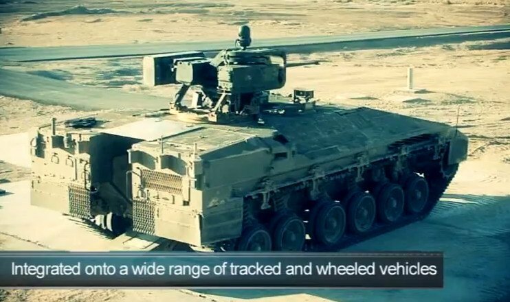

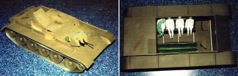

I guess you use what you've got but I'd love to see how "9-10 troops" are squeezed into this 'APC conversion'!
According to the caption on another view of this vehicle, it is also intended to act as an "armoured recce vehicle, infantry assault vehicle, etc." Assuming that the last refers to a fire-support role, I find this much more realistic than the 'APC' option.

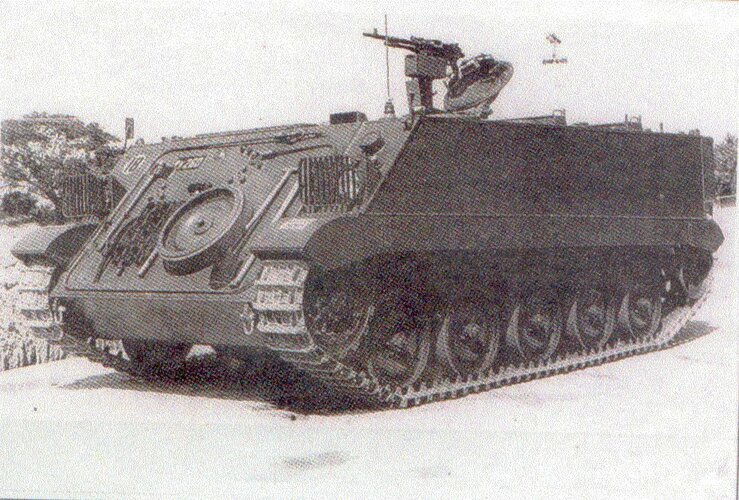

AMX-VCI (Véhicule de Combat d'Infanterie): A variant of the AMX-13 light tank that has seen the world over. Still in service with nine countries. Picture shows an Indonesian Army AMX-VCI.

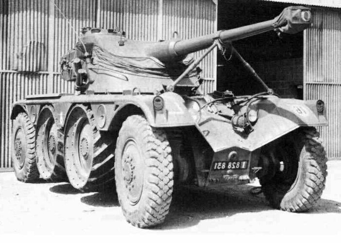

Lastly, while technically not a "tank" by most standards, I like to give a special mention to the Panhard EBR ETT (Engin Transport de Troupes). A unique APC version to the EBR family that only Portugal used. Unknown if it saw any combat and only 28 examples were ever built.

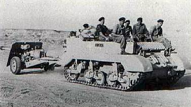

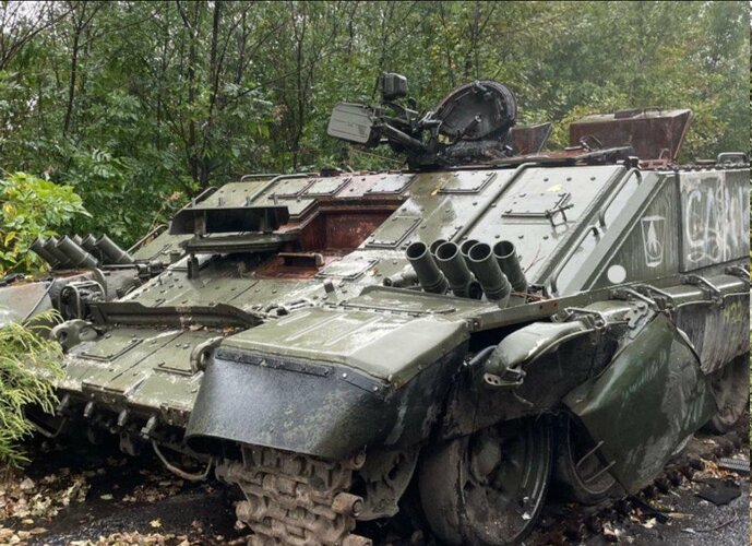

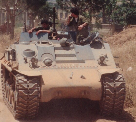

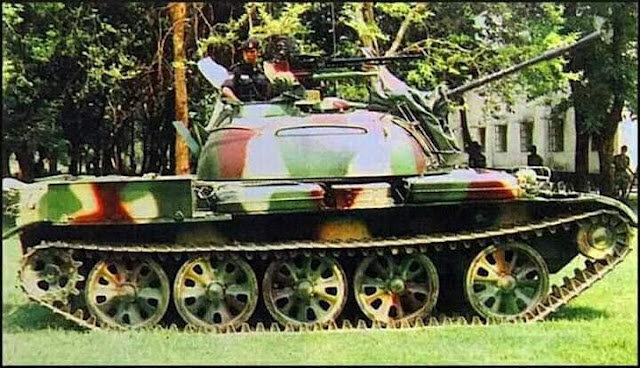

The South Lebanon Army of Major Haddad created some makeshift APCs out of T-54, -55 and even out of ex-IDF Shermans M50.

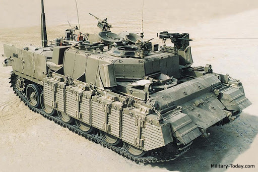

Those machines were very different from the IDF's Achzarit or Ambutanks:
(pics removed from quote)
As I recall from 1991, "turretless Shermans" were often reported when SLA was rotating personnel at their positions along the "Israeli Controlled Area" in the south of Lebanon. My usual job wasn't near those routes, so I'm not sure if I ever saw one myself.
We had to call SLA "De Facto Force", or DFF.

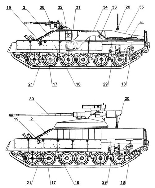

The Military Institute of Armored and Automotive Technology WITPiS in Sulejówek carried out conceptual work to build a vehicle called "Odyniec" (meaning Boar) based on the T-55 tanks withdrawn from the Polish Army. It was supposed to be a Heavy Armored Transporter, capable of carrying ten soldiers (including eight landing soldiers). "Odyniec" (Boar) was to be armed with a 12.7 mm machine gun, a 40 mm automatic grenade launcher and a 9M14 Malyutka ATGM launcher.

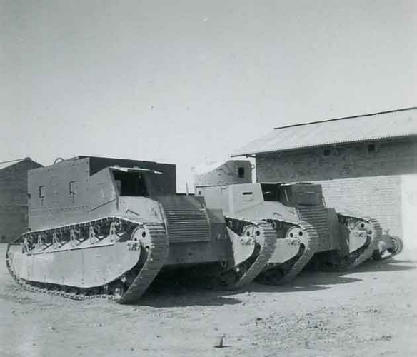

Now for probably the most obscure APC on a tracked chassis ever...

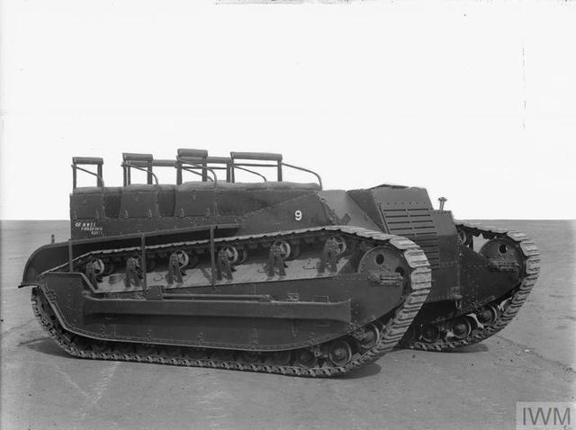

The RAF converted two Cardin Loyd artillery tractors into tanks using bits from their Rolls Royce armored cars. These were prototypes to be tested for airfield defense. One got converted into an APC as you can see above.
That's the base vehicle they used.
Anyway, the tank and APC were sent to Iraq for testing (I assume to be out of sight of the Army who likely would have been angry the RAF was trying to get tanks on top of their getting airplanes).
These sat forgotten until WW 2 when Iraq revolted and they were drug out to serve as stationary pillboxes at an RAF airfield there. They were dubbed HMS Walrus and Seal (No, I don't know which was which).
So, the RAF had a prototype tracked APC pre-WW 2 in HMS Walrus or HMS Seal...

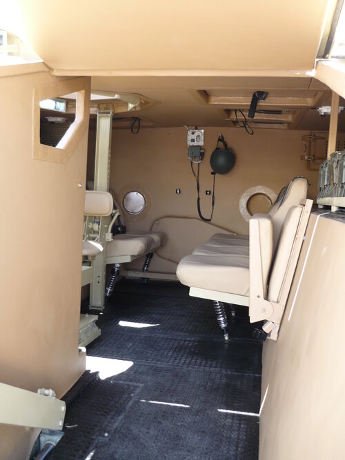

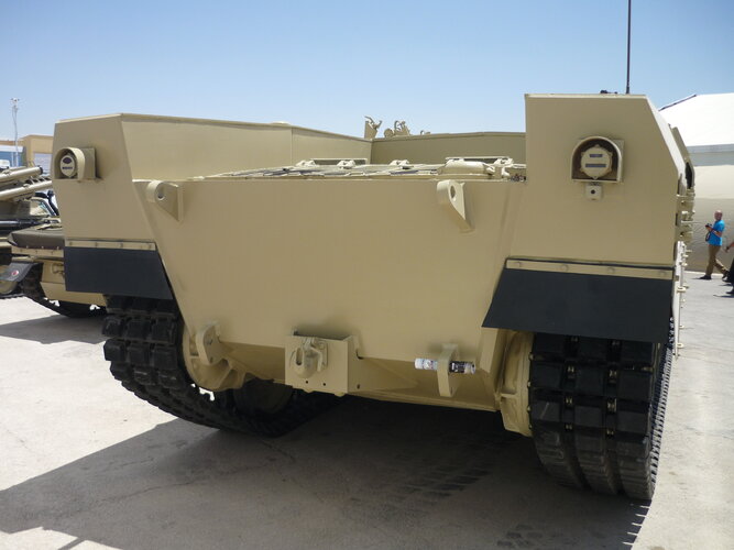

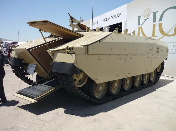

Now, I'm no military engineer but wouldn't have a troop door in the front cause massive number of causalities?
Likely intended for situations where they have to breach buildings in MOUT scenarios and the like.
Same as the Israeli T55 based carrier. You pull up to a building, blast a hole and the troops de-bus, into the building.

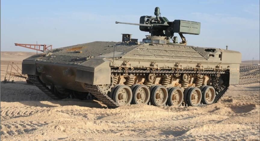

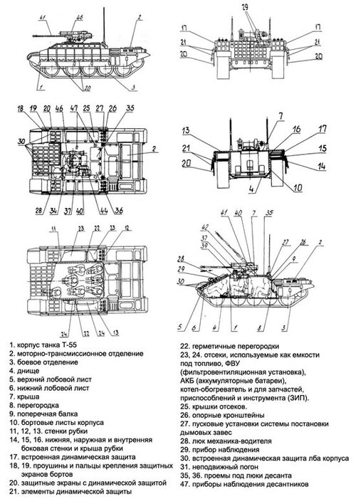

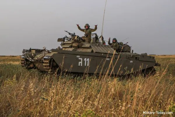

The Israeli Achzarit heavy APCs based on the T-55 have rear doors.
There are reports of a small number of Centurion-based Nagmachon variants (maybe called Nagmapuma or Pilo) that have a front door.

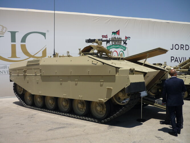

It's neither. It's not intended for serious production, much like the Falcon turret. Jordan is just showing off it has a "military industry" and seeking investments from outsiders, essentially. Morally, it's better than funneling the money into the royal family's stable of supercars, but practically I don't think there's much greater value for the money.
The door on the front is just because the Jordanians didn't want to do the hard thing and try to fit a transverse engine or accept a smaller engine. The Israelis made a functional APC for combat use, though, which necessitated replacing the engine and adding a troop...crawlspace? so that the men can exit. Conversely, this Jordanian thing is basically a body kit for an existing tank hull with a fresh coat of paint. Note that it still has the AVDS-1790 and Allison transmission of the M60A1 RISE, typical of the Tariq, rather than a newer engine like the Achzarit.
I suspect the Dawsar's relative success (four vehicles vice one) is because it's simply much less effort to make a Centurion into a front door APC than it is to do the hard thing and make a front engine APC with a more proper rear door as the Temsah was. Perhaps it only takes a quarter of the man-hours of labor to turn a Tariq into a Dawsar vice a Tariq into a Temsah?

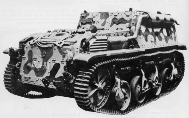

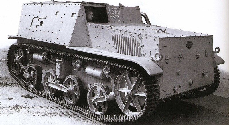

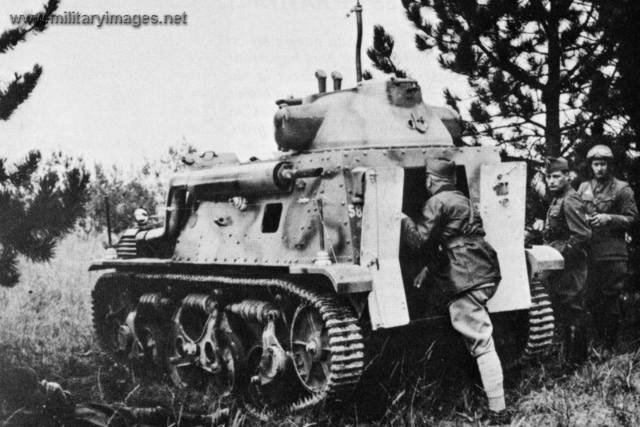

Renault YS
Renault YS4. Light armored personnel carrier. It was originally intended to equip sapper units of tank divisions. Accommodated the driver, commander and six paratroopers in the "wheelhouse". In the troop compartment with a smooth floor, there was enough space to place two machine guns, ammunition and ammunition. The troops left the DO through large double doors in the back of the hull. The speed of the car was 50 km / h, the cruising range was 220 km.
UH76-3NMRi0a9e0dafIqG146E3p86nwp0mVjJcyX78Jho-csK7ItrCSqbpaABdMFu1lZIMzokslDzP8ba7uaOJp5mkeeOG...png
UH76-3NMRi0a9e0dafIqG146E3p86nwp0mVjJcyX78IYETCqpBx2oBceAGN5vq6vi0hLzYRs5IpLG3DKzvUwhWdGdIsPIg...jpg
Thanks for the rare pics of this arcane subject.
AFAIK, the Renault YS 4 was for the "programme type M : voiture de commandement et de liaison blindés", ie command and liaison with armored units.
And by the way, I believe the vehicle with a turret in third picture is not a YS-4 but YS-2, for the programme type L : voiture de reconnaissance, ie recce.
So was the YS2 built on the chassis of the AMR 33? And the YS4, the AMR 35, with some elements from the R 35?
How many of each were built? Were the production lines still up as of May 1940?
Were these both for the Cavalry, i.e. mostly for the DLMs and DLCs?
Solid information is scarce. To the best of my knowledge:
The YS were based on the AMR 35 chassis.
They were intended for Infantry, Cavalry and Artillery, as entries into the 1931 Army-wide "program for all-terrain vehicles" which spec'd 10 different types named K to T.
YS-1 was for type K: voiture blindée de transport de combattants (APC), YS-2 for type L: voiture de reco (recce), YS-4 for type M: voiture de commandement et de liaison blindés.
Renault also tendered 6x6 vehicles URK and URL for K and L, one each prototyped with wood representing armor. URM and URT planned, not built. Also 2 protos of YS-4 and 1 of YS-2 were built.
Not many orders came out of the program : AFAIK only the UE and UE2 were mass produced (~4,900).
[edit: not many orders before the defeat of June '40. As Prof12's post shows, under the Vichy régime orders came as of fall 1941]
But we are drifting off-topic: none of those were tanks converted to APC.

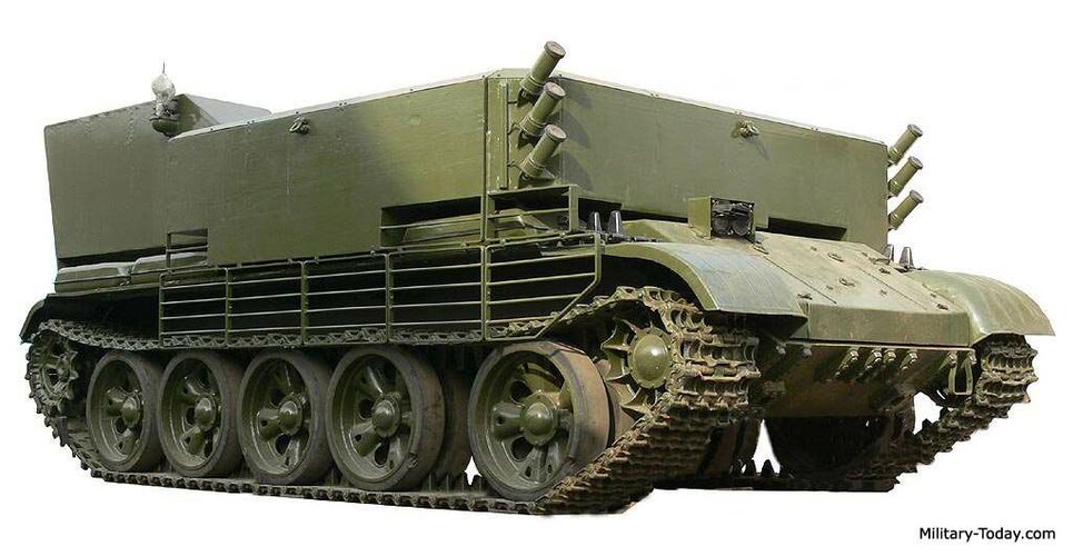

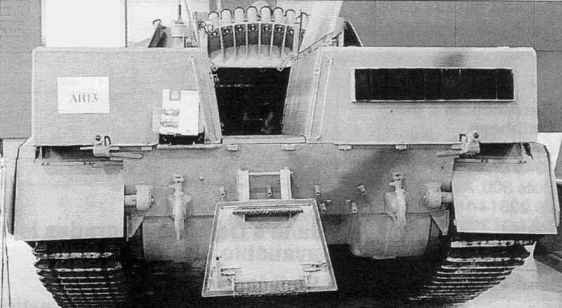

AB-13 infantry fighting vehicle - the first heavy infantry fighting vehicle
he engine compartment is located in the aft. Between this compartment and the tower is the troop compartment. For firing small arms, several embrasures are provided on the sides of the hull, which are combined with periscopes. In order to ensure a more or less trouble-free landing, the Ukrainian designers decided to make a continuous passage over the engine compartment, ending with aft hatches. The low height of the MTO is ensured by the installation of a Ukrainian turbocharged diesel engine 6TD or 5TDF, in which the cylinders are located horizontally

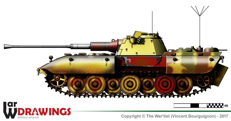

E-90 Bison Schützenpanzerwagen
APC variant with engine compartment moved in front in order to provide a rear compartment for the troop with an access door on the hull rear plate. This compartment had a small machine gun turret. This arrangement did not make it possible to retain the bulky turret of the standard E-90. It was replaced here by a Schmallturm (developed for the Panther Ausf.F) armed with a 55mm MK automatic gun.
Is however a hoax (as the E-90) designed for the Japanese simulation game "Panzer Front" of 1999, and not a true paper project, one day conceived by a German engineer during WW2.

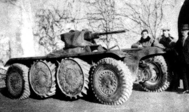

The EBR family of 8x8 wheeled vehicles was directly descended from the 1939-40 Panhard 201 8x8 wheeled light tank, which got only as far as the field-test-prototype stage before the 1940 hostilities began. The family resemblance is apparent:
EBR 75:
Panhard 201:
Panhard is said to have planned a next version of the 201 with sufficient scaling-up of the turret to mount a 47mm gun, thereby making the 201 as capable of anti-tank fire as the best 1940 French tanks, and therefore de facto a wheeled light tank for the Cavalry branch; and a corresponding scaling-up of the hull, to fit that larger turret.
Panhard also is said to have planned a Cavalry personnel carrier version of the successor-to-201 vehicle...the same concept that after the war became the EBR ETT.
