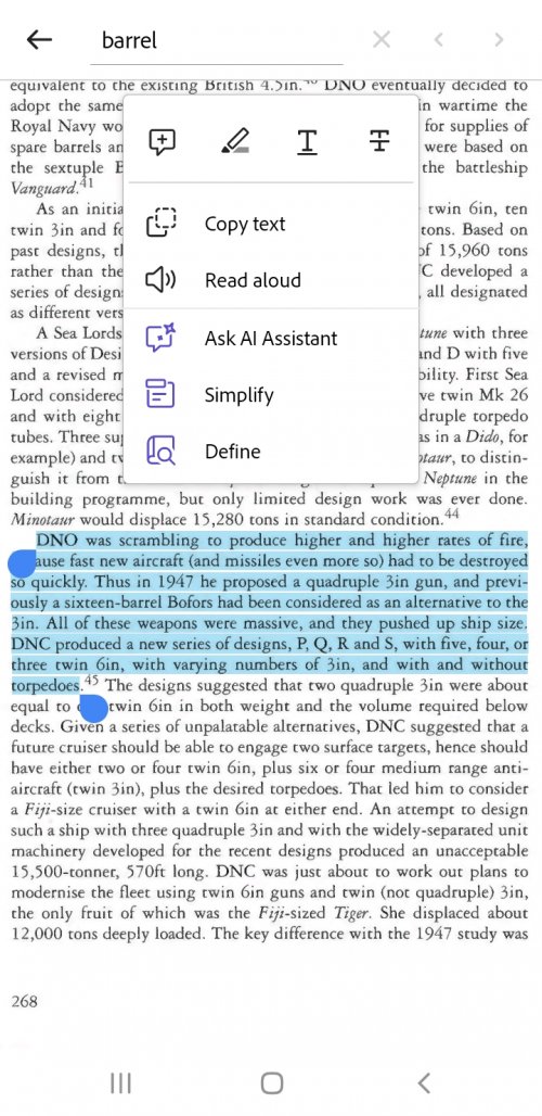

The part from Friedman's book about the 16-barrel Bofors mounting:If you ever come to see or read about a very large Bofors mount of 16 barrels, that would be awesome!
In Friedman's "British Cruisers: Two World Wars and After" he mentions that DNO proposed in 1947 a quadruple 3in gun, and previously a sixteen-barrel (sexdecuple) Bofors for high rates of fire against modern aircraft and missiles.
