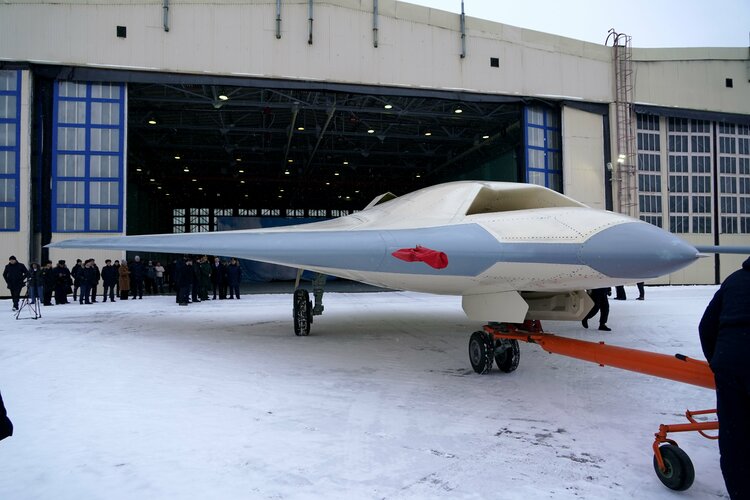

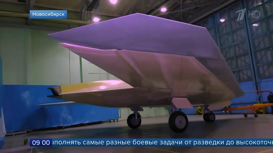

Are they put new small intake on the upper fuselage? Or its just some open panel? Never see that on first prototype.
They don't?
Doesn't mean they can't learn though.
Relative to whom? The US? Sure, but then that's a bit of a deliberately impossible standard to hold them to, even China doesn't match that benchmark.
Also - and I think that is the main point here - is this particular instance (LO nozzle, OML clean-up on S-70) really a case of learning? Our very first glimpse of Okhotnik was a full-scale mock-up which displayed both these features. Yet when the first flying prototype came covered in warts and had an axisymmetric nozzle, Western observers immediately jumped to the frankly ludicrous conclusion that this was representative of the intended production config.
All indications were, even at the time, that this was merely a X-47B-style demonstrator to test aspects of the design unrelated to low observability, and that the final airframe would correct all these "flaws". I think a "told you so" is perfectly warranted, given the sheer ridiculousness of the leap of logic that it was (and how pervasive the misconception was - there was nary a sane take to be found anywhere!).

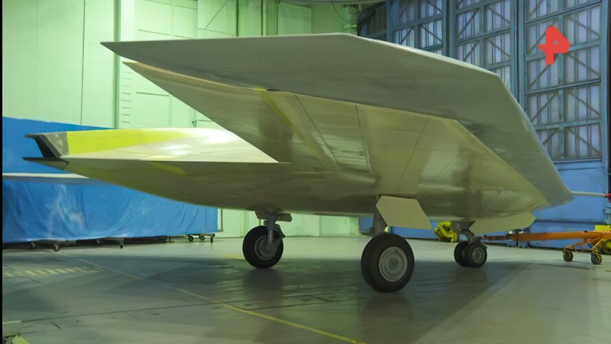

In addition to the other changes mentioned (flat nozzle, LO air scoops), it now has the bespoke landing gear design, which was hinted earlier by some sources.
high-res photos
(c)UAC
and a bonus: AI-enhanced photo of nozzle

Too bad it's gonna take a while before we see it in its final finish.
It seems they've "LO'd" most of it the way I expected them to do eventually, jet nozzle, all the intakes and vents everywhere etc. Only the big pitot tubes remain, but it's still a testbed so that's not too strange.

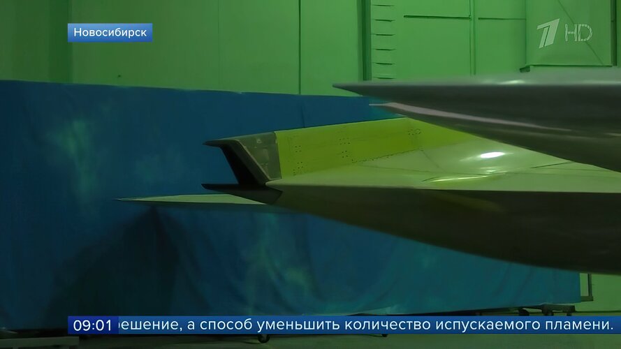

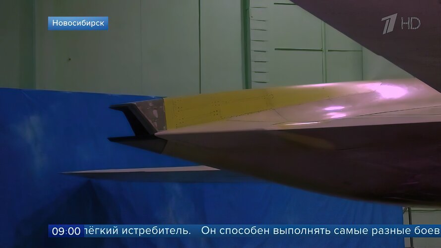

Notice that the elevon's gap with the main wing structure is sealed with something like a flexible cover.
Indeed, good catch.
This is one major source of backscatter, so its elimination may mean a not so trivial reduction in RCS and a serious advance in LO technology. Well seen!

Well, here's a design that makes precisely no sense at all.
Interesting, very much interesting, however I'm surprised - indeed disappointed - about these numerous lumps and bumps, scoops and intakes around the fuselage. ???
Not to mention the exposed, round, engine nozzle. Stealth was clearly not a serious consideration here.
And don't even get started on the IR issues of making no attempt to conceal hot metal or to attenuate exhaust.
This is a bad joke of a design if they are even slightly concerned about signature management.
Had this been a prototype released in US/China, people here, people would have rationally thought out that maybe this wasn't the final version but a flight prototype, instead of pointlessly smearing Sukhoi's work.
But it's pretty much to be expected by now, first comes the reveal, followed by the usual stupid Drive/National Interest articles and drive-by picture analysis of prototypes, then as the project continues on with following improvements it switches to "no money, no serial production, etc" and so on and so forth, then the project reaches serial production and all the previous claims fade away into the memory hole and no one ever has to actually own up to their mistaken thinking and the amount of shit smearing they did.
We had the full cycle of above with the Su-57, we're now in the middle stage with the S-70, and currently in the first for the Su-75. And of course, this extends to other aviation projects as well as Army/Navy stuff as well.
All due respect, but that's utter bullshit.
Alternative facts - also posts from page 1. Note after some initial varied reactions, a broad consensus in favour of "it's just a prototype".
It's not representing final configuration neither intended for RCS tests. Just like X-47B which had her own collection of bumps.
The lumps and bumps are expected on a first prototype. I would imagine the use of an off-the-shelf Izdeliye 117 engine is expediency - they have lots of control, guidance and other issues to work through before RCS becomes important. Maybe its waiting on a new nozzle to comes with Izdeliye 30...
This is a fair point, and mine was a bit of a knee-jerk reaction. It still looks like a remarkably rough draft design, but perhps it will eveolve into something more refined.
I know that this is a testbed or test-specimen only and I also did not want to offend anyone ...
With all due respect, the bad joke here is the assumption that this is what the final product will look like. Where does that come from?
It seems *decidedly* more likely to me that this is but the first of several prototypes, and intended to test aspects (FCS? Autonomy? Structures? Inlet performance?) for which full LO would be a needless waste of money. Flateric has already mentioned the X-47B as such an example, which was aerodynamically representative but also paid little heed to RCS reduction in detail because its job was merely to demonstrate aerial refueling and carrier ops. Apart from its "antenna farm", the nozzle was actually decidedly improvised too - sure, it was non-axisymmetric but the exhaust deck edges were exposed and *anything* but stealthy:
Last but definitely not least, the leaked slide which gave us the first public glimpse of Okhotnik showed a configuration (with hindsight probably a full-scale mock-up or RCS test model) that had a perfectly stealthy rear end:
As do the silhouettes painted on Su-57 #053. So to believe that the engine nozzle will stay this way flies in the face of both logic and multiple clues.
Indeed, good catch.
Boeing's Bird of Prey demonstrator had it decades ago. And at the time it was said that some features it had become industry standards. I'm assuming most unacknowledged programs to this day use the concept.

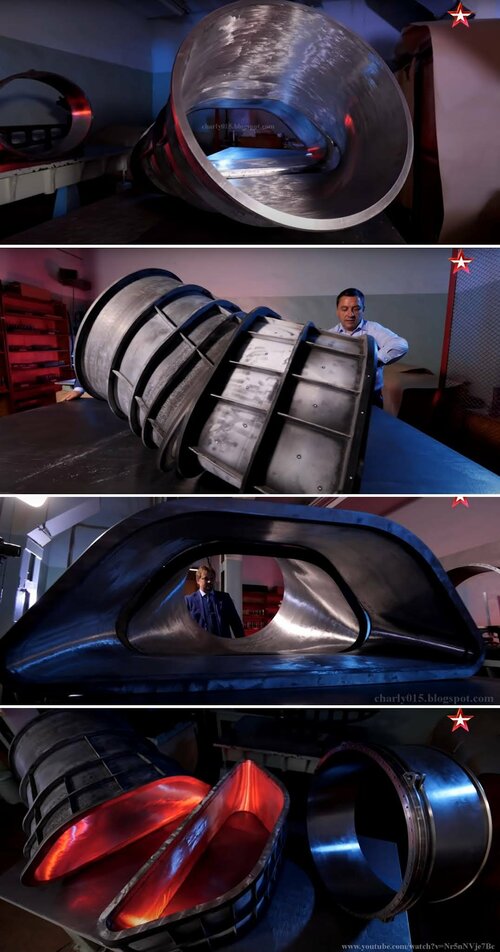

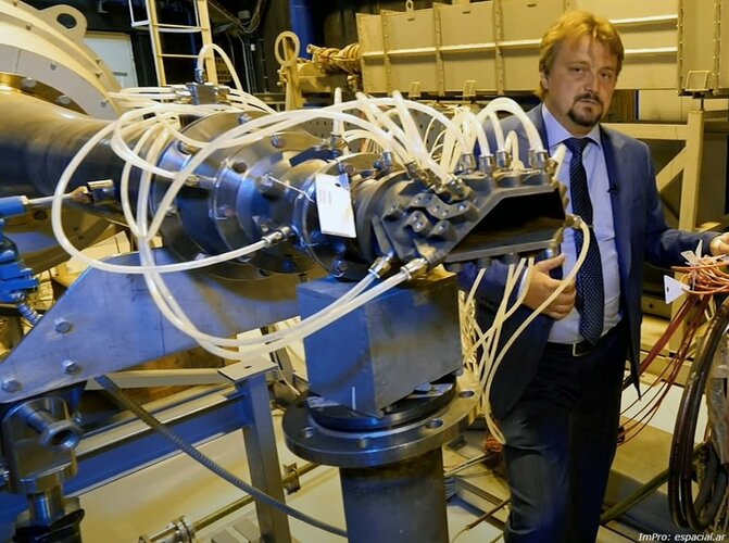

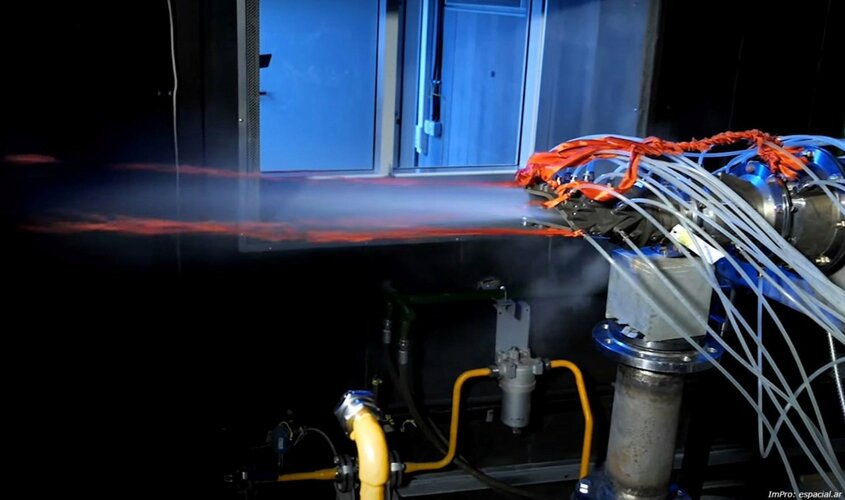

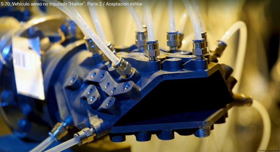

It looks incredible. The flat nozzle is of a unique kind and some images I saw on russiadefenseforum (see below) seem to point to a similar injectors for lowering infrared, though of different kind izdeliye 30. The only seams I can spot on the aircraft are where the wings meet the central structure and they are bit big but I think they will have materials blended over them as it develops more and is further coated with radar absorbing paints.
These are pressure tubes measuring pressure parameters at various nozzle sections during model tests iydk.

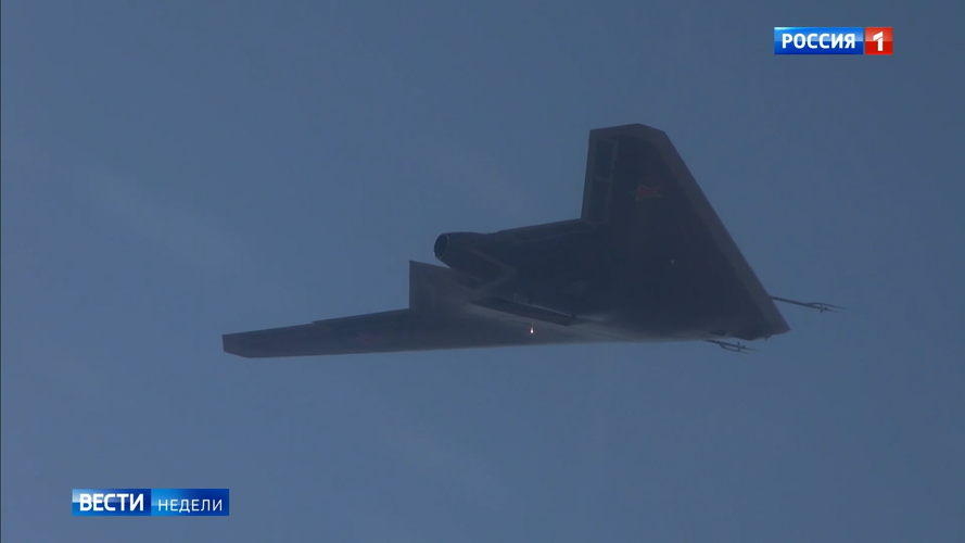

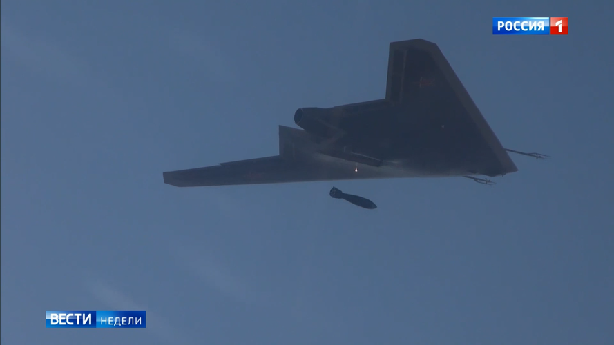

Kind of odd that it's the M62 low-drag variant that was specifically designed for external carriage, and not the stubbier M54 variants that were made for internal carriage, and way more volume-effective. Any reason for that?
Edit: I just realized that the smallest remaining Russian tactical nukes follow the M62 FAB-250/500 shape (ie the RN-28/RN-32).
Very interesting footage, but i don't see the weapon-bay door... For me it looks like in this particular test there was no door at all. :oops:

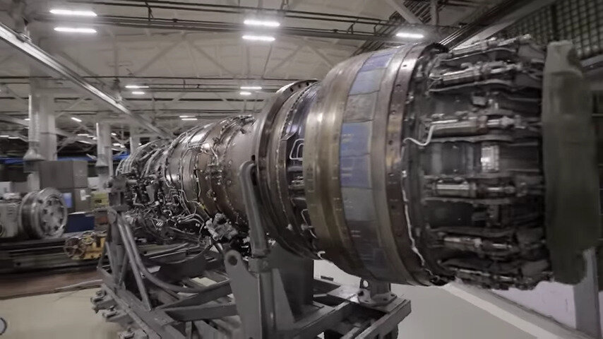

and immediately 1 interesting image appear. The engine. Looks shorter than 117, and lacks the gimballed TVC "ring".
Also weapon bays.
