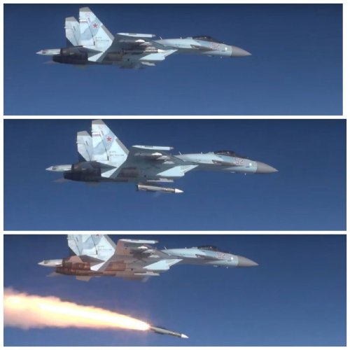

It will be nice to see Chinese and Algerian ( of course Iranian) Su-35's with heavy very long-range hypersonic R-37ME (Product 620) ,especially in terms that this AAM proved itself very well.That will significantly enhanced combat potential of the Su-35's with its PESA N035E Irbis-E.
Squirrel, do you have any info about Su-35M?
Isn't it supposed to be Su-35SM?
Yes,Su-35SM. I've first heard for the Su-35SM in 2020. During that test launch of the R-37M , some Russian sources mentioned that two Su-35S were modernised to 'SM' level ( Bort number 51 and 52 red in fact ).
''Модернизированный истребитель Су-35СМ борт 52 на испытаниях в 929-м ГЛИЦ''
Also after the first Su-35S was shot down ( April 3rd 2022, in the vicinity of Izyum) ,some sources wrote that KnAAZ will modernize Su-35S to SM level but all we could see as something new are wingtip ELINT/ECM stations. I think that besides all of that, all new Su-35S are only Su-35S ,not SM as official VKS designation.

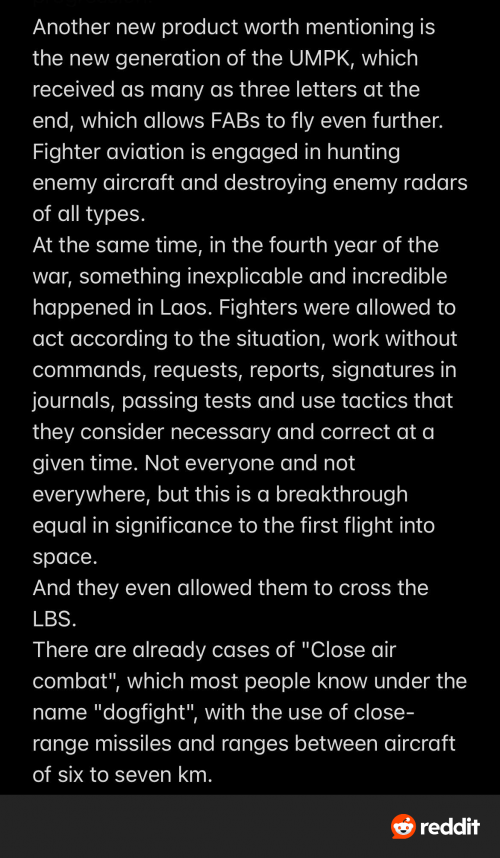

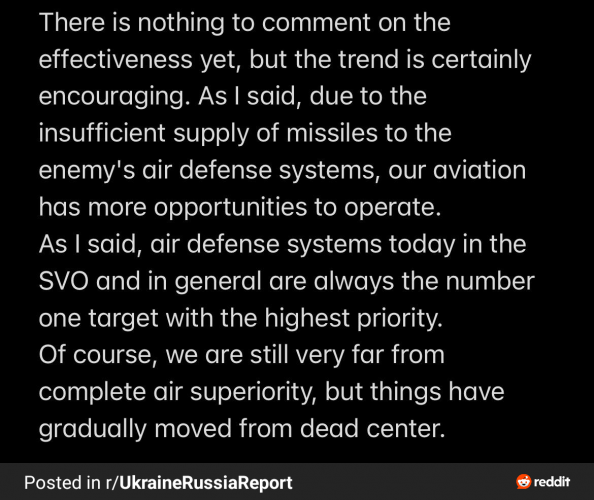

Fighter_bomber talks of increased dogfights.
Probably over Sumy.
Can someone make it easier to understand?
Can't they just lob R-37M with BVR from Su-35s?
Are they close enough now to switch to R-77s?
Russians have tried using S-400 missiles (which according to Russian milbloggers were illuminated by 35s) and long range AA missiles and were playing it safe until now.

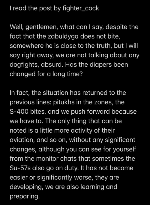

Dogfights? Hm.....
One thing is certain.For almost three and a half years of Rus-Ukr war ,we could not see Su-35S 's pilots wearing HMS ( Ukrainian Sura-M or Russian T-04).

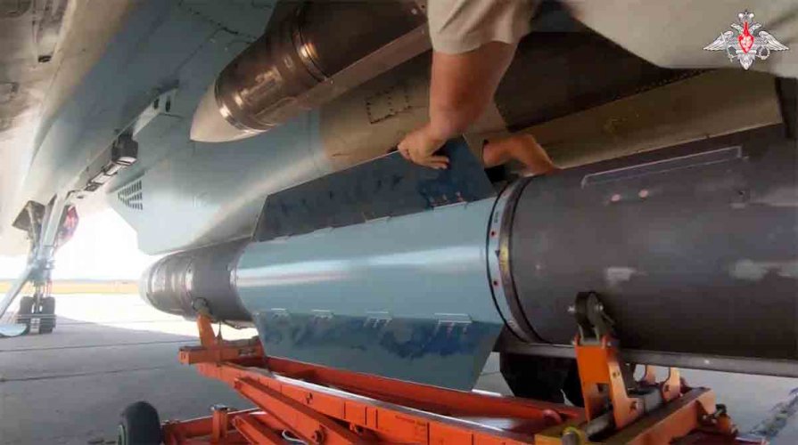

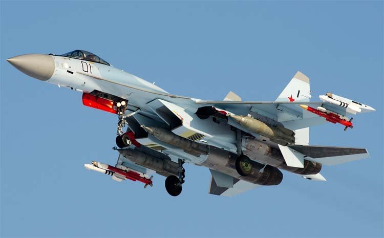

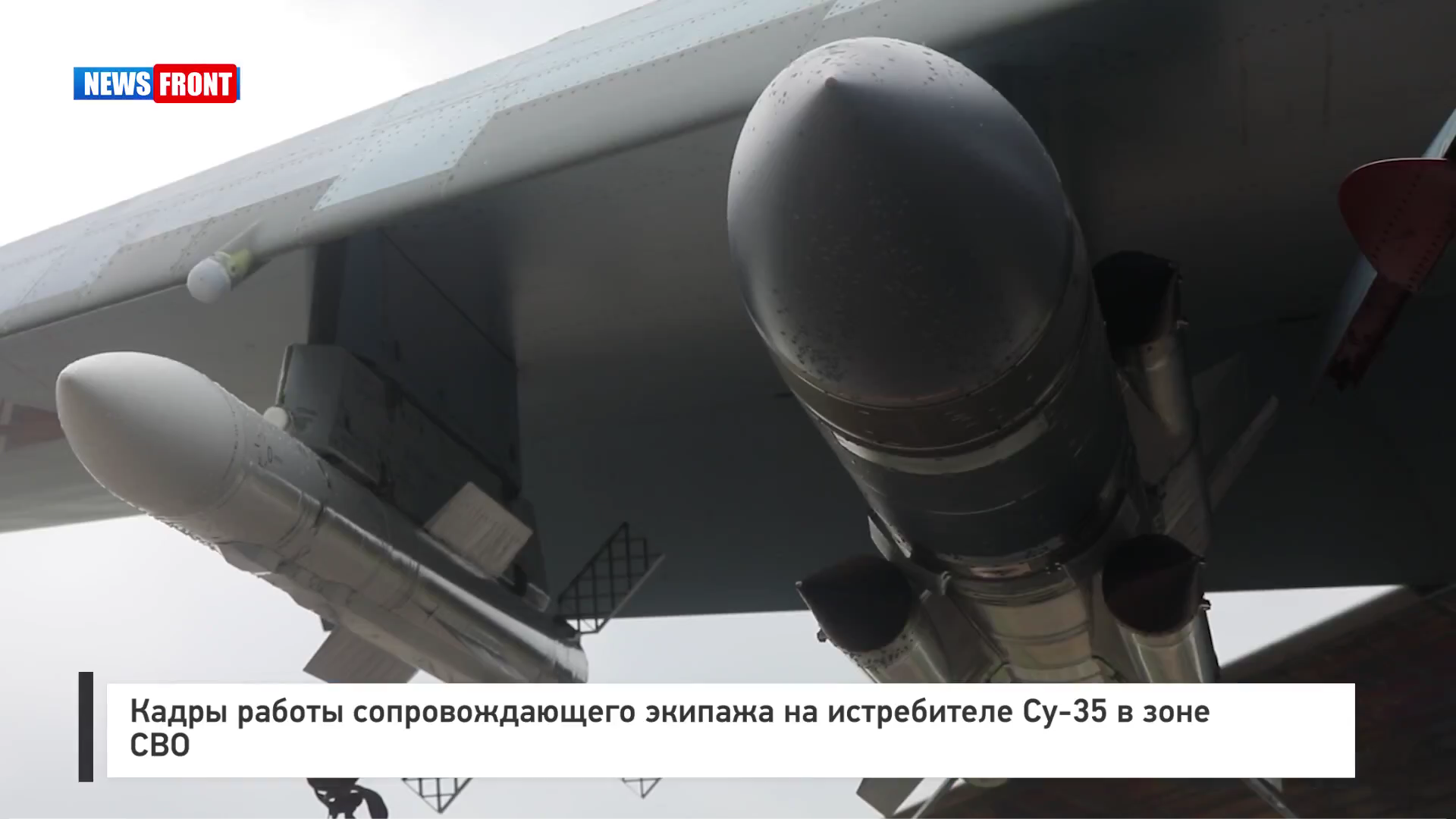

Su-35S armed with the R-37M .
Video Details Preparation of SU-35 Fighter with Hypersonic Missiles​
This kind/type of the heavy very long range hypersonic AAM is what IAF fighters like Su-30MKI ( Super-30) needs right now ( like Su-30SM2). With AAM's like R-77-1EL and the older R-27ER1 , they can ahieve max launch distances against incoming air targets in the range of only 100-150km, no more than that.

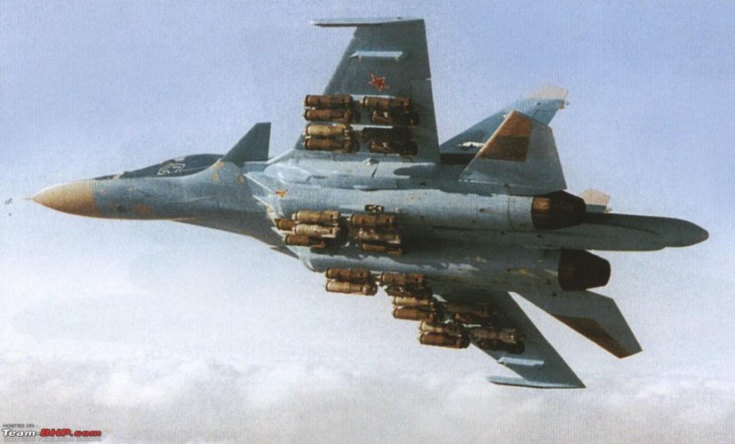

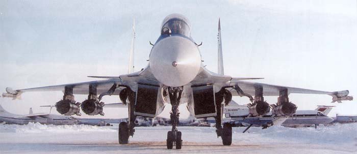

How many bombs can Su 34 carry? A lot!​
Prototype T-10V-7 '47 white' with 35 bombs type OFAB-250-270 ( weight 266kg).Weight of each multiple bomb rack is 150kg.
View: https://www.reddit.com/r/MilitaryPorn/comments/40xv77/how_many_bombs_can_su_34_carry_a_lot_1373_831/
Why 35 when there was a place for one more bomb under multiple bomb racks? Was that a max limit ? There was a place for one more multiple bomb rack between engine nacelles.
