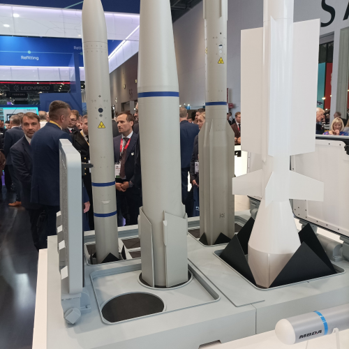

Shouldn't that be two 14.8" missiles? (Sqrt(21^2+21^2)/2 = Sqrt(882)/2 = 14.85)From a geometric consideration, in a 21-inch square, you can fit
That doesn't fully take allowance of separation, wall thickness, etc.,
- One 21-inch missile
- Two 12.3-inch missiles, or
- Four 10.5-inch missiles
No because the missile, being rounded, can't go all of the way to the corner and so they are pushed towards the centre, limiting size further. Each small missile is 2 - sqrt2 times the diameter of the square, so 12.3in for a 21in square.Shouldn't that be two 14.8" missiles? (Sqrt(21^2+21^2)/2 = Sqrt(882)/2 = 14.85)
That doesn't quite fit if you draw it out. You need to find the diameter of the incircle of a triangle with two 21-inch sides and one 21√2-inch side – which comes out to about 12.3 inchesShouldn't that be two 14.8" missiles? (Sqrt(21^2+21^2)/2 = Sqrt(882)/2 = 14.85)
You'll get slightly different numbers depending on precisely which measurement is being compared. I've used missile diameter as that's readily available. Canister size will be larger, but then an allowance has to be made for wall thickness, clearance, etc.So it's likely between 13" to 16".
Yeah, I calculated the diagonal of the box the missile has to fit in, not the diameter of the missile, d'oh!That doesn't quite fit if you draw it out. You need to find the diameter of the incircle of a triangle with two 21-inch sides and one 21√2-inch side – which comes out to about 12.3 inches
They're definitely not oval and as Reuben explained they don't need to be.
Look at the other perspectives, taken with a true scale camera:
No.Is there any official price for a single CAMM or CAMM-ER?
Okay thanks mate

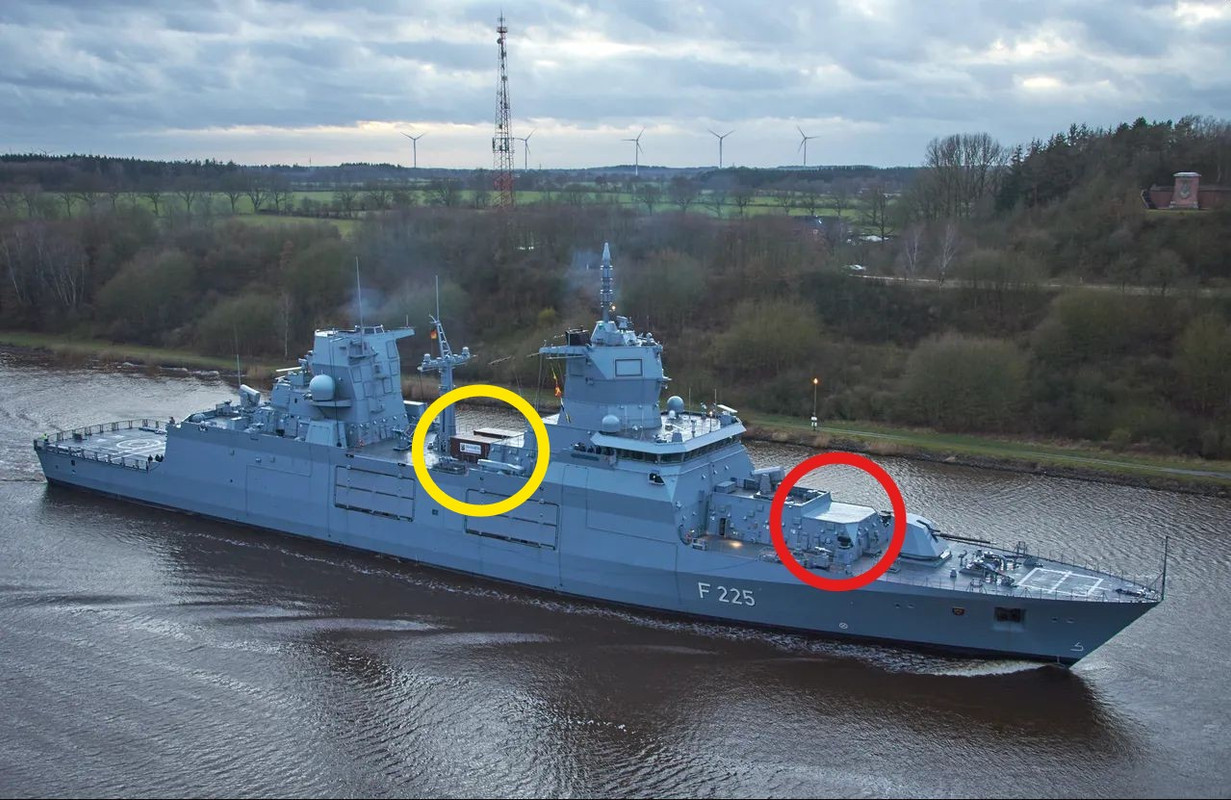

CAMM and the 6-cell MLS are being discussed as a potential upgrade for the German navy's F125 type frigates. One of those frigates recently carried out a firing exercise with a (normally land-based) IRIS-T SLM SAM launcher.
The MLS could be installed in the space which is currently used to house the ship's gym room (red circle):
Another alternative launcher system (according to MBDA) could be integrated into a 10 foot ISO container and placed between the ship's masts (yellow cicle). This is also the location where the IRIS-T SLM launcher was placed.
From what I remember the F125-class already has some weight-related issues, so CAMM might indeed be seriously considered there as the CAMM in the mushroom farm VLS is probably the lightest option available, and even when using the iLauncher it doesn't need an exhaust deflector. Though I think CAMM-ER would be a much better option as CAMM is closer in performance to the RAM Block II than to the IRIS-T SLM or the ESSM. However, as far as I know the other significant issue with trying to fit VLS into the F125-class is the lack of space below the deck. And if that's the case, the best option for a VLS is the Mk56 which needs just under 2 meters below the deck, and which enables hot launch, so could (and should tbh) be integrated with the IRIS-T SLM.Hartpunkt
Mk.56 doesn't seem to be an tought of solution. Right now the IRIS-T launcher is a proof of concept. While weight is a serious problem as far as i heard any speed or range reduction is seen as acceptable given that the ship can't really do anything without it. Same for the Work into the direction of ASW. Most reasonable choice probaly will be an USV with the Sonar how TKMS has already shown.From what I remember the F125-class already has some weight-related issues, so CAMM might indeed be seriously considered there as the CAMM in the mushroom farm VLS is probably the lightest option available, and even when using the iLauncher it doesn't need an exhaust deflector. Though I think CAMM-ER would be a much better option as CAMM is closer in performance to the RAM Block II than to the IRIS-T SLM or the ESSM. However, as far as I know the other significant issue with trying to fit VLS into the F125-class is the lack of space below the deck. And if that's the case, the best option for a VLS is the Mk56 which needs just under 2 meters below the deck, and which enables hot launch, so could (and should tbh) be integrated with the IRIS-T SLM.
So I think that the best choices for the F125-class are either CAMM-ER in the iLauncher or IRIS-T SLM in the Mk56. From the technical standpoint of course, so excluding IRIS-T's massive advantage of being a domestic solution.
