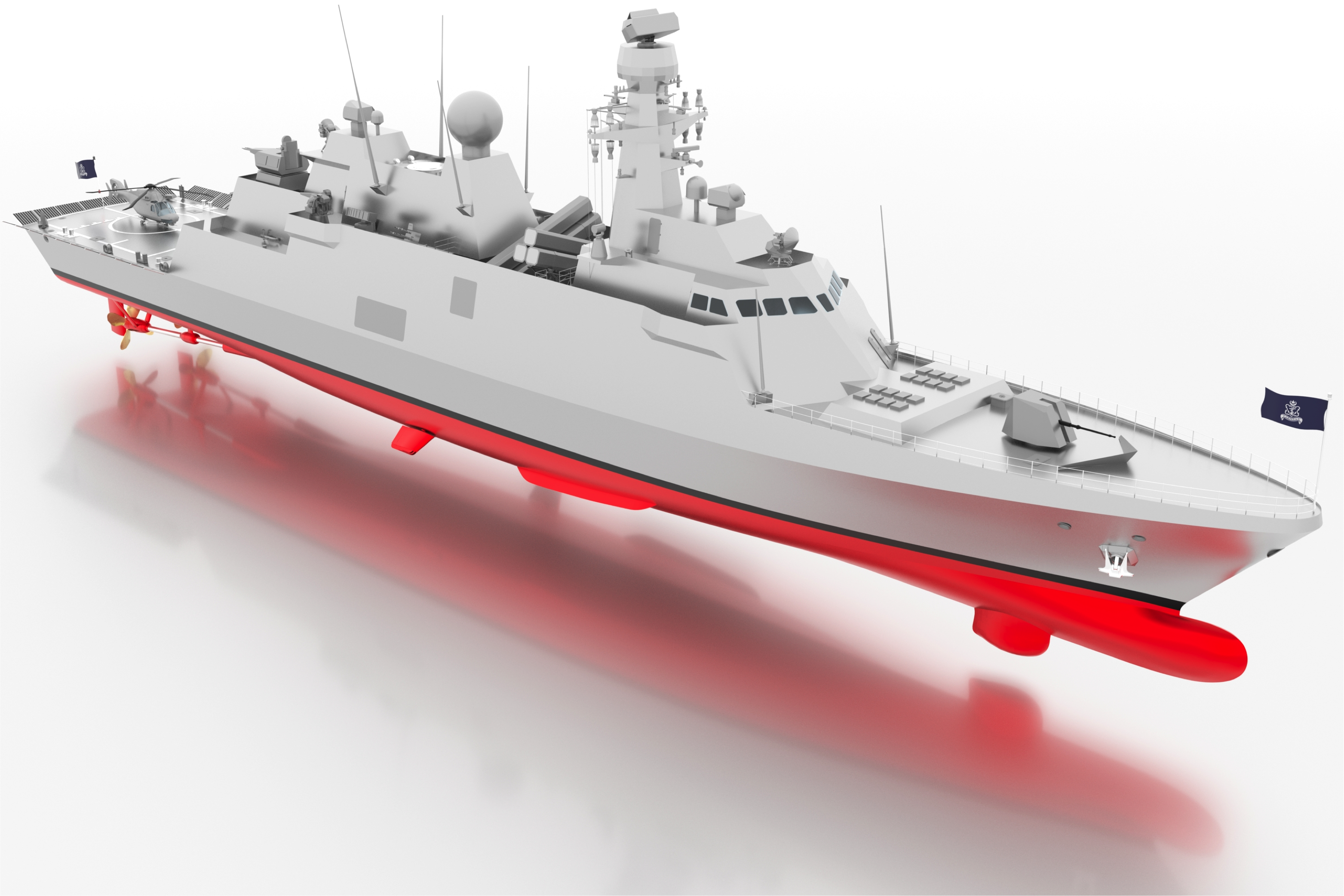

Well this is a genuine surprise...the un-named customer for CAMM-ER (in its Albatros-NG guise) has broken cover...no-one guessed at them....it's Pakistan..
CAMM-ER is being installed on their Turkish-designed MILGEM ships. The first 3 ships have already been built in Turkey, but the 4th is being built (and 'designed') in Pakistan as the first of the Jinnah Class, this is the ship class that will carry CAMM-ER. c3000 tonnes displacement.
