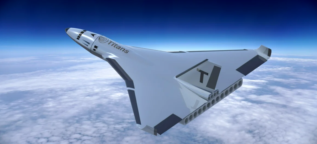

Haze has a 'dip' at the tail where some art has the engine bank straight across...
