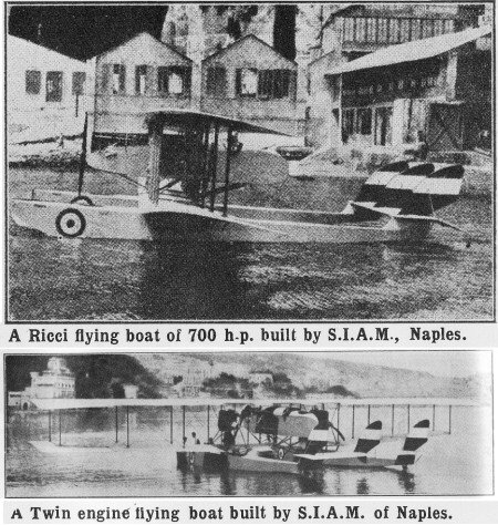

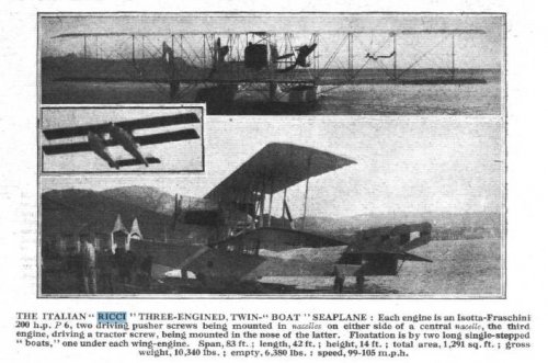

Google found not twin twin-hull Ricci seaplane. I have looked in my twin-boom database, and I am not sure the one I have is the same:from Jane's all the World aircraft 1919, I have the SIAM Ricci (Societa Industrie Alto Mediterraneo). 2 versions: tractive single engine (700hp), pusher twin-engine. Is this what you were talking about? You seem to speak of a 3-engined layout...
Thanks for this confirmation about a 3-engined layout.

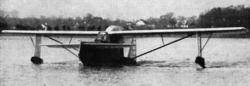

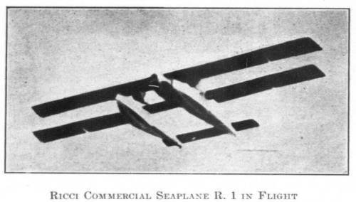

From the JAWA 1919, reduced, I confirm the 1-engined and 2-engined versions:

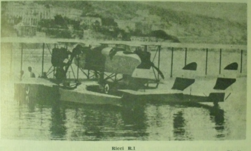

Yes, this is the Ricci R1: as you can see, the hulls are very reminiscent of the FBA fuselage.
The first prototype went lost during the maiden flight and was rebuilt in the following years.
I suspect that the one in flight magazine is the second prototype.
In the flight caption the aircraft is reported as three engined - the discerning eye can distinguish the two pusher engines (above the hulls) and the single tractive airscrew mounted in front of the center line fuselage, suspended between the wings.
the engines were two 200 hp IF and a single 300hp IF - no single engine was capable of 700 hp before the late '20s.
best regards
Thanks for this expert analysis. So... the first Jane's picture would be a 3-engined total 700hp seaplane, but what about the one mentionned as "twin-engine"? Misreading of Jane's writer? ??? ;)

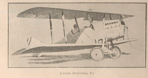

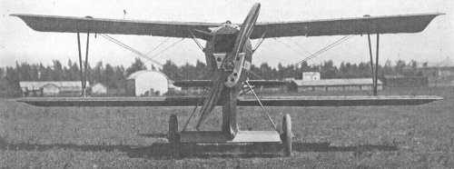

...and the Ricci R.7 trainer, also build by Montofano in 1923...
(same Source)
Maveric
Hi, Thophe
the Ricci's are obscure aircraft, also for an Italian, let alone for an english jane's correspondant in 1920.
The tho photos are side and rearward views of the same aircraft, and that engine installation in the fuselage nose is very difficult to be seen from behind - well, you can see that also in the side view there is some problem to discern the side nacelle and the props may look like struts...
I checked again the books I have at hand and the photos are of a three-engine biplane.
A very peculiar feature are the three coloured rudders, with horizontal stripes instead of the mandatory vertical stripes.
Also lacking is the savoia coat of arms.
Thanks for this final jugement: three-engine R1, all right.
When you wrote triplane, did you mistype for three-engine? or refer to the R6?
Thanks anyway. ;D

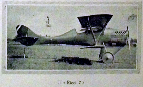

The Ricci R.7;
http://www.avia-it.com/act/biblioteca/periodici/PDF%20Riviste/Ala%20d'Italia/L'ALA%20D'ITALIA%201924%20010.pdf

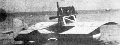

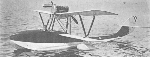

Ricci R.8

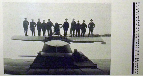

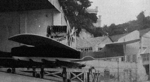

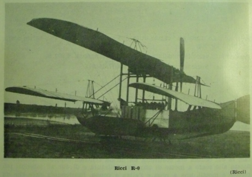

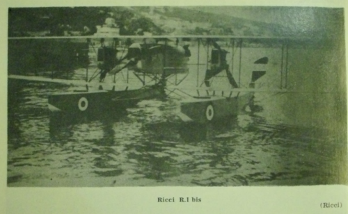

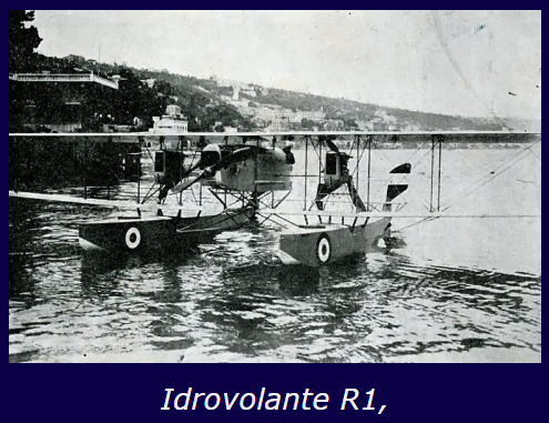

From Aerei Italiani 1914-1918,
the Ricci R-0,R-1 & R-1bis.

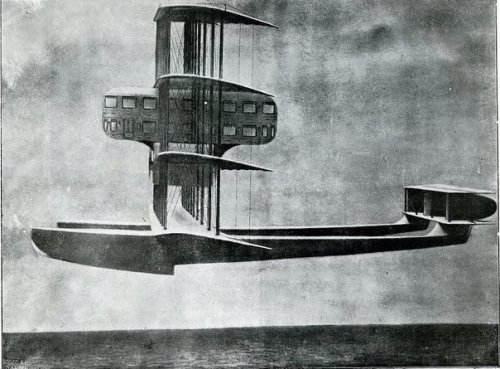

From l'Aeronautique journal,
what was this Ricci aircraft or project ?.
Also I hope to know what was those mysteries aircraft;
Here is the translate,can we ID this beast ?,
The projects of the Ricci brothers.
MM. Ricci have just designed and started work on a new amphibious mono-biplane, on which we will come back for more. The main data of this plane are as follows: Wingspan, 25m; length, 18m; height, 6.40m; surface, 200M2, 50 of which are represented by the two fins which, in flight, transform the device into a biplane, in s lowering to form a lower plane parallel to the upper plane to which they can adhere; 300 HP engine driving a traction propeller; 1 pilot, 3 passengers and 50 kg of post. A special air pump can empty all the air contained in the upper wing whose thickness varies between 2m and 0.50m: this device is intended to lighten the plane, which will reach, it is hoped, a speed of 500 km/h.

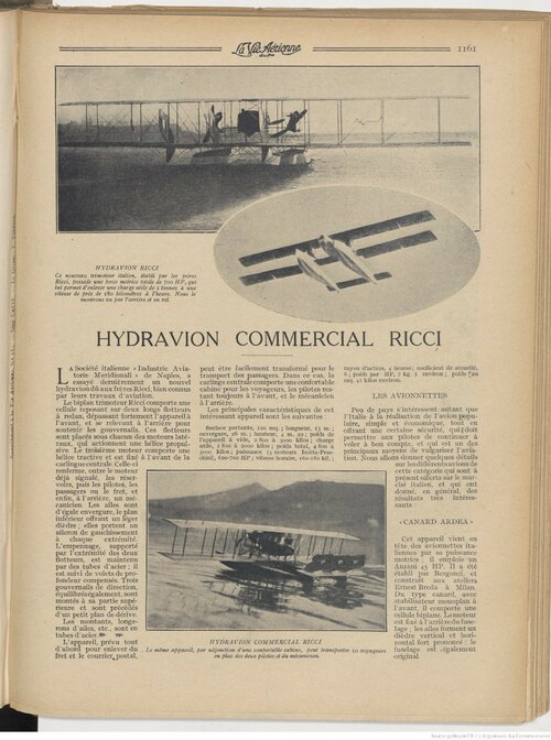

From La Vie aerienne 1920.
