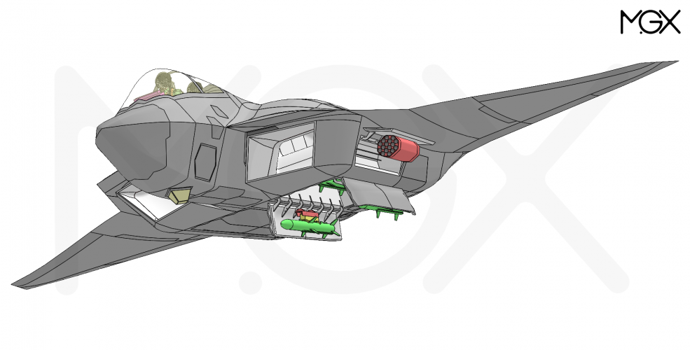

MGX F/A-XX M200, Weapons Bay Loadout Options:
  • Side bays are equipped with 2 AMRAAM as standard (323 kg)
8x AMRAAM - Total payload weight: 1292 kg
4x AARGM-ER - Total payload weight: 2191 kg
4x JSOW - Total payload weight: 2311 kg
2x JASSM - Total payload weight: 2365 kg
24x SDB II - Total payload weight: 2555 kg
12x JDAM / 500 lb - Total payload weight: 3359 kg
4x JDAM / 2000 lb - Total payload weight: 4247 kg

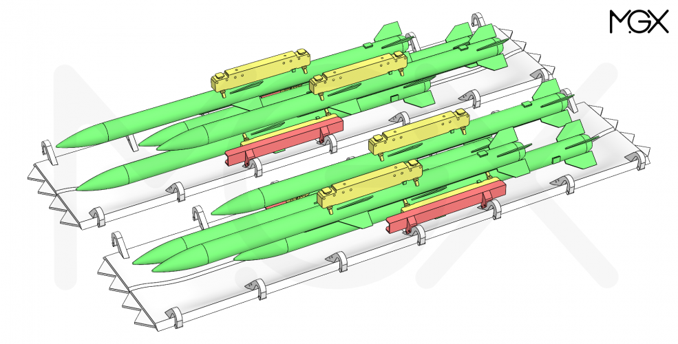

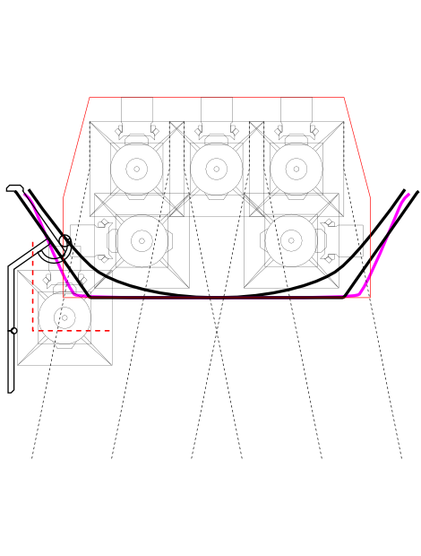

Nope, unfortunately it's not that simple.
Currently, I'm using the entire length of the bay for the 2000 lb JDAMs as well. The bay is too narrow to fit them side by side (without longitudinal offset).
Same is true for the AIM-120 setup... Just look at that, it's like a 3D puzzle! If you adjust something to fit weapon A better, you realize you got an issue with weapon B. Then you are satisfied with A & B and find out you got an issue with C... and so on :D
The current setup is the best I could figure and I'm quite happy with the result. The only thing that bothers me is that only one JASSM fits in each bay and the wasted space that comes with it.

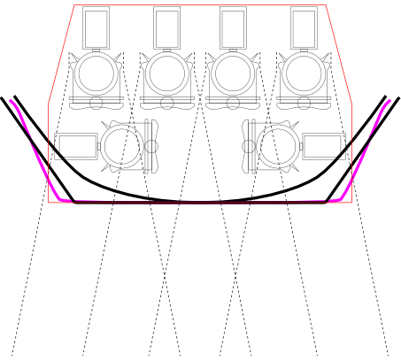

I understand the need for stagger… the question is how much stagger is necessary?
Boeing’s EWP for example has a ~55cm stagger between AIM-120s, for a total length of ~4.2m… much less than what you’re showing here. Likewise MK-84 fins are only ~10 inches long, so ~40cm stagger should leave plenty of clearance, allowing a total length <4.30cm. Both of which line up well with other weapons such as LRASM, JSOW etc, without requiring a 5m long bay.

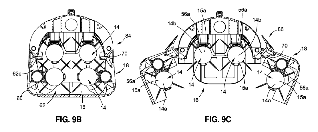

I know Boeing's EWP very well - There's a significant difference between my bay design and Boeing’s pod design:
The EWP has the door hinge located well above the bottom of the pod. As a result, the side walls swing to the outside and the fin closest to the center does not swing across the centerline when opening.
But the fin does swing across the centerline on my bay
. It must have the hinge much closer to the bottom, due to its flat-bottom-door design. There is no option to have doors like on the EWP.
Consequently, a longitudinal offset between all four AIM-120s is necessary - Believe me, I have it in 3D, with moving doors ;)
In a twin-engine design with side-by-side IWBs, the problem is not so much the length but rather the width and depth of the bay.

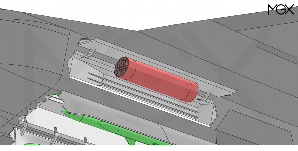

I think stealthy carriage of APKWS would be a nice capability to have for taking out targets of opportunity on the way to or back from your main mission. It’s a gun like capability without having to line up the aircraft on the target.
Maybe integrating 4 tubes into each side bay door would be possible?
That's the maximum size of a door mounted rocket launcher that would fit the side bays. It can accommodate 16 laser-guided 70mm APKWS. 8x AMRAAM + 32 APKWS all together...

But the fin does swing across the centerline on my bay. It must have the hinge much closer to the bottom, due to its flat-bottom-door design. There is no option to have doors like on the EWP.

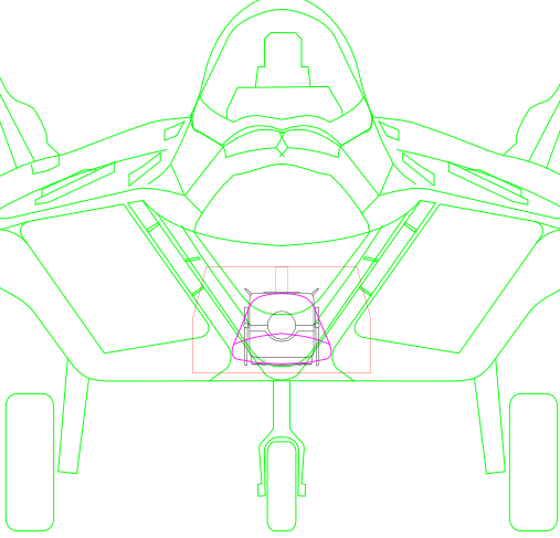

Thanks, I think I understand, though your drawing doesn’t seem to show the fin swinging across the centerline?
ag-iwb_020-png.801214
What happens if you have the top 2 AMRAAMs in the same longitudinal location (no offset) and then the 2 AMRAAMs on the doors offset a little forward, either both in the same longitudinal location or just slightly offset from each other to increase clearance?
It may look simple from the front. But I can assure you that it's significantly more complex in the 3D model. There are many aspects to consider, not just the position of the fins relative to each other. It took many attempts to find the current arrangement - I'm confident the current layout is the best compromise to allow for the most versatile loading possible and to make the best possible use of the volume, not only for the AIM-120, but also for all the other loading options.
The classic 17-shot won't fit?
I'm just trying to avoid custom racks as much as possible.

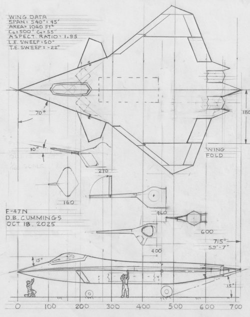

As you can see in my F47's 1040 mm wide IWB I could pack up to 5 AIM120 or 2x 6 SDBs. But as you can see with the dashed lines the problem with both is drop clearance. The conservative choice would be to go with 4 AIM120 or 2x 5 SDBs.
Barracuda 500 is actually JASSM size with more volume and lighter structure for more range.

I assume these micro-missiles would launch from a tube on the upper surface of the aircraft. Like a 40mm belt fed grenade launcher.
