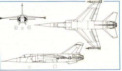

Hi ... I think this is a 3-side drawing ... but I'm not sure !
It is definetly a Mirage F.1, but the only change is the exhaust nozzle (seems logical, other differences to the F.1 design are not mentioned). But the nozzle looks very likely to the F-100 of the F-16 rather than the J-79 (Phantom, Starfighter).
Can it possibly be that Boeing proposed a Mirage F.1 with F-100 engine? F-XX was the LWF program?
An F100 would be rather oversized for the Mirage F1- it would require significant enlargement of the rear fuselage.
Wow!
Great comment Schorsch!!
This pic is mine. I produced this drawing in 2003-4 (I can't remember). It is not the real Boeing-Dassault but only a fake I posted in my former MSN Group. As you correctly noted is an F-100 engined Mirage F-1 with Sidewinders. I was trying to imagine how an advanced Boeing-Mirage contender to LWF could look like.
Boeing-Dassault F1 engine was J-79. No further development existed.
I have plans to produce a new drawing about the J79 design.

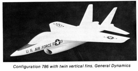

Thanks! I didn't know that GD submitted 785 and 786 as well as 401. I have a pic of 785, but not 786.
Here's the pic you want, Overscan ;)
Judging from the discontinuities in the drawing and the style - I suspect this isn't an original three-view, but rather someone read the description and resized a 3-view of a Mirage F-1 and attached the tail of an F-16 from a different three-view...!
