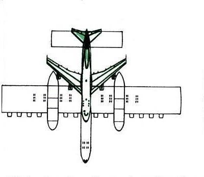

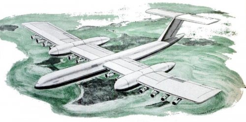

Artist's impression (top) of Boeing RC-1 resource carrier.
Line drawing (bottom) comparing the dimensions of the Boeing RC-1 to the Boeing 747.

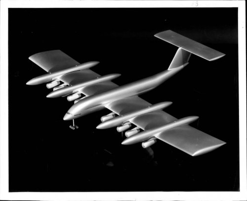

Hi Everyone!
Does anyone know where I might find either three-views or profiles of the Boeing RC-1 "Brute Lifter"?
Thanks!
Chuck
http://www.ebay.com/itm/1971-Boeing-Airplanes-Model-Press-Photo-/190710583605?pt=Art_Photo_Images&hash=item2c673c9135

Just found this interesting thread. At the time the government think tank was pushing this in Canada, there were rumours within the aircraft industry that this was only done to make the risks of building Arctic pipelines look good in comparison to one of these crashing somewhere.

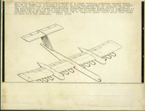

Press photo of Boeing Resource Carrier (RC)-1 concept, aka "Flying Pipeline", drawing/press release circa 1972 found on eBay.
URL:
http://www.ebay.com/itm/Canadian-Oil-carrying-plane-concept-Calgary-pic-1972-/391086393442?pt=LH_DefaultDomain_0&hash=item5b0e90c862

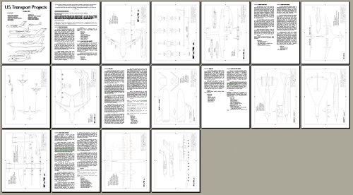

Boeing Outsized transport
Hi all. I wonder if anyone can expand on the following information I have come across in an edition of Air International from January 1972, in regards to a proposal from Boeing for a transport to carry outsized loads. I attach the original text.
  • Boeing outsized transport.pdf
Re: Boeing Outsized transport

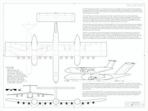

1971 Boeing Resource Air Carrier (AKA RC-1, AKA “Brute Lifter”) designed as a flying oil tanker for the arctic.
http://up-ship.com/blog/?p=31209
http://up-ship.com/blog/?p=32267
