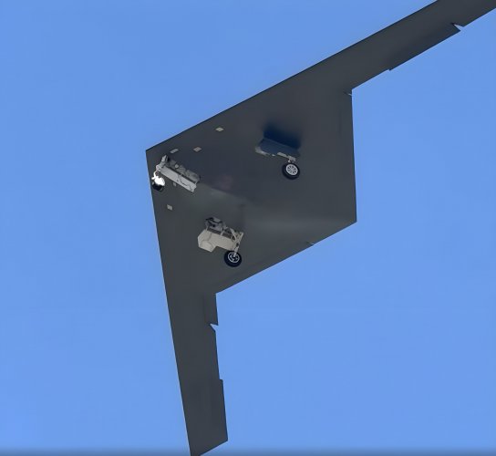

NG had a $7 billion update and maintenance contract through 2029; there were going to be coating changes, weapons integrations, and lots other system updates.
Indeed yes, and I do not think for a minute that the sighting of the unmanned air vehicle in Greece, and the decision to allow the modified B2 to be seen, are not related to one another.
It appears that the B-2 has had a very substantial upgrade indeed!
