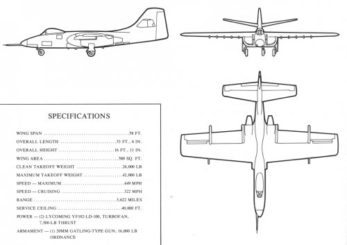

  • USD218856.pdf

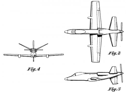

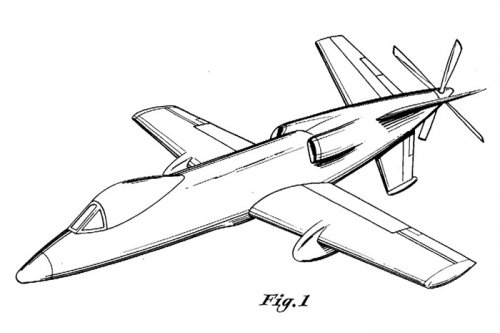

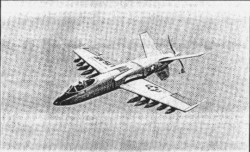

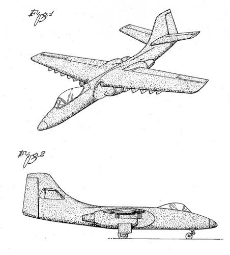

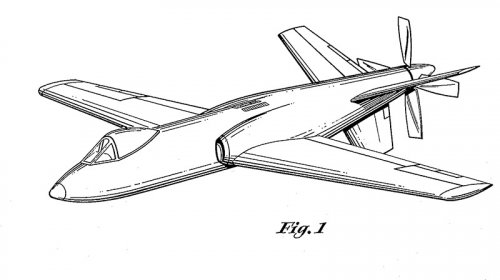

Great find with the Northrop 'early AX design' drawings, Overscan!
Does the Patent info you found have any technical data/specifications ????
Regards
Pioneer

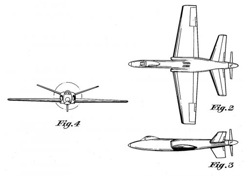

overscan said:
Found via google patent search. Northrop design, seems to be related to early stages of AX.
Patent: D218,856
Shades of the Learfan!!
Unfortunately, its an "ornamental design" patent and includes little information except it was "made in the course of Contract No. F33657-67-C-100 with the United States Air Force" and filed June 30, 1969.

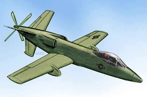

Nice addition to the drawing, Jazz.
Found a little mention of this here: http://aeroweb.brooklyn.cuny.edu/specs/northrop/ya-9a.htm

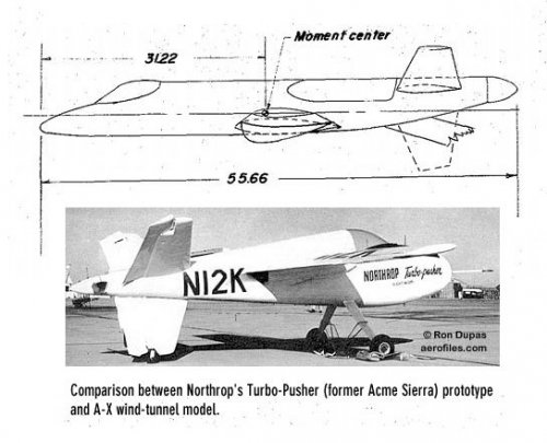

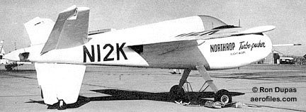

Northrop Corp. produced a flying demonstrator of its
turbo-pusher concept.
A photo is shown on page 26 of Aviation Week & Space Techno
of September 23 , 1968.
Illustration shows a little pusher aircraft with fixed 3 wheel undercariage.
3th wheel in the lower tailfin.
Pusher prop at the extreme tail end.
Overall configuration is close to the drawings already shown
but plane looks no so big.
'Northrop Turbo pusher' written on the side of the aircraft.

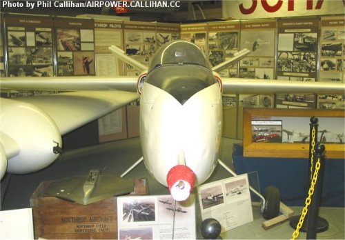

Some pictures - its at the Western Museum of Flight.
The Southern California Historical
Aviation Foundation (SCHAF) has
proudly announced the arrival of
"Sierra Sue" at their Western Museum of
Flight in Hawthorne, California, where
it will be on display for an undetermined
period of time. A unique "pusher"
aircraft with a single propeller in
back of its tail, Sierra Sue was designed
and built in the 1950s as a race plane
by engineers at North American and
Northrop in their spare time. In the
late 1960s, it served as a concept
demonstrator in developing a prototype
attack aircraft for the U.S.Air Force, but
the design was dropped when the Air
Force announced its requirement for a
jet, rather than a propeller aircraft.
Thanks for the pics, Paul
In this photo, we can see the AX concept illustrated in the papers in front of the aircraft.

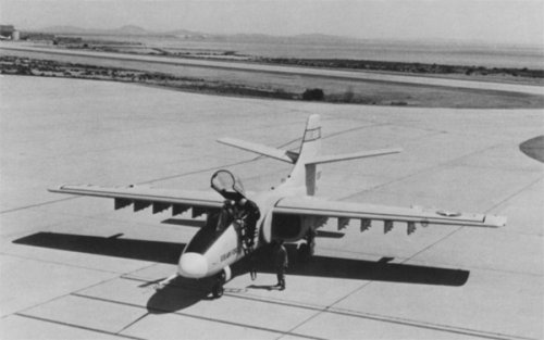

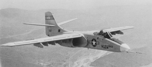

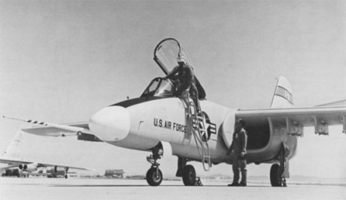

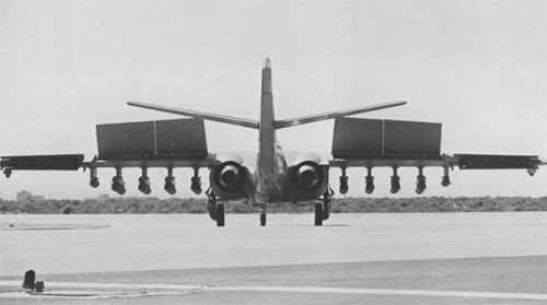

Dear Members,

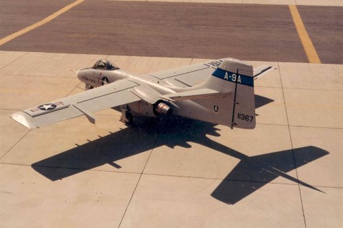

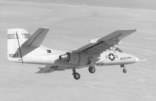

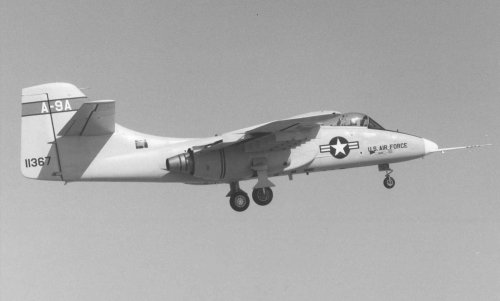

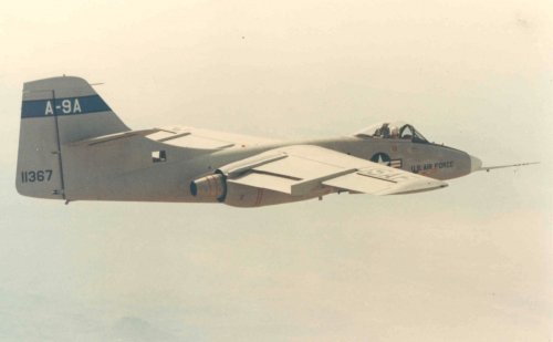

Did the Northrop YA-9A have any advantages over the Fairchild YA-10A design?
Jack E. Hammond

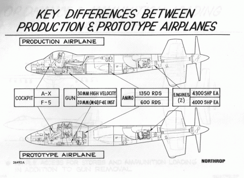

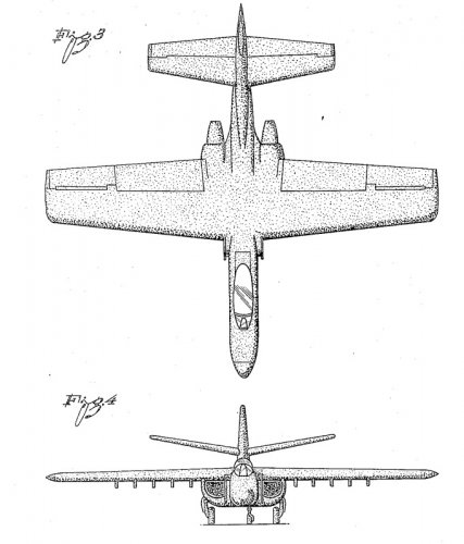

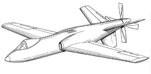

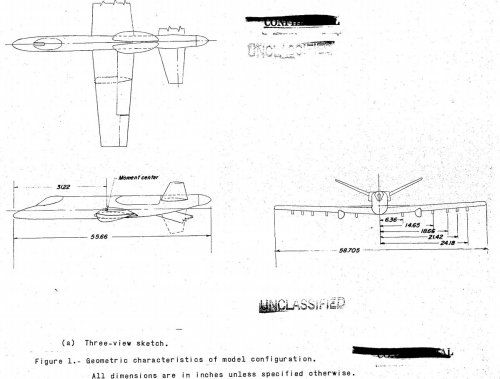

The Northrop AX design appears to align with the Northrop pusher aircraft patent. There was another patent of a very similar aircraft. Perhaps the second design (forward cockpit, pictured bellow) lacks the 30mm Avenger and is a more conventional COIN aircraft design?
overscan said:
Indeed - both patents were already posted in this topic :)
That's where I found them! But I couldn't understand why two pusher designs of very similar aerodynamic configuration at the same time? At first I thought the forward cockpit design might be a larger more powerful aircraft?
The picture and data of the Northrop pusher shows from the A-10 study shows where the 30mm Avenger gun and ammo and the engines would be located. The difference between this pusher and the other pusher would appear to be the later central mounted engines and forward cockpit. Indicating the removal of the Avenger gun system and reconfiguration of the weights in the fuselage to compensate.
Yes, that is possible.
D218856 - filed June 30th 1969 - mentions it was designed under the USAF AX study contract.
D218858 - filed June 30th 1969 - no mention of contract
Both designs were filed almost 2 years after the studies. It is therefore possible the second design is a later development.
Well its clear from Skybolt's drawing that both Northrop pusher patents are AX aircraft armed with the 30mm Avenger. It would appear they just refined the design.
