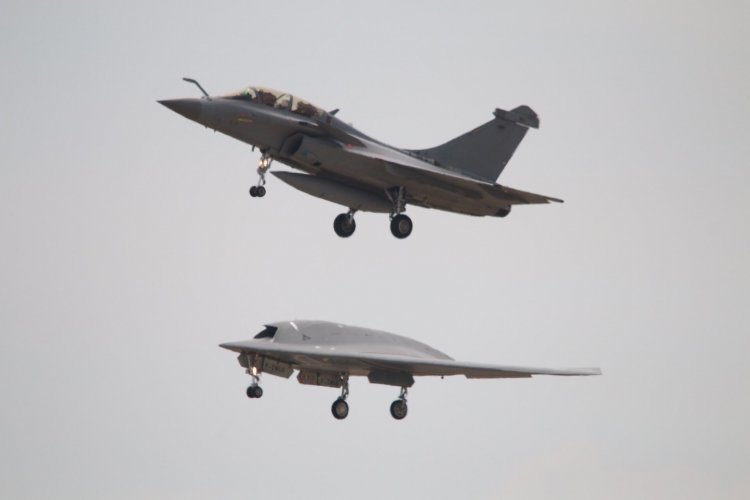

“A pre-development contract is ongoing,” General Arvind Badrinath, head of combat air for France’s DGA defence procurement body, told FlightGlobal in a pre-show interview. “The next phase is to launch the development activity that will lead to a first prototype.”
The UCAV will be paired with the future F5 standard of Dassault’s Rafale, followed from 2040 by the introduction of a New Generation Fighter.

Interesting that the drone (succeeding to the Neuron project) is apparently a recon carrier based airframe.
Given the complexity of its shapes and lack of paneling, the effort to put a real landing gear on something that coulld be a mockup points toward making sure the public get the message.
