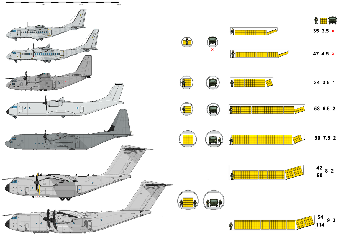

Here’s a good snapshot of the current offerings out there:
To add to my post above, my hypothesis is that anything bigger than the C-130J is going to be « too big », ie. too similar to the A400M.
So the sweet spot might be something to fill the void between the C-27J and C-130J.
2 options here:
Option 1 is an A410M, basically a shrunk twin-engined A400M, but the large fuselage cross section would add lots of structural weight and the payload-range might not even match the C130J. Not terribly appealing.
Option 2 is to start with a 90-100pax civil turboprop concept, such as Leonardo’s TP90, and derive a military variant (~35 tonnes MTOW, so 1/4 an A400M). That sounds better to me. Although it might have maybe only half the C130’s payload range, it would be perfect for low density loads such as personnel and pallets.
Or something in between like the AN-178.
this is a very interesting graph
i didnt realize the KC-390 was as large as the C-130 and Y-9.. and had always thought it would be where the An-178 would be.
Since the C-130 user base is quite large, I am surprised there isnt more KC-390 orders

The real question is which C130 mission(s) this FMTC is replacing.
1) Is it meant to be exclusively a short-ranged intra-theater tactical transport for mostly passengers, pallets and light vehicles? (Basically a Transall replacement more than a C-130J)
2) Or does it need to carry heavy payloads such as light armored vehicles? What about outsize payloads such as helicopters? And how much range does it need, e.g. for inter-theatre missions? In which case it needs to be « bigger and better » than the C-130J…
I personally prefer option 1) as 2) overlaps too much with the KC-390 and A400M itself.
Another possible "light lifter" role might require significant STOL capabilities. 1000m or less runways, possibly dirt roads or grass fields.
That's a very useful graph, it shows you roughly where the effective sizes end up.
I do not see a new cargo plane successfully competing against the C-130J and KC390, so that payload class (~25ton) is out. (Obviously, the top end of the graph is out, too, because that's the A400M's playground.)
So now we're looking at something in the C-27J or Transall/An-12 load classes: ~10 tons or ~18 tons payload.
