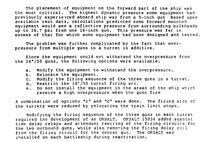

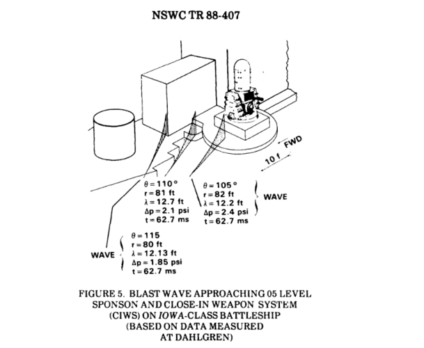

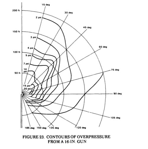

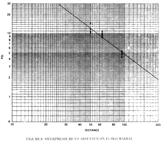

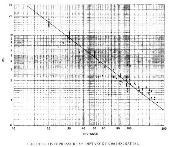

The Iowas had 4 separate Aegis refits proposed, and rejected, on the grounds that sensitive electronics would not survive being within 200ft of the muzzle blast.
I'm kinda confused why you think a battleship is going to have a "point big guns at ships" mission. That literally hasn't happened since 1944.And yet rather less of an issue than 60-90 Sea Slugs full of rocket fuel - and my point on blast vibration is more directed at the 901/984 than the missiles.
