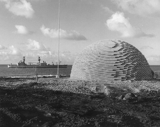

Also, have you seen what a single Talos hit does to a ship? The Talos missile is 3300lbs or so of magnesium alloy airframe, and has 225lbs of explosive onboard. A 16" HE shell weighs 1900lbs and has a 150lb bursting charge. Oh, and Talos hits at about 50% greater speed, too. 50% greater impact weight, with 50% greater bursting charge (ignoring the jet fuel and burning magnesium airframe), at 50% greater impact velocity, for 3.375x greater kinetic energy alone. Any ship not given battleship armor is going to be broken in half with a single hit. I suppose you'd need a nuclear warhead to deal with battleship armor. Whatever the blast didn't directly vaporize, the radiation would kill the crew.
The pictures down at the "Surface to Surface Ship Targets" section at this link show an unarmed Talos impact on a surplus DE. https://www.okieboat.com/Talos firing operations.html Pure KE, fuel, and burning magnesium.
