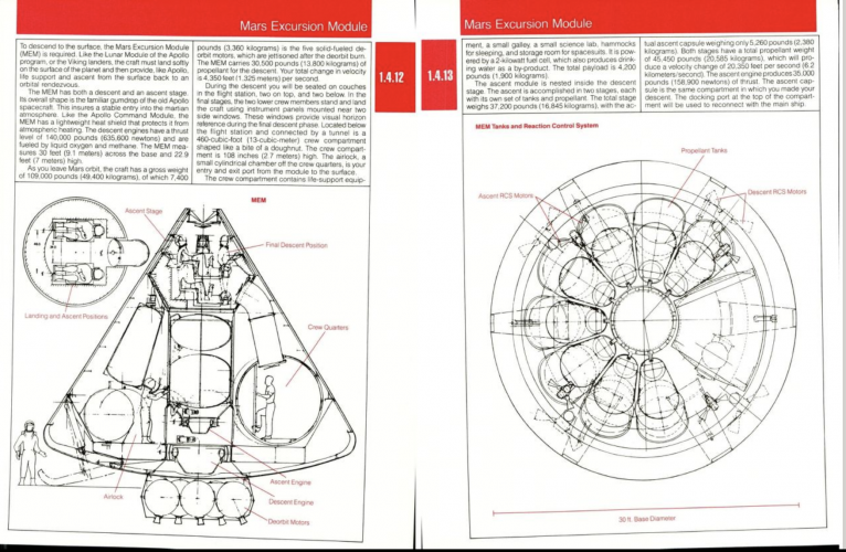

Total mass of 64000 kg for 4 man 30 day stay on Mars
The descent stage weight is 29207 kg with 13834 kg fuel
The ascent stage weight is 16874 kg with 9480 kg fuel
With 2040 kg scientific payload down, 136 kg payload (soil samples) up.
Power supply by fuel cells.
as fuel NAA prosed FLOX/CH4 or FLOX/MMH because LOX/LH2 can not achieve the ascent speed
for rocket engine NAA favored for plug nozzles
RCS system NAA want to use toxic ClF5/MHF-5 fuel !

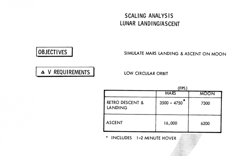

My favorite part: MEM landing on the Moon. Very interestingly the main modification would have to be some plumbing between the descent and ascent stages.
Indeed a MEM landing on the Moon would need 7300 ft/s for the descent, but its descent stage would be sized for Mars and its atmosphere, that is only 3500 ft/s - hence a deficit of 3800 ft/s.
No problem them: the engine would shift to the ascent stage tanks. Which are sized for a Mars ascent 16 000 ft/s, when ascending from the Moon is only 6200 ft/s. And thus the ascent stage would be left with 16000 - 3800 = 12200 ft/s, twice as needed for a lunar ascent.
Bottom line: a MEM trading propellants between its descent and ascent stages through specific plumbing, could make a roundtrip to the lunar surface with propellants to spare: 6000 ft/s of them. This could be used to hover near the landing spot.
