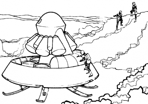

back in 1967 NAA made study NAS9-6464 for MEM for NASA
They look into Lifting Body and Capsule shaped lander. last what was recommended
Total mass of 64000 kg for 4 man 30 day stay on Mars
The descent stage weight is 29207 kg with 13834 kg fuel
The ascent stage weight is 16874 kg with 9480 kg fuel
With 2040 kg scientific payload down, 136 kg payload (soil samples) up.
Power supply by fuel cells.
as fuel NAA prosed FLOX/CH4 or FLOX/MMH because LOX/LH2 can not achieve the ascent speed
for rocket engine NAA favored for plug nozzles
RCS system NAA want to use toxic ClF5/MHF-5 fuel !
Got someone more picture on this design ?
Definition of Experimental Test for a Manned Mars Excursion Module
Final Report Volume IV, November 1967
North American Rockwell Corporation
SD 67-755-4
NAS9-6464
Go to NTRS and dig around the late 1960s human Mars mission documents. There's quite a bit there.
I always loved this design since I first saw it, and it has been used in several different proposals and various artwork.
However, it's probably not workable. You can look up Bobby Braun's paper on Mars entry, descent and landing from around five years ago (I think his co-author was Manning). He demonstrated that existing Mars EDL designs were insufficient above about one ton. The Mars Science Laboratory Curiosity, which is currently on its way to Mars, is about the maximum size payload we can land on Mars without developing entirely new technology. That might include hypersonic deceleration rockets and/or large, lightweight reentry shields.
Simply put, something shaped like this landing craft would not slow down sufficiently before it slammed into the surface of Mars.

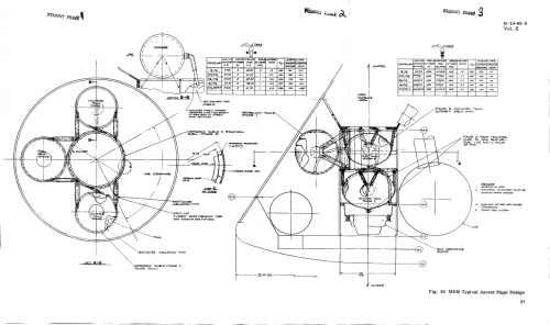

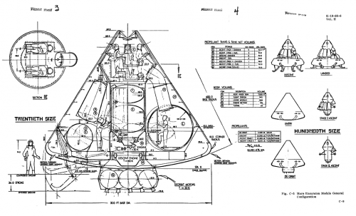

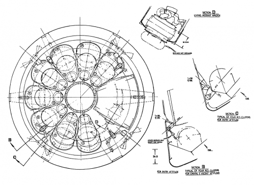

Just found these picture in this PDF
Propellant Selection for Spacecraft Propulsion Systems,
Volume II: Mission and vehicles
Contract NASW-1644
Lockheed, 30 August 1968

Michel Van said:
they replace the proposed FLOX/CH4 Fuel and Plug in engine, by conventional hardware and fuels
I cannot believe that they were originally proposing carrying FLOX all the way to Mars!
That stuff is nasty even in the best circumstances. Would you really want to rely on it staying contained during the trip to Mars? It's just scary stuff.
the Fluorine would create a protective layer on inside of oxidizer tank, therefore consider as long storage fuel.
there only concerned was that FLOX (Fluorine oxygen mixture) would separate and the Engine would suck pure Fluorine.
alternative they look to used Oxygen difluoride
The Picture MEM_005 and 006 show the tanks for this fuels combination
So the Picture MEM_003&004 show a the Lh2/LOX version ?

Here more on NAA Mars lander used in Boeing IMIPS study
naa_mem_004-png.145563
naa_mem_003-png.145561
More here
That lander is rather cool. But I'm really curious if it was actually practical. The 2006 Braun/Manning paper on Mars entry, descent and landing (you can Google it) indicates that conventional approaches to deceleration and landing like we have used so far cannot scale up above one ton. We've pretty much maxed them out now. So this Apollo capsule shape might have slammed into the ground before it could have slowed down enough to land.
The Von Braun proposal use the same NAA Mars Lander MEM like Boeing
in fact the design was so good that Marshall Flight Center overwork the MEM Design in 1985 for a Manned Mars Mission proposal
On Landing the NAA Mars lander MEM compare to Curiosity
MEM use a de-orbit engine, means it's much slower as Curiosity on entering the Mars atmosphere coming direct from Earth,
it use a 9 meter ø heatshield vs. 4.75 meter shield used on Curiosity, MEM got almost 4 times more surface.
the MEM use Mars Atmosphere to slow down with 7 G from Mars orbit. Curiosity coming with much higher speed, need 15 G.
MEM deplores a drag chute then a ballute to slow down, Curiosity use a supersonic parachute in 10 km hight and mach 1,7 and slow down the probe with High G force
MEM cut the ballute 3 km over ground and goes on powered descent, Curiosity at 1.8 km hight
MEM got 13834 kg fuel with ISP of 405sec for landing. Curiosity skycrane only 380kg Fuel with ISP of 221 sec. MEM got almost double ISP
of course the ballute is not efficient for Mars, would had be replace by a supersonic parachute
and there is this problem, Contamination that one of reason the Skycrane was used to keep rocket fuel away from Mars surface and the dust low.
MEM design using FLOX/CH4 on decent engine and toxic ClF5/MHF-5 fuel on rcs, would Contaminate the Mars surface on landing site...
