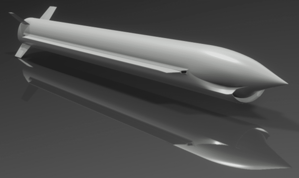

Some projected completion dates for FC/ASW:
https://www.navalnews.com/naval-new...-missile-receives-german-development-funding/
Another effort comparable to the Supersonic Strike Missile would be the Franco-British “Future Cruise/Antiship Weapon” (FC/ASW). However, somewhat like LRASM the FC/ASW-project joined by Italy last year aims to develop two variants. One would be a supersonic AShM available from 2028. A second, subsonic missile optimised for stealth would address the land attack-requirement by 2030.
Not sure there they've got those dates from but they don't match what has been heard recently.
- Subsonic, stealthy long range land attack 'should' arrive in 2028 for the UK's T-26 i.e. Mk.41 launch (and I'm personally not sure if thats credible unless there has been a lot of work done that we have no idea about).
- Anti-ship arrives in 2034...
Couple of points on the above...and in relation to Naval News article
- We know its the subsonic, stealthy, long range missile arriving in 2028 as the UK has always favoured this approach over supersonic
- The timeframes in relation to land attack and anti-ship makes far more sense, no way a brand new supersonic AShM with new seeker tech is developed, tested and available in 2028, land attack would probably utilise some tech from Storm Shadow MLU which is underway at present so 'should' be easier
- Subsonic, Stealthy, long range 'should' be available from 2030 for air launch (i.e. Storm Shadow replacement) initial launch platform will be Typhoon and Rafale, as ever it all depends on integration timelines...
- It's still not clear if 'Anti Ship' refers to the Supersonic, medium range missile exclusively or if there is to be an anti-ship solution using the subsonic missile a la LRASM i.e. a capability rather than a single missile
- We still have no real idea who is getting what...there is a clear need for the Subsonic, stealthy, long range missile as a Storm Shadow/SCALP replacement for RAF, AdA and RA. No doubt there...but...
- UK RN has Tomahawk for subs and MN has MdCN for launch from subs and surface so likely only UK will be interested in VL FCASW from surface vessels initially, from Mk.41. Perhaps Italy might have a requirement for this as well. But it will need Sylver A70...admittedly they will also have some, albeit limited, land attack capability with Teseo EVO.
- MBDA have mentioned encapsulated versions for use from Subs, but that seems a way off for land attack (though I suspect it will arrive in due course as US no longer makes TTL Tomahawk for UK) and Italy 'might' like it. For sub launched supersonic I think it depends how quickly France needs SM39 replacing...
- RN has NSM as an 'interim' system for 11 ships. Italy has Teseo EVO on the way....so what real demand do they have for anti-ship versions?
Basically I can see the Storm Shadow replacement doing a brisk trade if they can get it integrated to platforms fast enough. But the supersonic anti-ship version? Not so much if it arrives by 2034...NSM is cleaning up that space. If MBDA really wants to make a success of it they need to claw back some ground by developing,testing and integrating the missiles for VL from Mk.41 and Sylver, air launch from Typhoon, Rafale and F-35 (and eventually GCAP and SCAF), canisterisation for sub launch for both types, perhaps canister launch from ships or ground systems so that any prospective customer can purchase it 'off the shelf', otherwise it runs the risk of having lots of potential applications that never get off the ground.
