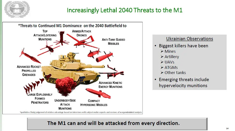

I read the report, and it is clear to me that they are inflating the value of tanks massively, talking up threats like T-14 sabot duels and claiming tank on tank kills, probably from padding using cherry picked data 2014 Ukraine campaign, in which Ukraine lacks modern ATGM with tandem HEAT or top attack capability. With the ongoing war not being over one can just throw up data that don't line up when most reasonable inferences would not agree with many assertions within the document.
The recommandations also reflects a complete lack of imagination where requirements are set reactively after threats have clearly established themselves.
If you ask me what the maneuver branch is about, it is not this trite talk of mobility protection firepower. All combat vehicles regardless of type have all three characteristics and all have classical tradeoffs. Actually, what maneuver is about is closing with enemy, doing things which requires closing with the enemy.
Well, precision large caliber fires no longer requires closing with the enemy and it is anti-synergy to spend much effort for maneuver forces to focus on this. The maneuver force should focus on what it can do.
A few tasks where the future maneuver force have advantage over standoff forces

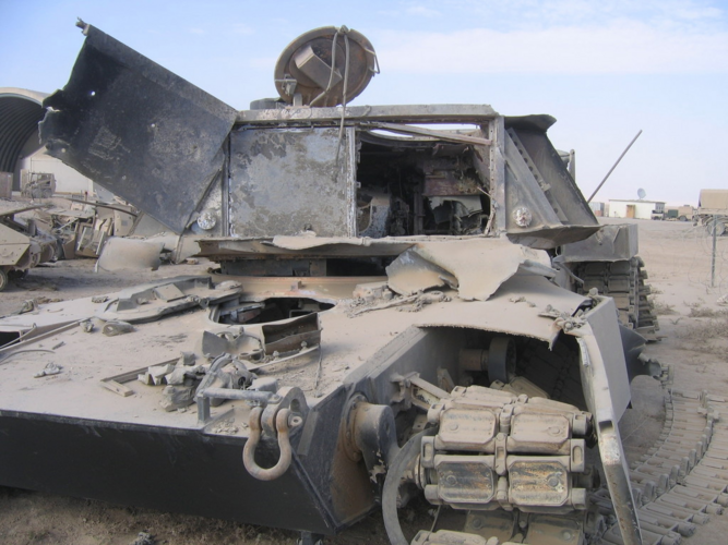

Russian ammo carousels are also said to be not as big of a deal as they are talked up to be. This simply isn't the case. If they had a carousel full of ATGM's it would significantly harm the chances of the crew surviving a penetration. Likewise even with the Abrams design we know just fuel fires have caused mass detonations that blew the entire rear portion of the turret clean off. This had a lot to do with the content of the rack being mostly HEAT. The tank burned for 3-4 days straight.
The difference between cook off on a T-series and the Abrams is that this Abrams was put back into service within a year. TC at the time that it hit the anti-tank mines is now the current TRADOC Command Sergeant Major- Hendrex, Daniel.

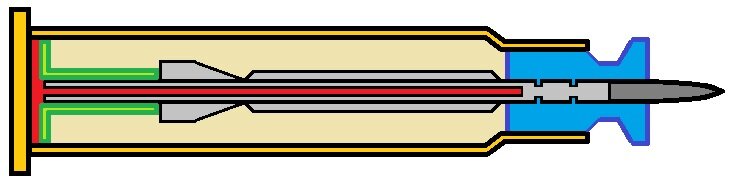

Anybody remember the old nerf launchers where you pounded your hand down to use air to push the nerf rocket? Gas is actually a pretty poor energy transfer agent. But hydraulics are ideal. It would be interesting to see some sort of plunger that used the explosive force to push hydraulic fluids into the hollow rod. As the fluid rushed through the relief valve built into the plunger the pressure would push the rod up the barrel. Once the last of the fluid passed beyond the valve it should be far enough down the barrel for the front-mounted sabot casing to take over. What does it improve? It captures more of the initial energy, much of which would travel down the barrel until the band sealed enough to drive the rod forward. The lost energy is significant. Hydraulic transfers are the most efficient energy transfer possible. The million dollar question is how cheaply can an effective hydraulic plunger be crafted? Hydraulic Plunger.jpg
The fins could also double as stiffeners. The goal isn't more mass, the future is pushing past 1800 m/s. You might need to go to 60:1 L/D. I don't see a 10mm diameter projectile being a problem if you can figure out how to keep it in a straight line. You could vaporize the crew with a hole half that size.

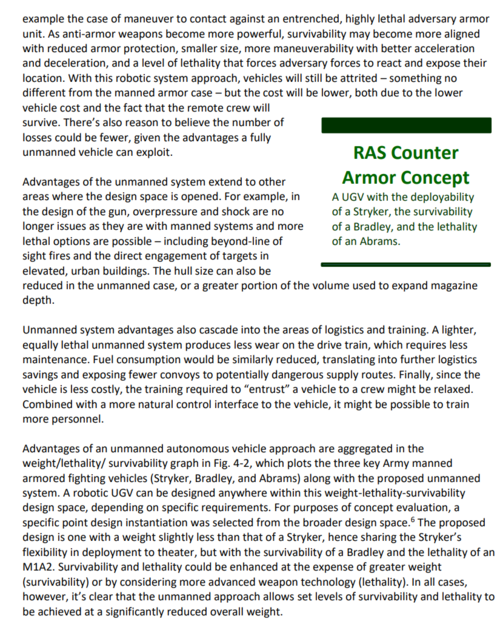

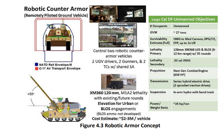

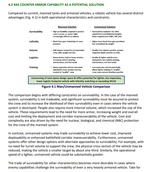

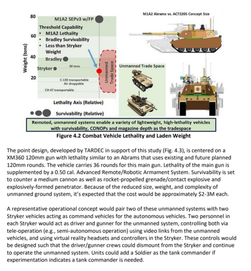

Dunno if this fits here, but heres what Nicholas Moran ( The Chieftain ) had to say about the model ( from Tanknet ) :
" OK, I saw that one over a year ago when I was at Warren to film the M10. At the time, it was still a 'don't talk about it' design, I guess that's no longer the case. Thing's made of fiberglass. It is literally a conceptual model.
Note the hatches in the bottom photo. It is an unmanned-turret concept, similar to TTB or Armata. There's no reason it can't become an 'optionally manned' vehicle in the future, but note how in the Ronkainen twitter photo the 'front part' between the tracks and forward of the turret is missing. Looks like they just pulled that part of the module away. Not sure why they did that, they may as well add armor or whatever. Otherwise those front side plates holding the wheels together are going to have to be very thick. "

The DU is either a plasma, or a dense particulate spray. Because plasma is a gaseous state of matter so hot the electrons are no longer bound to individual atoms. Because of this an unbound plasma tends to dissipate extremely quickly. Which means that a dense plasma tries really hard to become an atmospheric pressure gas.
A ballistic vest will be ace at stopping a plasma, because the plasma will just burn the upper layers of the vest without penetrating.
Considering the mechanics going on in tank on tank engagements with DU penetrations it's unlikely that there is much if any plasma generation going on. With penetrations you're going to get sprays of particulate of varying sizes (with serious overmatch you essentially get one big piece of particulate going into the enemy tanks interior), and considering DU is pyrophoric, it's going to be on fire too.
It's going to be like a dragon's breath shotgun round going off inside the tank.

If M1E3 take a more conservative development course, so imagine instead of AbramsX or KF-51, it would be a SEPv4 with improve all-around armour, a Quick Kill type APS that mainly protects from ATGMs or similar high-velocity threats ( lofted APFSDS), turret-ted smoke launchers to protect from EO guided munitions across all arc, and more antennas for reliable comms ( new GPS, more resistant datalinks, radios etc) and EW ( SIGINT pecking on enemy intel, or jamming tank comms or drones exposed datalink in general), a soft-recoil 120mm gun with most of the tank killing from podded ATGMs.
SEPv4/M1A2D is dead now.
Would such a tank be feasible in, around 2040?
No, because Armor Branch (and all other Army branches) are largely incompetent at procurement, and DA vacillates ineffectually between conservative and radical design preferences roughly every 5 years, so we will be spinning our wheels until the Chinese produce a supertank. Then we might get 99% of the way there in about 8 years and stop at the final hurdle because of some reason outside of DA's control.
This is what has happened for the past 30 years. Barring some relatively minor, but important, procurement programs like MRAP, JLTV, FMTV and HEMTT's B-kits, the T901, and Javelin's incremental upgrades, we're still using the same things we did in 1990. We will likely continue this trend into the 2040's.
The exception will be if there is a major land war on par with Korea, which we'll probably lose in the first round and win in the second, after producing all the tanks we will ever need in the meantime.
