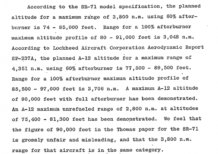

The above discussion got me looking at the NRO and CIA declassified libraries and I've found a little gem of a document, related to A-12 vs SR-71 performances, the year their fates crossed: 1966.
