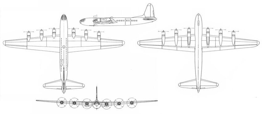

I quickly knocked up this N10N possible cargo/pax variant. I put in a cargo door as I would have guessed that there would be a need for such an arrangement. I must add that this is totally speculative in regards to what it may look like, or if it exists
