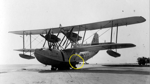

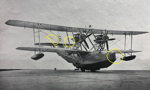

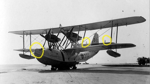

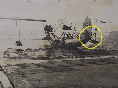

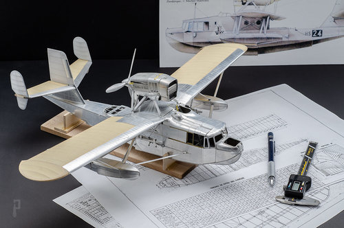

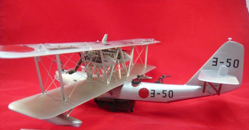

Hi! I found some discrepancy in 2 photos. From this we can conclude that there were two modifications of H2H. The difference in the design of the nose and tail rudders. I assume so…)
I would very much like to know which one is later. But we can assume that initially there was a landmark building on Southampton with all sorts of thrusters in the design. And on later modifications, this was all removed. And removed the large angle on the nasal cheekbone. But this is my guess…)
This I discovered when I started making the boat part…)
Yes! Modifications can be understood by its onboard number!
You did it again Genri-san. Nice find!!

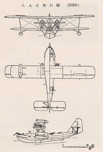

I found another small "inaccuracy"...in the drawing, the central part of THE lower h2h wing looks without any elevation angles. And in the photo you can see that the wing immediately has a small elevation angle, and in the photo where the descent was filmed (rear view), you can see the shape of the wing, like a Seagull. From this we can conclude that the angle of the wing is given already from the fuselage itself. I found some other small changes in the design, for example, in the tail struts, but this is already the case...I do hope, dear blackknight, that this damned COVID will soon be over and you will visit your mother....))

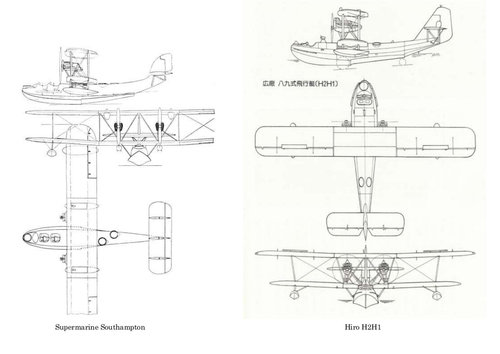

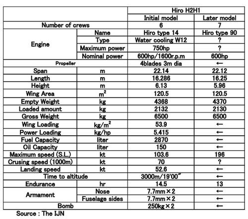

There were two types of H2H1.
Initial model ; Span : 22.14m, Length : 16.286m, Height : 6.13m, Engine : Hiro type14 550hp, Crew : 6
Later model ; Span : 22.12m, Length : 16.25m, Height : 5.96m, Engine : Hiro type90 600hp, Crew : 7
Source : The IJN

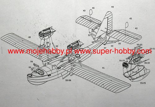

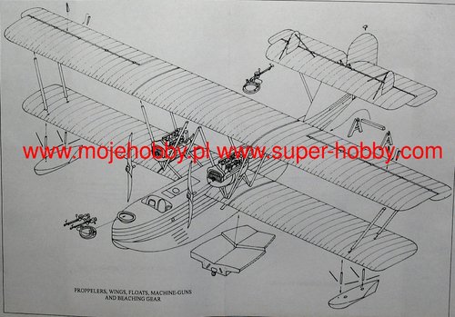

Hello blackkite! To be honest, I was hoping that I could find something in the book. After all, the main source of illustrations and drawings is books and magazines. I just can't figure out what you can find in the Yamato Museum. But you know better...I'm not in Japan..) And about the drawings. I came across an Assembly drawing from a Polish company of the H2H aircraft. That's where they got the drawings that there is a passage from the cockpit to the tail (to the Navigator and arrows)? If they draw it, it means they had some kind of primary source. Which one? The same goes for H1H...I'm not rushing you, because the virus is still out there... it's just my thinking. Thank you very much for your help. Good luck. 000.jpg ccc.jpg
I recognized that H2H1 is larger than Southampton.
Southampton's cockpit is tandem and H2H1's cockpit is side by side.
Anyway there is very little information about H2H1 in Japan.

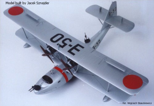

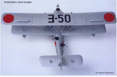

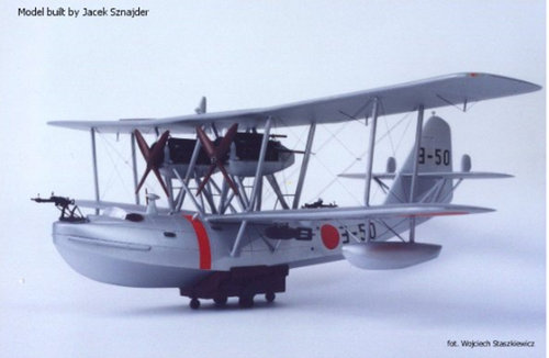

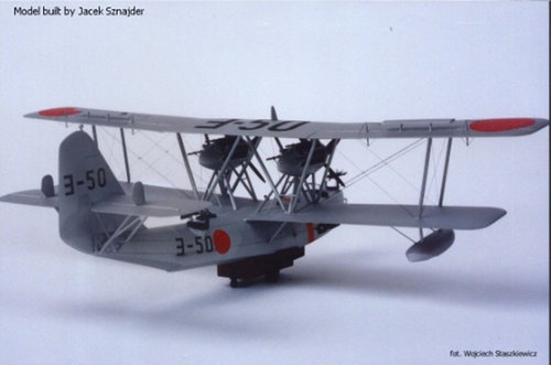

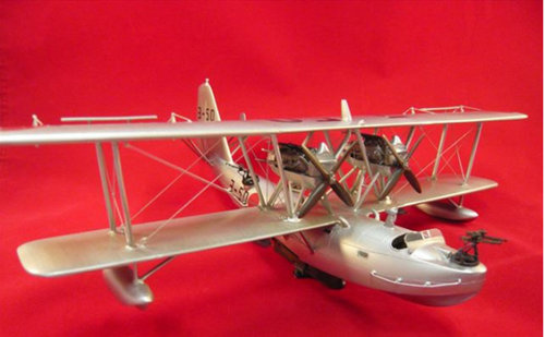

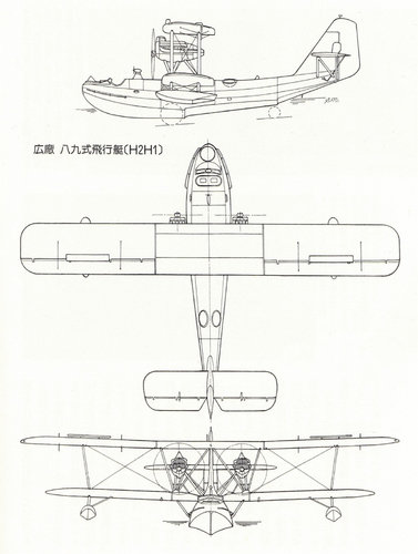

Hi!
Source : ENCYCLOPEDIA OF JAPANESE AIRCRAFT VOL.3 KAWANISHI HIROSHO CONTENTS.
Hi!Yes, I know about these characteristics. I just wanted to ask what sources they used, where they got the data from when they made the drawing for their model?In particular, where did they get data on the passage from the cockpit to the Navigator?
Sorry this is what all I know now.

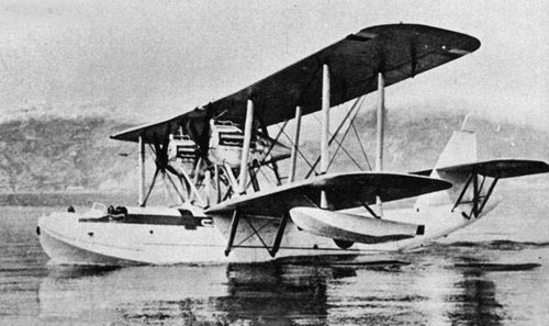

Hi! I begin to make struts under the lower wing. Again, the discrepancy between the drawing and the photo. The rear slope of the lower wing in the drawing is located far beyond the redan, and the photo clearly shows that it is located next to the redan or on a section of the redan. Blackkite, my friend, you are there next to the artist, write to him so that he correctly made the drawings...)))
I reallly feel that the actual and the digital modelers understand very well about the target aircraft.
They are thinking about the aircraft very seriously in detail every day. Especially 3D is very very hard.:)
It becomes incredibly complex only by one dimension.
Friends, I was wrong! This in the photo is not a redan of the bottom of the boat, but the end of the ground cart. Please excuse me..(( :rolleyes:

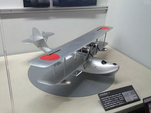

I went to the Yamato Museum after harvesting onions in Hiroshima today and there was no new information about the H2H1 flying boat. Even the model of the H2H1 flying boat that was normally exhibited was not exhibited. It is very regrettable.

I remember that H2H1 model in Yamato museum is a small one which I posted the picture previously. Tail end shape of the model looks like your opinion.
I can't believe that the Yamato museum does not display this model now.
