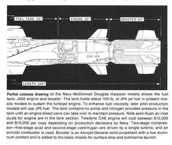

Harpoon missile
I think a SLAM-ER has a longer fuel section though.
Yeah but no Harpoon with Slam seeker or Harpoon with Slam seeker for ukraine? Atleast with the seeker they got better chances of hitting precise enemy Targets and for extra range one needs to revive Block 1D/Block II+ er engine, smaller warhead or all of it.
