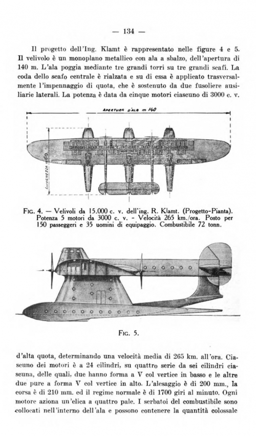

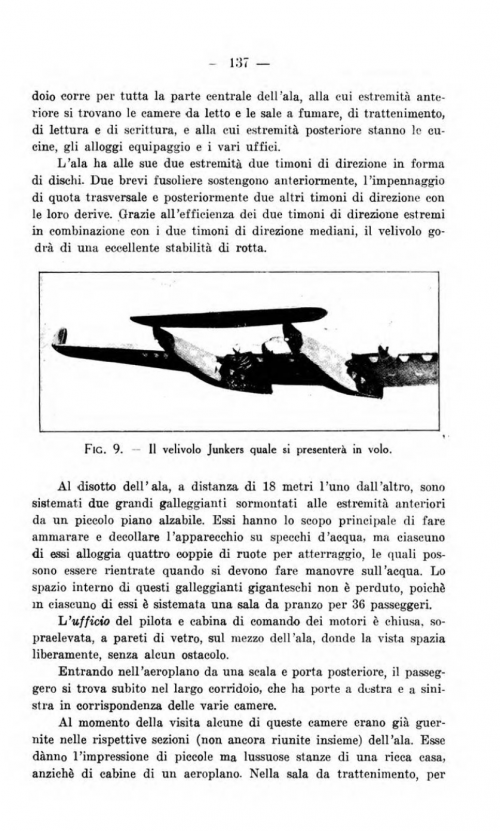

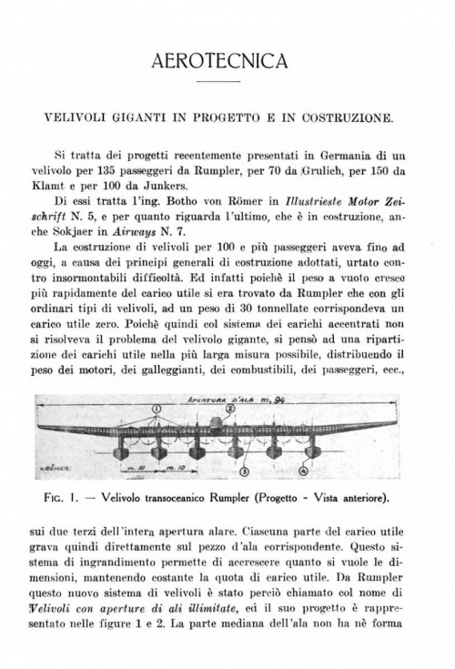

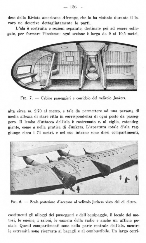

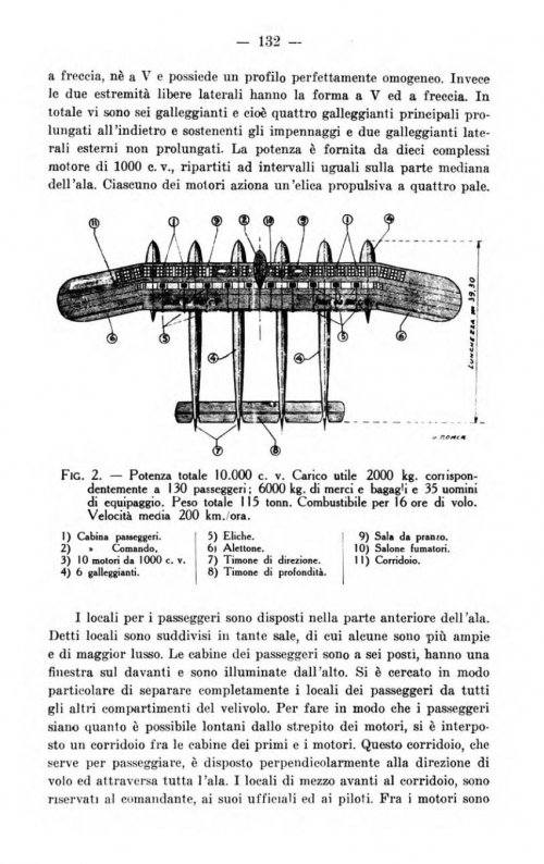

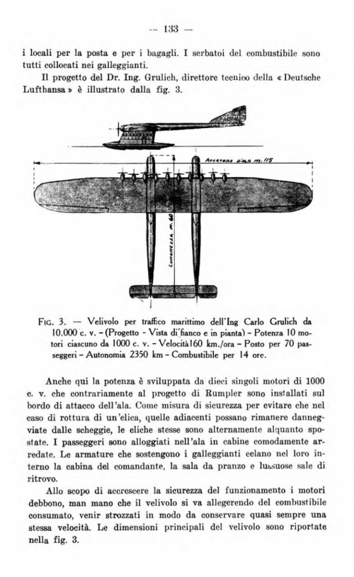

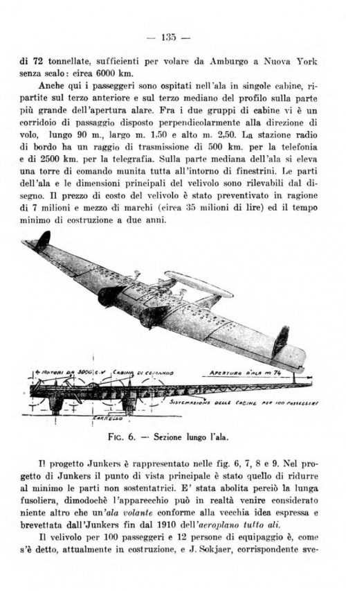

From, Rivista aeronautica 1927

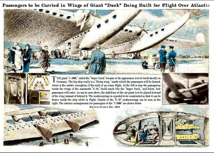

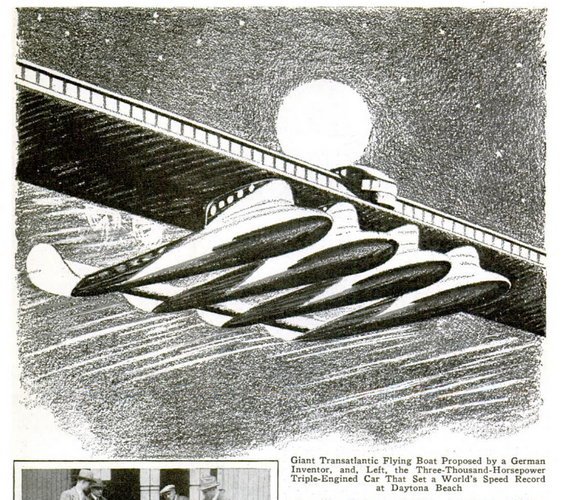

Found this in a newspaper archive (December 1926). It mentions a very large German seaplane liner for transoceanic travel. The wingspan would have been around 140 meters, plus a capacity of 150 passengers + 34 crew in luxurious accommodations. Luftfahrt History heft 8 also mentions this design, describing it as a 4-hull seaplane airliner. It was to be powered by 5 engines (2 in pusher, 3 in puller configuration). Neither source has any blueprints or drawings.

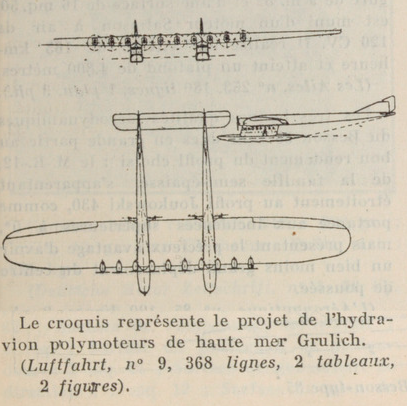

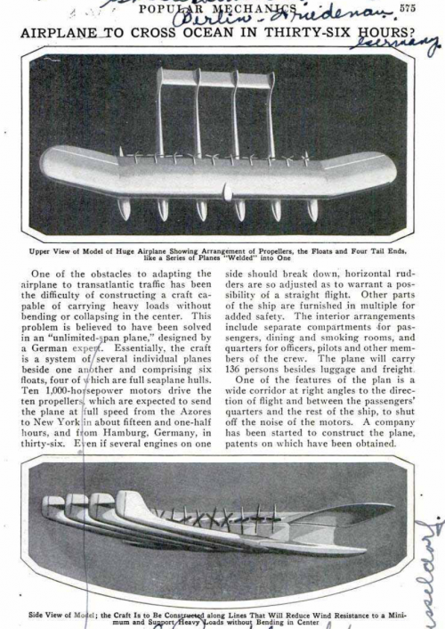

I the book Flying Wings by Rudolf Storck on p.20 it swtates that Kar; Grulich built large aircraft for Gothaer Waggonfabrik in (from ?) 1914. In 1919 he designed a 9 engine Nurflugel-Fluboot with boomerang shaped main wing.
In this thread, all the Grulich designs have ten engined. The term nurflugel / all-wing - ie, tailless might have been misused.
Main wing implies a tailplane. Boomerang shapoed wing appears to describe the Rumpler design.
Can anyone untangle this one ?
These are two separate, unrelated airliner designs by Karl Grulich. Of these the 10 engine one is a twin float, twin fuselage flying boat with unswept wings and a standard twin boom tail structure. The 9 engine design is the nurflugel which you mention. There is very little information on the latter project, but here is an excerpt from a 1945 article.
"K. Grulich, during the war of 1914 designer of the Gotha aeroplanes, a few years ago projected a huge Flying Wing flying boat with nine engines and a boomerang-shaped wing. One of its features was the arrangement of rudders and fins immediately in front of the nine pusher airscrews; the latter were placed above the trailing edge of the wing. (Weyl A, 1945)
Weyl A (1945), "Tailless Aircraft and Flying Wings: A Study of Their Evolution and Their Problems". Aircraft Engineering, Vol. 17 No. 2 pp. 41–46, doi: https://doi.org/10.1108/eb031217
Adler - thankyou for finding a definite reference to a Grulich flying wing.
His description suggests that he had seen a drawing but of course Weyl's writings were not 100% accurate.
Interesting and frustrating.
