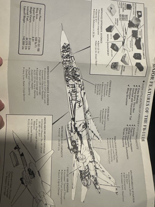

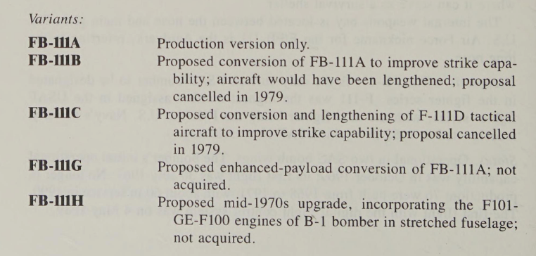

Another question - is there any detailed description available of what type of intake the FB-111H was going to use?
I’m not an aviation expert or anything but this might help? It’s an official brochure I got from my Great Grandfather which was a colonel and flew an FB-111A
Yikes, that is some scary-high wing loading.
I suspect there is a fair amount of body lift, but it has always seemed weird to me that the wings aren't any bigger.

The FB-111H was supposed to use fixed geometry intakes that reduced both cost and complexity. See https://www.twz.com/38621/this-stretched-super-fb-111-was-a-low-cost-challenger-to-the-b-1-bomber .
Remember that the F-14 and -15 have immense body lift that isn't really counted in wing area measurements.
Plus it's a dedicated low-altitude bomber. You need a high wing loading down in the weeds to reduce turbulence.
The FB-111H, not the F-111. Almost 13 feet longer, twice the fuel load (64,000 pounds), 40% heaver takeoff weight (140,000 pounds, 155,000 with inflight refueling), exact same wings.
And it's still a dedicated low altitude bomber (in place of the B-1). With lots of body lift from the enlarged fuselage.
