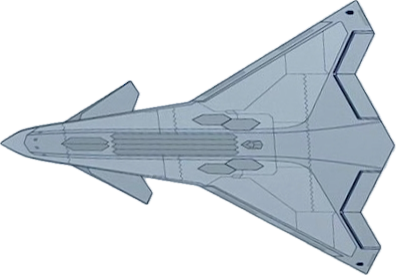

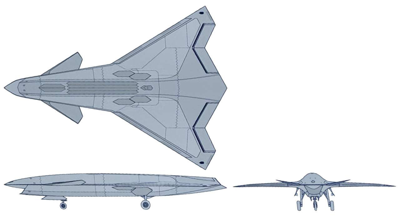

I see the forward projected total surface and the chin inlet as sub-optimal for a design without vertical tails.
Notice however that there is a dual refueling system: Probe on the port apex marked area and boom receptable on the top.

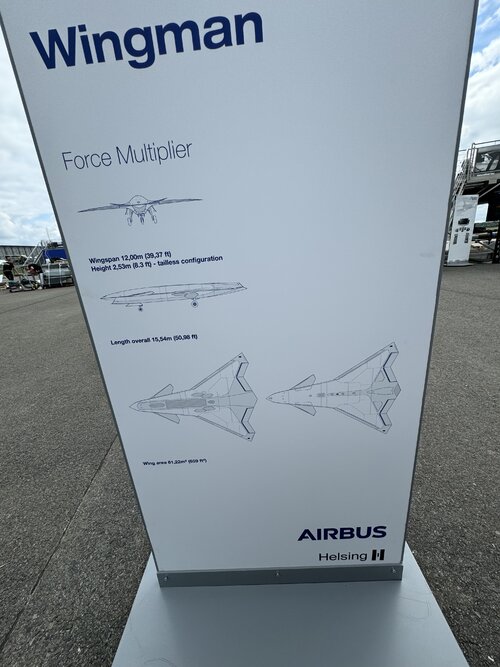

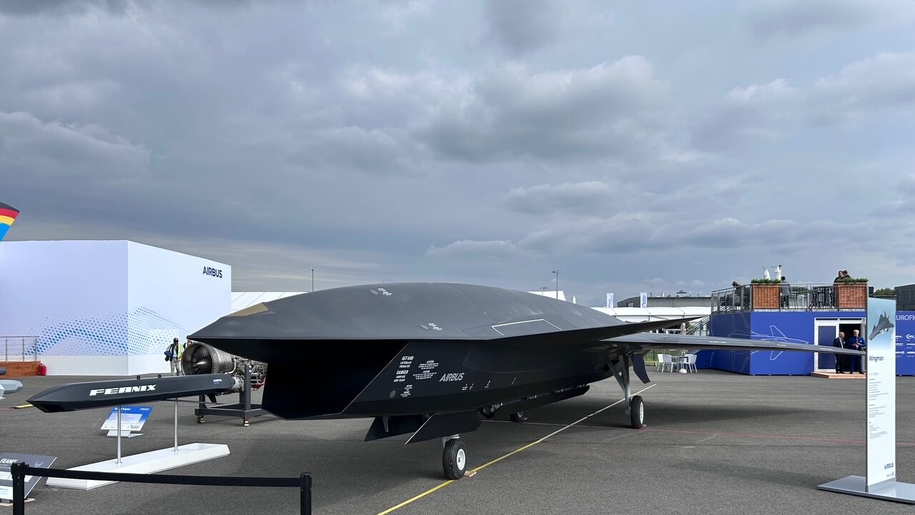

Length of the model is 15+ meters. That´s F-16/Typhoon size!! That looks like something extremely expensive for a small weapon bay (see how the inlet has to be routed above the wb, reducing its inherent volume).
Notice also that the apex markings that I identified above as an emplacement for the refueling probe (deployable) is also present on the starboard side.

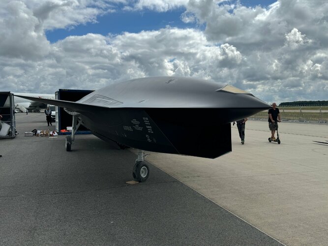

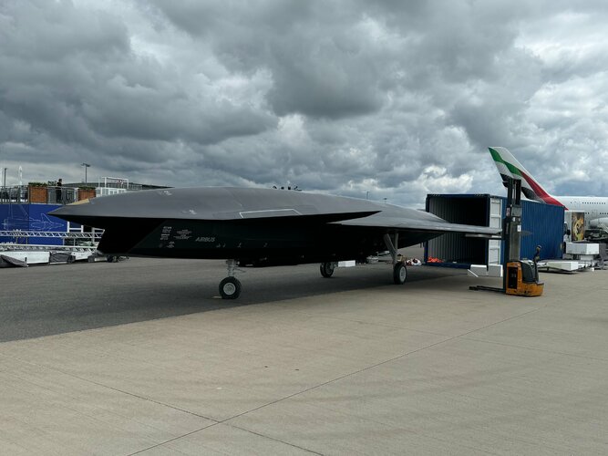

Gareth Jennings is saying its bigger than the Typhoon next to it...2 internal bays apparently...
Side by side then. (see picture of the podium stand wih 2x2 wb door sets, side by side). Wb's length approx. 5m. So, roughly F-117 size but probably shallower.

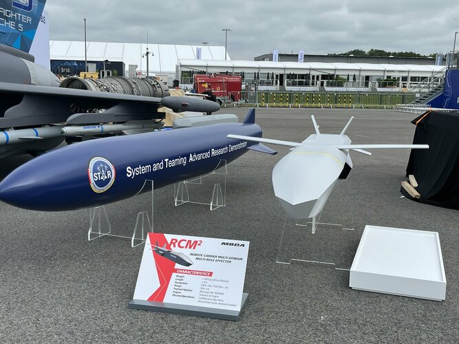

Say 9t empty, 10-12t thrust class engine (EJ200 stage 2 or equivalent), 5-6t internal fuel, plus a 4.5m long weapons bay for 4 AAMs or 2x 400kg Remote Carriers (JSOW/JSM size class)… about 2/3rds an F-35A in weight, thrust and payload.

What i find interresting is how small this NGF IWB is or it looks. Now this may be just a concept art for it or even only for a loyal wingman but still not that big.
It's probably not representative. Look at the relationship between the inlet and the front of the IWB; it's probably not physically possible to have a functional duct behind that inlet.
