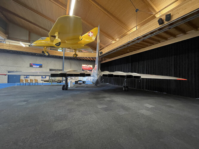

Hello all

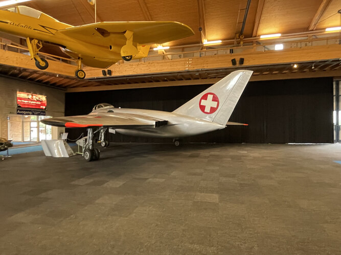

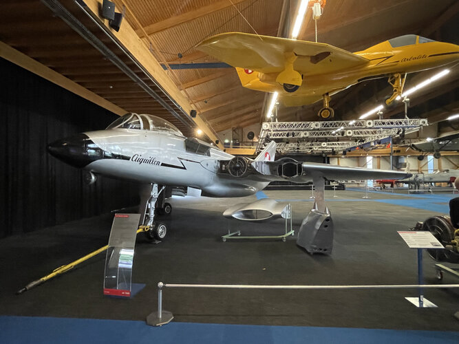

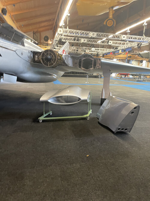

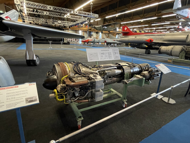

I am wondering if anyone knows of any four engine propeller or jet fighter programs or designs. The only example I know of is the Swiss EFW-20 Aiguillon. Attached below are some reference photos of the Aiguillon in the Swiss air force museum in Dübendorf. I took the photos when I went to the museum last summer.
Interesting. I have come across that aircraft before, but I always thought it had two engines with split intake ducts.

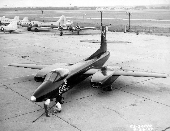

XP-87? Nope. Four cruddy little J34s.

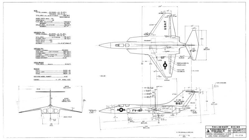

American Secret Projects Fighters also has a several big long-range interceptor candidates with four engines. And one -- the Northrop N176 -- with eight!

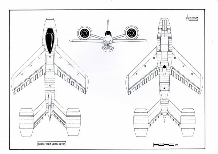

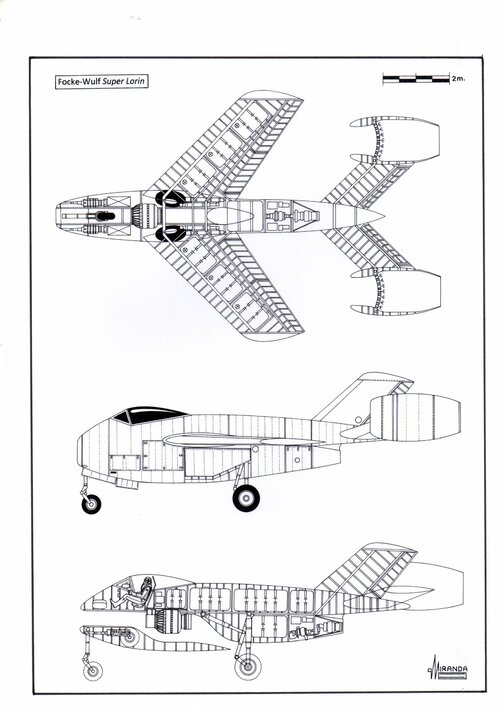

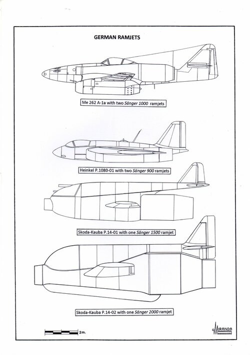

Focke-Wulf Super Lorin
To solve the problem of the excessive landing speed of the Ta 283, the project team led by the Dipl.-Ing.von Halem sent to the OKL the dossier Baubeschreibung Nr.246 describing a short-span STOL variant of the Super TL with an auxiliary turbojet providing vertical lift, one bi-propellant rocket and two ramjets. This project has been commonly described in the literature as Focke-Wulf Super Lorin
Built in light alloy, the fuselage housed the pressurized cockpit with ejector seat, two MK 108/30 heavy cannons, the landing gear, one 270 litre tank containing the B.4 petrol for the turbojet, two K1 heavy kerosene fuel tanks of 650 and 845 litres for the ramjets, one C-Stoff rocket propellant tank of 345 litres, one T-Stoff rocket propellant of 575 litres, one HeS 8 turbojet with 720 kp static thrust and one bi-propellant rocket Walter 109-509 A-1 rocket with 1,700 kp peak thrust. The wings, spanning 7.6 m and with a 15 sq. m area, were built in wood/plywood/steel and housed six K1 fuel tanks with 150 litres each.
The tail planes were built of steel and served as support for two Pabst ramjets of 10,850 kp thrust each. The landing gear was of the same type than that developed for the Super TL. The exhaust nozzle of the turbojet was located on the fuselage belly to the purpose of generating lift thrust during take-off and landing. High altitude performances could also be improved, although a shorter wing span might make the airplane very fast at lower altitude, where the ramjets could produce the maximum thrust.

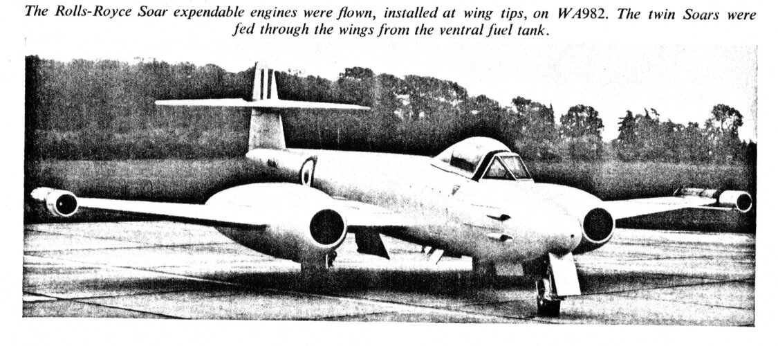

There was also a four engined Gloster Meteor prototype.
There was? It is not in any of my sources that I can find. Can you give any more details, or is it just another Internet myth?
A dummy cowling on the port wing, that's what I found as well in Aircraft Profile #12, The Gloster Meteor F.8 by C.F. Andrews. Andrews goes on to write that 'this Meteor was in fact the only four-engined example of the Meteor to fly'. Curiously, in Gloster Aircraft since 1917 by Derek N James, Putnam 1987, Meteor F.8 WA982 is mentioned as 'one of the two Meteor airframes to have had four engines'.
I haven't been able to track down that second four-engined Meteor, though. Any thoughts on this, anyone?

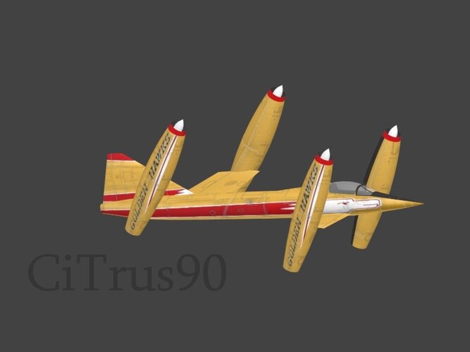

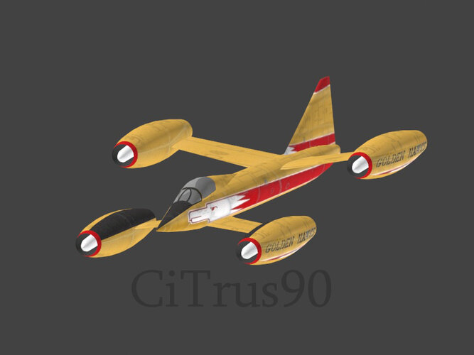

VTOL aircraft might be cheating unless the engines used for lift are also used for forward flight, so there's the Avro TS-140, illustrated by Citrus. There's a terrific online resource by one of the regular contributors here but damn it, I haven't had my eighteenth coffee yet so it's still on the tip of my tongue... Help?

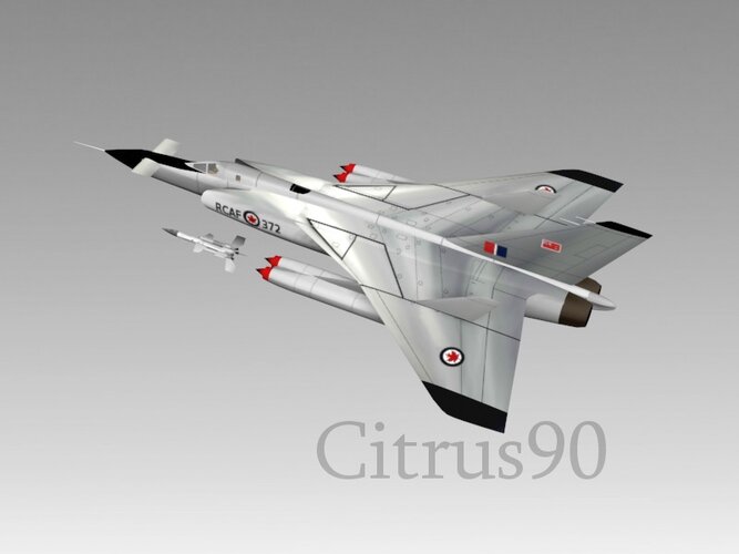

Also Avro. Some proposed Arrow variants had multiple engines.

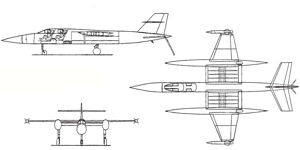

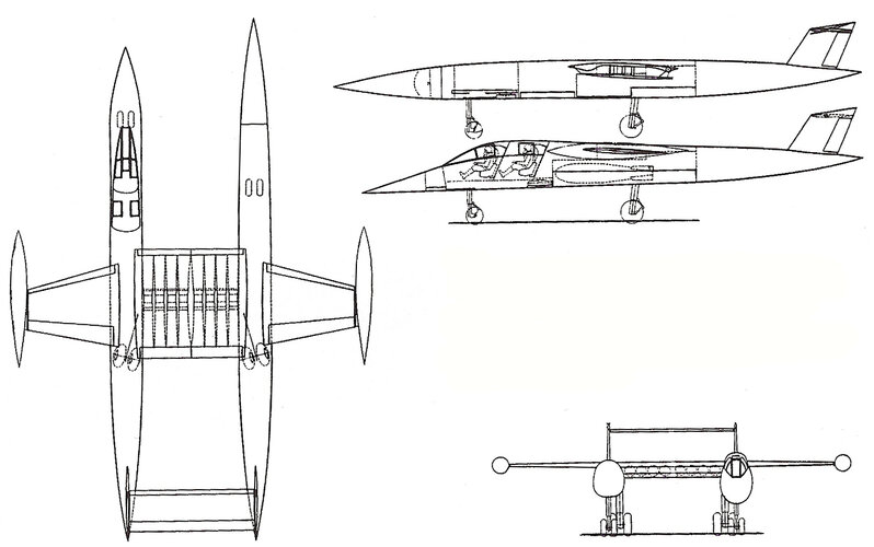

The strange and strangely beautiful Vickers Supermarine Type 582 would qualify as a four-engined fighter if half of them broke down. Dual and single fuselage versions were considered for the Fleet Air Arm as interceptors.

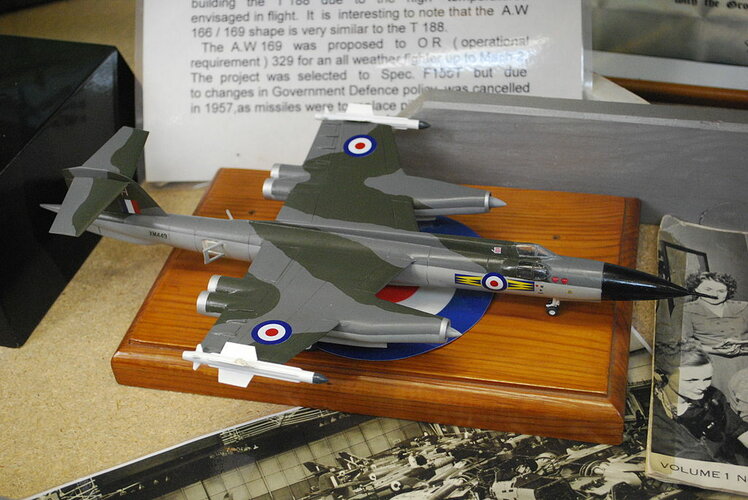

Armstrong Whitworth AW 169. Contender for F.155T/OR.329 interceptor. Some of the other contenders had combined jet and rocket propulsion - the Fairey Delta III had two jets and two rockets while the Saunders-Roe P.187 had two jets and four rockets. AW's though had four jets that were to be used throughout the mission, not just in climb.

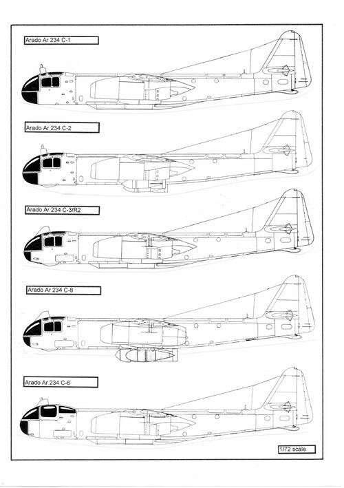

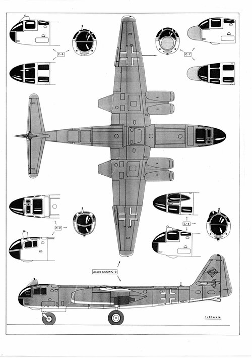

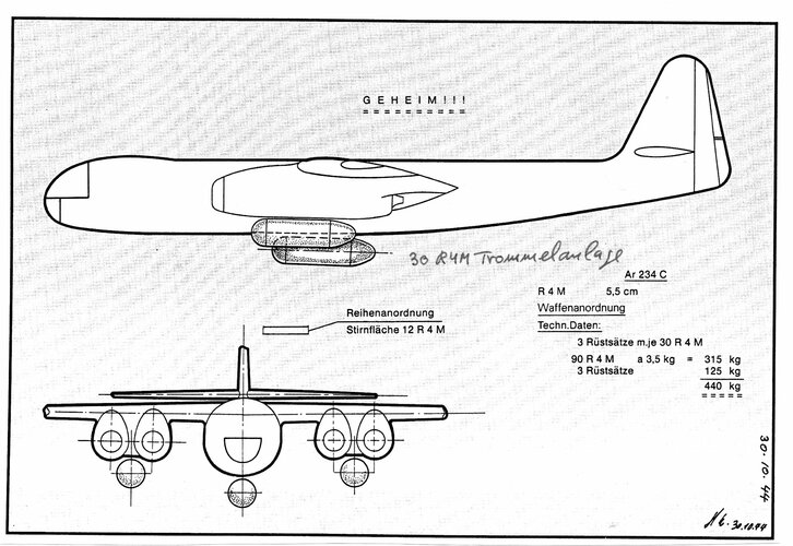

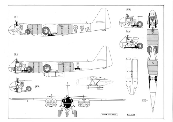

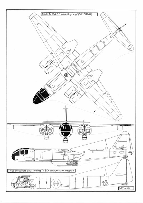

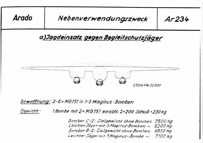

Arado Ar 234 C with air-to-air rockets
That paint scheme reminds us of the Royal Canadian Air Force's "Golden Centenaires" formaiton aerobatic team that toured Canada during 1967. I saw them perform over the lake in the middle of Sherbrooke, Quebec that summer.
The team flew Canadair Tutor jet trainers which were later re-painted for the later "Snowbirds" formation aerobatic team who are still wowing crowds 'til today.
Is...that an Arrow with six engines? It's magnificent.

Ah, but that had only three engines. The second Soar was never fitted, just a dummy cowling.
From Gloster Meteor by Barry Jones, Crowood 1998:
At the end of August 1954, Hucknall's fitters removed the ballasted engine casing from the starboard tip and replaced it with a new, fully working Soar just for the [1954 Farnborough] show. Bad weather restricted flying that year, also the organizers had one 'civil aircraft only' day, so that the actual number of flights made with both engines operating were very few. After the display, on the last day, 12 September, WA982 departed from Farnborough and went back to Hucknall, where both engines were removed for returning to Rolls-Royce for overhauling. When they came back, the new engine which had been installed on the starboard side for Farnborough, was refitted on the port side, ready for flight testing to be resumed. However, no production application for the Soar materialized, so the programme was gradually run down and the last Soar sortie was made on was made on 22 March 1956.
... so a four-engined Meteor flew after all, if only for a short while.
