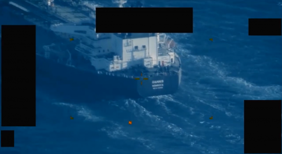

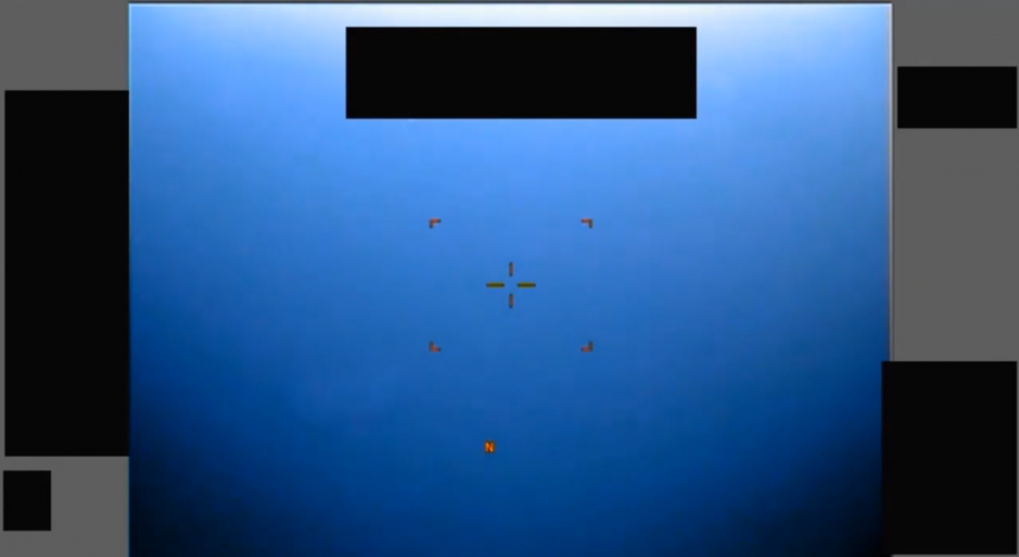

This is just absolutely not true. The MQ-9 does not need to fly low to increase the resolution of the DAS-5.
Well, then we have to accept that drones fly at altitudes of 2-3km in places without overcast just because operators need to show enemies their balls... (speaking of which, while US mostly fights in dry places nowadays, SEA is indeed anything but).
There was plenty of footage of american jets and especially drones at lower altitudes over Iran; we saw it both ways(clear detailed civilian videos from the ground, as well as FLIR footage from attacking drones themselves; no one hides it). Some of that was surely attitude/permissive environment(gun runs), but not all and not most. Plus I remember a lot of Bayraktar footage from medium altitude.
Saving F-15 pilots appears to be a particularly primarily low altitude mission, mostly done just under the envelope of active air defenses of Isfahan area.

How are you gauging this? All on-screen metadata is immediately redacted as it is CUI so where are you getting your information for this claim?
You can reasonably guess altitude from oblique angle and speed of angular movement. It's rather simple geometry after all.
Especially if you watched a lot of similar videos(for example, TB2 ones) before.
And this isn't even full resolution!

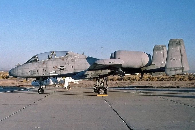

Wes O'Donnell has a video out about the A-10 and a as yet unwon country who wants to buy some retired A-10s, it could be Jordan or it could be Ukraine*:
A mystery country just asked the U.S. if they could buy retired A-10 Warthogs. The Pentagon said no. Then it pointed them toward the OA-1K Skyraider II; which is what you get when somebody looks at an agricultural aircraft, the kind that sprays soybean fields in Iowa, and decides it needs Hellfire missiles and a mission-planning cell. That sounds like a joke. It's also a completely serious aircraft the Air Force is flying right now.​
In this video: what the OA-1K can actually do versus what the A-10 was built for, why the honest conclusion is "close, but not the Warthog," and who the mystery country is, because the evidence points somewhere different than you might think.​

Even Ukraine wouldn’t want those. Just another airframe to maintain but with far less value than an F-16.
At some point the cult of the A-10 just needs to die. Literally every comment section about the A-10 and the plans for its divestment is littered with these nonsense comments about how "The Army will take 'em in a heartbeat once the Air Force parks them", "I hear the Marine Corps plans to put them into service", "Our allies are chomping at the bit to fly them - we need to transfer them to friendly nations".

If you take the gun out the whole plane falls on its tail.
There's a LOT of steel in that gun, the whole gun-and-ammo-hopper combo weighs about 3900lbs.
The gun was stupid from the start, surprising that was ever green lit to begin with. Unfortunately taking it out now doesn't make the aircraft any less obsolete. The best course of action is to retire, scrap and recycle them. Make something useful out of them.
30mm Guns on 1970s ground attack aircraft are more or less built-in rocket pods. They had their role back then - to a certain degree(CSAR/armed escort) to this day.
You can use a gun closer to friendly ground forces than a rocket pod.
The British may disagree.
Aside from the fact that neither solution provides the same effectiveness against any given target as precision guided munitions. Although laser guided rockets have come quite a long way nowadays.
