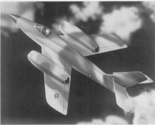

may be the XF-90 delta wing fighter proposal submitted to this competition.

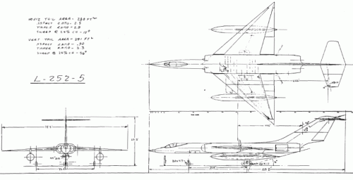

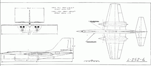

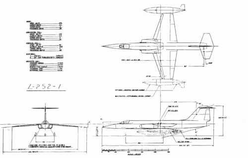

The original tendered configuration of the XF-90 WAS a delta wing. The swept was designed later. The delta XF-90s go under the L-167 TDN but were for the original penetration fighter competition (that won by XF-88). Another TDN covering delta XF-90 derivatives is L-169, but those were pursuit not penetration fighters. The later SAC Fighter GOR (1952-1953), to which the F-101 was selected, saw Lockheed doing a number of studies (mostly computer variations of baseline configurations) under the TDN L-252 (enlarged F-104 with different wingplans). No hint if those were really submtted.
Main points of SAC Fighter GOR: fixed armament/electronic gear weight = 1955 pounds, combat radius = 1566 Nmi, maximum speed = M. 1.75 at 55,000 feet, combat ceiling = over 68,880 feet , maximum take off distance = 5880 feet .
Some of the resulting design were very large indeed.
L-252-1 proposal look like an oversized F-104 Starfighter to me. Also, is it just me, or does the L-252-6 look like it uses turboprops?
