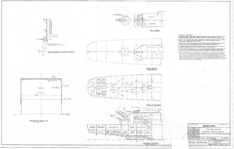

Very little data, since most of those projects did not leave conceptual stage. The only available plans are for SUM-N-2 "Grebe" anti-submarine torpedo-carrying missile installation, planned for "Allen M. Sumner":
Apparently the idea was a trainable launcher with hangar storage in the superstructure directly behind the launcher.

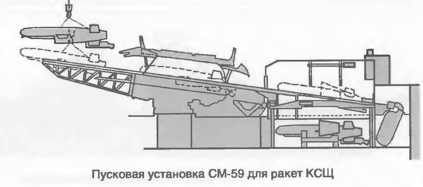

Yes (as well as backward - some Soviet refitted destroyers have rearward-aimed P-15 launchers installed), but it would be generally less accurate and more demanding from the ship. Trainable launcher in 1950s were generally simpler solution, since they allowed precise aiming of the missile into calculated leading point without the need to turn the whole ship.
Erm, no. The Soviet 1950s missiles were mostly launched from trainable launchers. The first missile that was launched from fixed rail was P-15 "Termit" - mostly because it was designed to arm small missile boats, which have no space for trainable launchers.

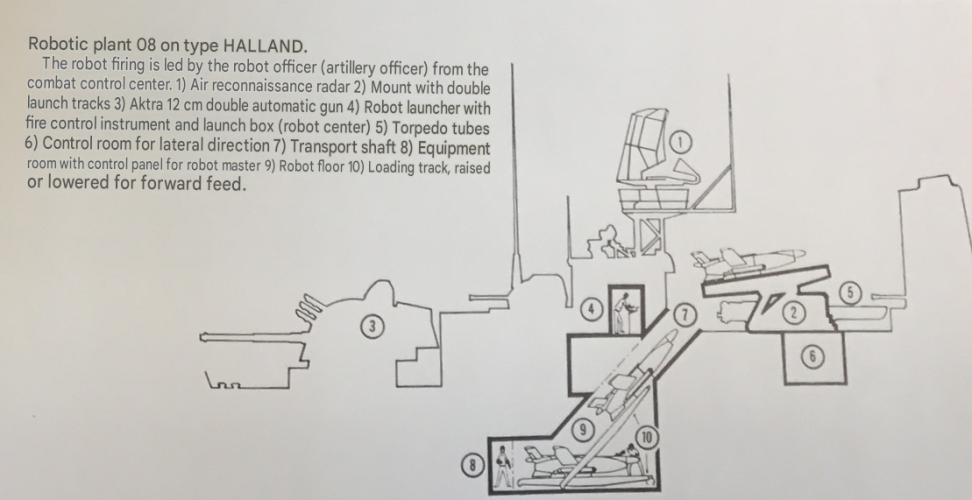

Actually, you could have a hangar for reloads easily. Look:
That's a missile installation for Halland-class destroyer. The missiles were stored in hangar below rear superstructure, and (with the help of inclined ramp and chain rammer) were raised to the deck, where launch rails were set above rear 21-inch torpedo mount.

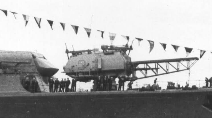

The launcher was massive, stabilized mount, but mainly due to the desire to hold a fully loaded & launch-ready missile inside the launcher "cabin". The spare missiles were stored in magazine placed in ship's superstructure:
(the missiles were placed in two rows, in three vertical tires, with an elevator platform moving between them. The upper section was the launch preparation room, where missiles were fueled (they were stored un-fueled), and prepared to be sent on launcher. Usually the launch preparation room also store one missile. The launcher hold one fully combat-ready missile - with wings unfolded - inside the armored cabin.
