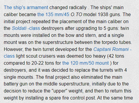

I have quite a bit of information on this design but a couple sources imply that early on there was consideration of using at least one twin turret for the 135mm guns. Can anyone verify if this was true and, if so, what was the intended arrangement of the guns?
Thanks,
Dave G
Never read anything about this. Anyway, the twin 135 turret exist: is that of the Capitani Romani class.
