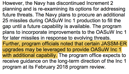

Cross-posting from JASSM-XR:
Lot 18 JASSM sources sought mentions 40 JASSM-D missiles.
https://www.fbo.gov/index.php?s=opportunity&mode=form&id=ededbd9a7f9308da4fadaa052b7fcb73&tab=core&_cview=0
A Lockheed jobs posting had:
"Responsible for capture and successful execution of JASSM development programs, to include new
Wings and cross program missile control unit (MCU). Successful execution of these technology
upgrades is critical to the fielding of the next variant of JASSM (D Variant) and LRASM.
My emphasis but consistent with the inference from GAO's remarks upthread.

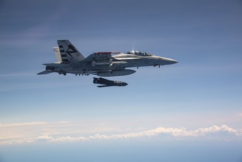

The air-launched, precision-guided missile program is working toward EOC on the Navy's F/A-18 in September 2019 as well. Meanwhile, the Air Force is assessing what is required to fly LRASM on the B-52 and will later create a certification schedule.
https://insidedefense.com/daily-news/long-range-anti-ship-missile-reaches-eoc-b-1-after-slight-delay
The Air Force's B-52 appears to be another candidate to carry LRASM, after Congress appropriated an additional $10 million in the FY-19 defense spending bill to certify the missile on the 1960s-era bombers.
In an interview Wednesday, Air Force Weapons Program Executive Officer Brig. Gen. Anthony Genatempo said he anticipates the B-52 certification will happen in the next two years. But he indicated too much happening at once could slow LRASM certification.
The B-52 faces a slew of updates that will allow it to fly into the 2050s, including an active electronically scanned array radar modernization program to boost maritime strike capabilities, an effort to replace the aircraft's engines and the addition of other weapons like hypersonic missiles.
The Air Force needs to keep enough B-52s available for operations while also leaving enough test assets for the upgrades to move forward.
“The issue that we're seeing overall is that there are a lot of capability upgrades, not only to the B-52 but to systems that we're looking to use the B-52 as the major conveyance, and they're all starting to come together in the [2019] and [2020] time frame,” Genatempo said. “There are lots of activities going on with a very limited B-52 test fleet and we're working very closely with [Air Force] Global Strike Command to work through that.”
Dougherty said the military is still looking at requirements for adding LRASM to the B-52 and will create a certification schedule once that assessment is finished.
In the meantime, the Navy is continuing to study the capabilities it may need for a future missile under OASuW Increment 2. The service's original plans for that program were deferred in its FY-18 budget request, and it will continue procuring the baseline LRASM to shore up capabilities until a new weapon is available, according to a Government Accountability Office report published in April.
Congress approved $111 million for the Navy to buy 35 LRASMs in FY-19, 10 more than the service requested. The Air Force also received $54.4 million to purchase 15 missiles, three more than projected.
The Navy plus-up grows the program to 118 missiles through FY-21 for nearly $390 million. The Air Force is finishing its three-year procurement in FY-19, totaling 49 units for about $170 million. Each LRASM costs about $3 million.

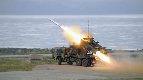

LRASM to be integrated on a USMC vessel (9:30 mark)
https://www.youtube.com/watch?v=7bWk2wOWvTk
TomS
Apr 16, 2008
4,417
1,390
The quote is "one of the Marine Corps' mobile vehicles." I'd guess HIMARS, whihc has been mentioned as a possible antiship launcher before.
sferrin
Jun 3, 2011
13,574
1,598

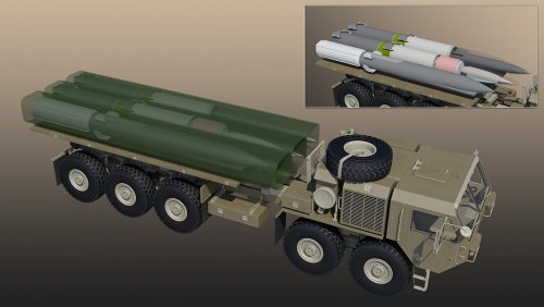

HIMARS would be too small for LRASM with a booster. I posted a video here, somewhere, where they've launched NSMs from a HIMETT
https://www.youtube.com/watch?v=qsUZekFToQU
That would be big enough to do the trick.
TomS
Apr 16, 2008
4,417
1,390
Yeah, that might be necessary given how long LRASM is with the Mk114 booster. I think NSM would fit in a HIMARS (maybe even two-across) but I'd have to check dimensions.
Strictly speaking, that's a PLS, not a HEMTT (five axles vs four) but same idea. Probably would be an LVSR for the Marines, but also very similar.
Something like this:

marauder2048
"I should really just relax"
Nov 19, 2013
3,149
446
My emphasis and consistent with the inference from GAO's remarks upthread.

sferrin said:
Clear as mud. ???
Just GAO saying upgrades developed and paid for under the JASSM-ER program may be incorporated onto LRASM if they are appplicable. Marauder's pointing out that the LockMart job listing affirms this by indicating work on -D will be applied to LRASM.

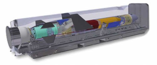

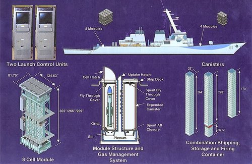

They need to get larger cells than the Mk41 then (and not limit themselves to a couple modules on the Virginia fleet).
TomS
Apr 16, 2008
4,417
1,390

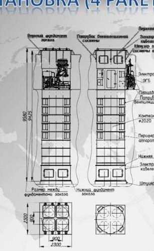

Is strike length Mk.41 smaller than UKSK?
The overall module is -- Strike-length Mk41 is just under 7.7m deep while UKSK is around 9.6m. And the UKSK module footprint bigger too -- 2.3m x 4.6m for 8 cells while Mk41 is about 2m x 3m. But I'm not sure what the internal canister sizes are, since UKSK has an odd cylindrical bit below decks that seems like it would limit module size.
