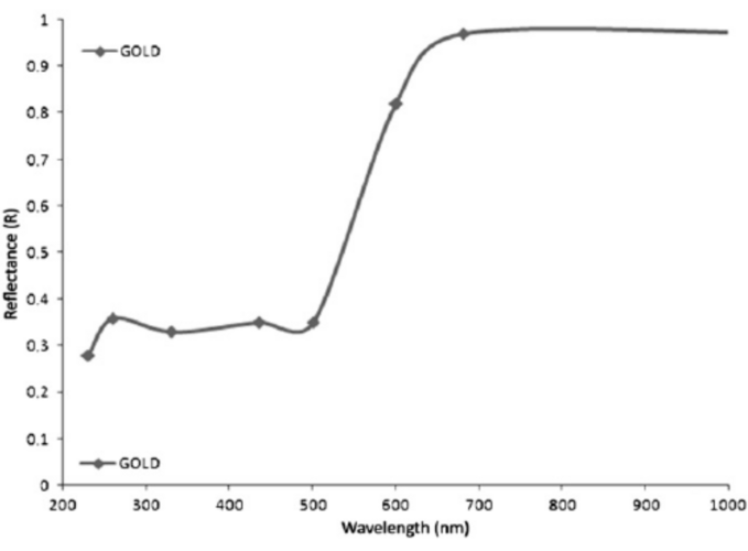

5. Al isn't that great a reflector. And after converting to gaseous phase after absorbing 30% of the remaining radiation (still of the order of tens of MW) it will be a very poor reflector indeed.
Case in point, lasers are used for machining Al. It's only a problem at longer wavelengths.
