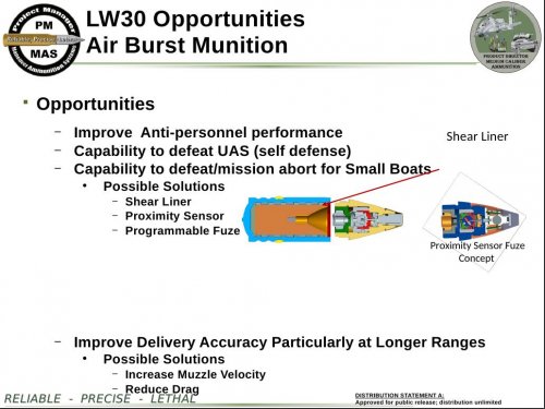

A couple of efforts (well documented at NDIA's Fuze and Armaments conferences) :
* Fuze modification to prevent over-penetration into soft surfaces (sand/soil) prior to detonation.
* Improved fragmentation effects: bigger and higher velocity fragments.
* Proximity sensor to enable HOB fuzing which in turn permits penetration through cover then detonation.
To put the challenges in perspective: even the lower velocity rounds fired from M230 experience 100,000 Gs
cluttonfred said:
Interesting. It is my understanding that the HEDP ammo used in the M230 is quite effective in an anti-personnel role. I seem to remember something about a 3m lethal radius, which seems about perfect for the kind of strafing near friendly troops we are discusssing? Care to elaborate?
The risk estimate distance for the Apache 30mm is 70m at 500m. I believe the "lethal" radius is 5m or more.
From a January 27th, 2016 presentation

cluttonfred said:
The GAU-8 is overkill for anything less the the Soviet tank-busting mission it was designed for. If, and I'll believe it when I see it, we see a next-generation close support aircraft to succeed the A-10, I suspect the emphasis will be sensors and precision munitions. I certainly hope they also keep a gun, but it would not need to be as powerful as the GAU-8. The logical choice in terms of standardization would be a version of the 25 x 137mm GAU-12 Equalizer from the Harrier II and the Spooky gunship or the lighter GAU-22/A from the F-35 using the same ammunition as the Army's M242 Bushmaster. Anything too heavily armored to engage with the gun would get a precision-guided missile.
I would argue the opposite. For air to ground 25x127mm/30x173mm is not big enough and is used as a compromise to impact on a non-purpose designed platform. A bigger shell in the 35-37-40mm class provides lower dispersion increasing accuracy. This enables stand off shooting with far less rounds and a smaller safety templete (ie closer danger close). Also with modern rounds a bigger shell provides a lot more potential for airbursting rounds and anti-structure. Plus of course the "old" armour penetration. Which since new generation tanks are being built with thicker roof armour and active protection systems requires more gunpower to enable target defeat. The gunship medium gun weapon was changed from 40mm Bofors to 30mm Bushmaster to leverage the new airbursting ammunition without a development spend (it was an in-service weapon) even though it decreases their standoff capability. A much better Gunship option would be the 35mm Bushmaster, 40mm Super Shot or the 40mm CTA gun. Tacair requires a faster firing gun for use from a high speed platform but there are options in these types of calibres available.
