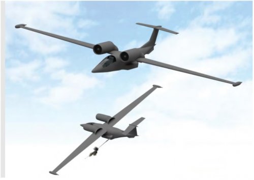

A Light & Heavy Attack Craft if we had a decent procurement culture.
_Del_
I really should change my personal text... Or not.
Jan 4, 2012
649
436
I imagine with USB, you could manage a much smaller wing. Which would definitely help ride quality down low, service life, lower drag, higher speed, etc
If you just want a medium-/high-altitude loiter platform, you're not asking for anything a UAV wouldn't be as good or better at.
what conceptual design is that? i don't think i've ever seen it. Seems like the product of an individual and not a company.
Err...ride quality is indeed affected by wing area (or more precisely wingloading), but also by lift curve slope (CLalpha). Wings with high aspect ratio have steep CLalpha, which is why terrain following aircraft the likes of a Tornado, TSR.2, and F-111 have lots of wing sweep and high wingloading.
Using the A-10 and Frogfoot as the yardstick for a reasonable compromise between low-speed agility and wing weight, that wing likely has more aspect ratio than necessary. I could see something like that as a medium altitude lotering platform though.

AeroFranz said:
Thread deleted ..you claimed to have read and called a poor presentation. Obviously a College kid is not a corporate presentation.
https://www.aiaa.org/2017-2018-Undergraduate-Individual-Aircraft-Design-Competition/
Third Prize: Pedro Toledo of the University of Kansas, Lawrence, Kansas, for his design “A-X Overseer.” Dr. R. Barrett-Gonzalez, faculty advisor.
AeroFranz
May 4, 2008
2,335
284
Ok, thank you for providing the reference! I did read the first place winner... the one written by an air Force cadet or something along those lines.
The one that uses high-bypass ratio commercial turbofans mounted in an unlikely installation in the rear fuselage among other things...
Yeah, since that piece of work was the first place winner, frankly I did not feel compelled to give the third place a try...
I don't want to bash the work of students, the AIAA competition is a great exercise for people who want to get in the conceptual design business. But there's a lot of flawed stuff in there that wouldn't survive a semi-serious design review in industry. It's certainly true for some of the reports i submitted in the early- to mid-2000s when i was participating in these competitions.
