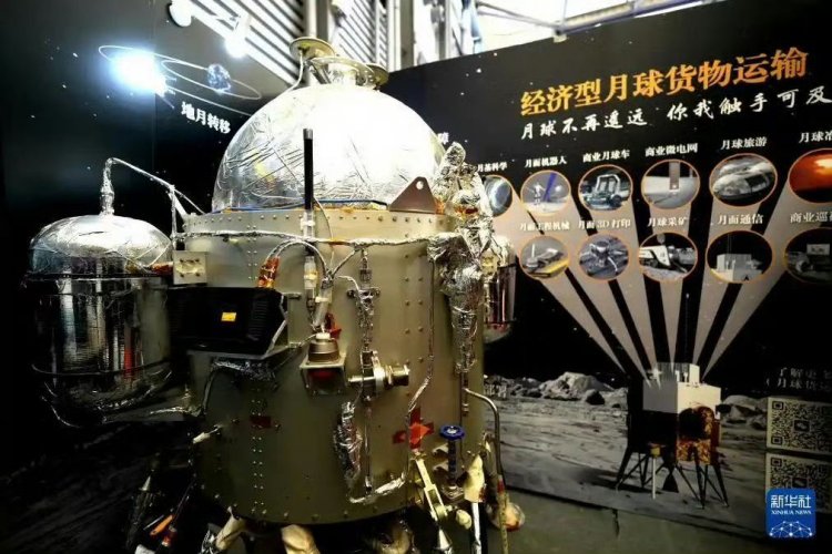

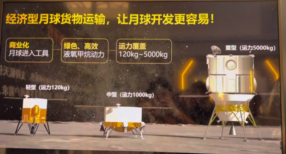

China is developing low-cost lunar cargo options for its expanding moon program​

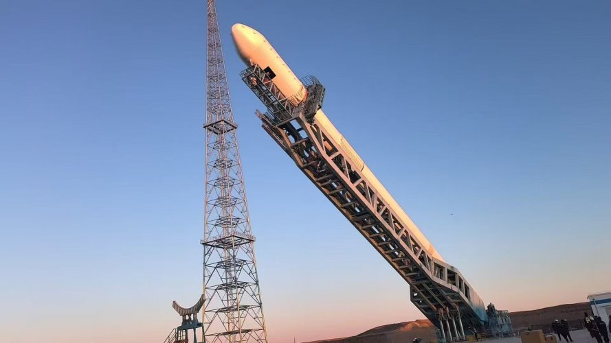

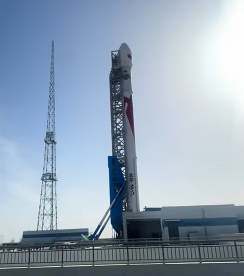

Space Pioneer attempted the inaugural (intentional) launch of their Tianlong 3 earlier today at 04:17 UTC from their LC-120B pad at Jiuquan. The launch failed, there were a couple propulsion anomaies at t+33-46s, but the launcher continued probably until MECO, then there reportedly was a separation or S2 ignition failure.
Launch footage:
View: https://x.com/raz_liu/status/2039927917686477035
This was a demonstration launch aiming to SSO, carrying only an optical earth observation micro-satellite. The failure came 21 months after their static fire failure in June 2024.
(specs of Tianlong 3, very similar to Falcon 9: https://www.spacepioneer.cc/en/tianlong/TL3)
At 12:17 PM on April 3, 2026, our company's "TW-4·Xiyou" satellite, launched aboard the Tianlong-3 (Y1) carrier rocket from the Dongfeng Commercial Aerospace Innovation Test Zone, experienced an anomaly during flight, resulting in a launch failure and the satellite failing to reach its intended orbit.
We deeply regret this launch failure. This satellite is an important scientific research satellite jointly developed by our company and Xi'an University of Posts and Telecommunications, embodying the long-term R&D efforts and technological investment of both teams. It carries the mission and expectation of promoting the intelligent and precise development of remote sensing technology through university-enterprise cooperation. While the launch failure is heartbreaking, space exploration is inherently full of risks and challenges, and every attempt is a step towards technological accumulation and growth.
Setbacks are the crucible for progress. Tianwei Technology will always maintain a deep respect for the aerospace industry, adhere to its original aspirations, summarize experiences, and forge ahead. We will continue to cultivate the fields of satellite development and aerospace information applications, advancing subsequent satellite development and launch missions with a more rigorous attitude and more solid technology, living up to the trust and expectations of all sectors.
This was on Tianlong 3 Y1, and was lost with the launcher.

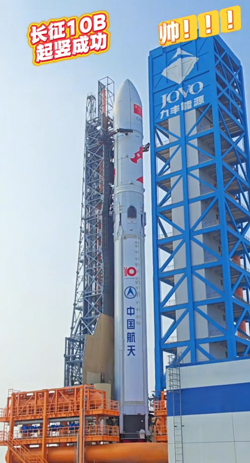

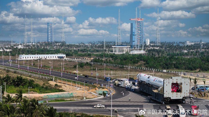

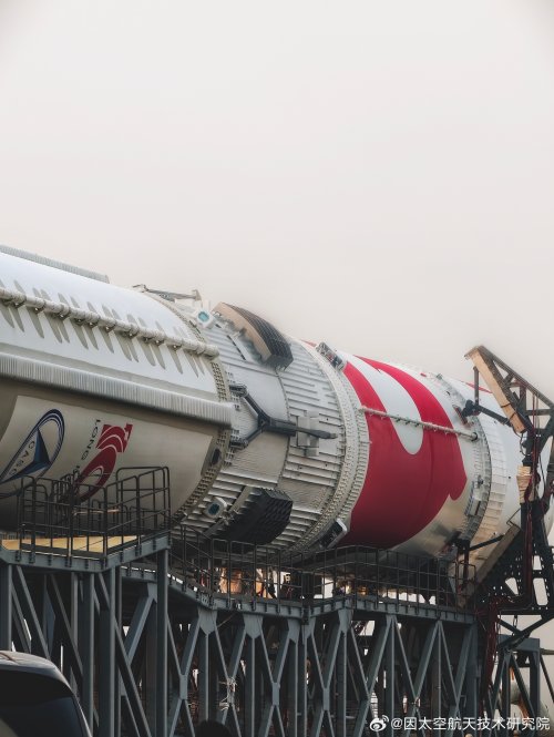

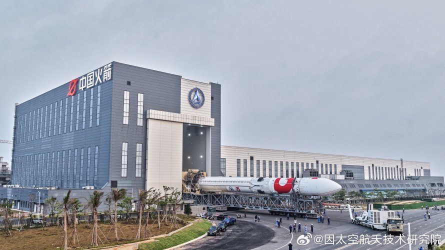

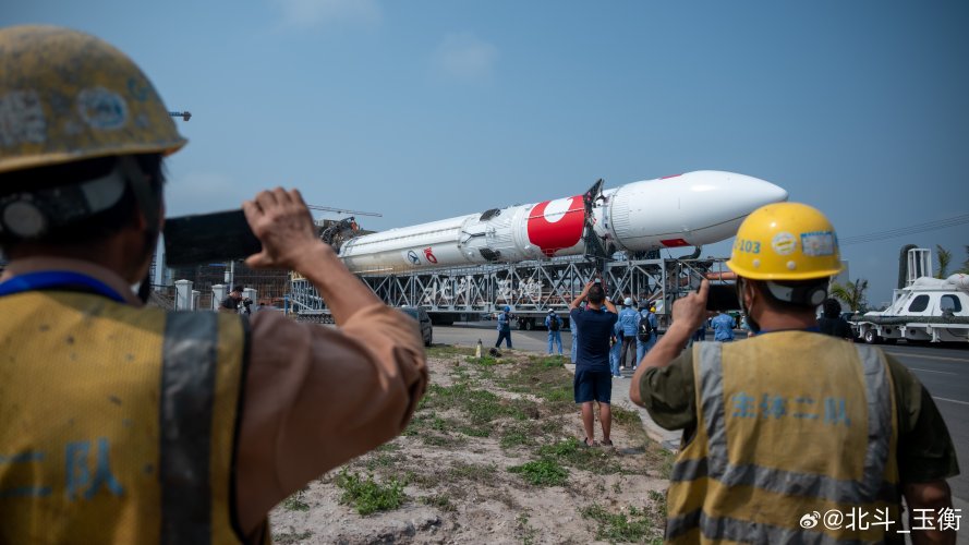

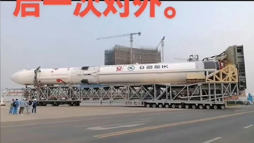

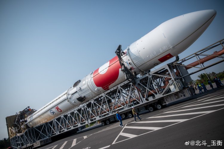

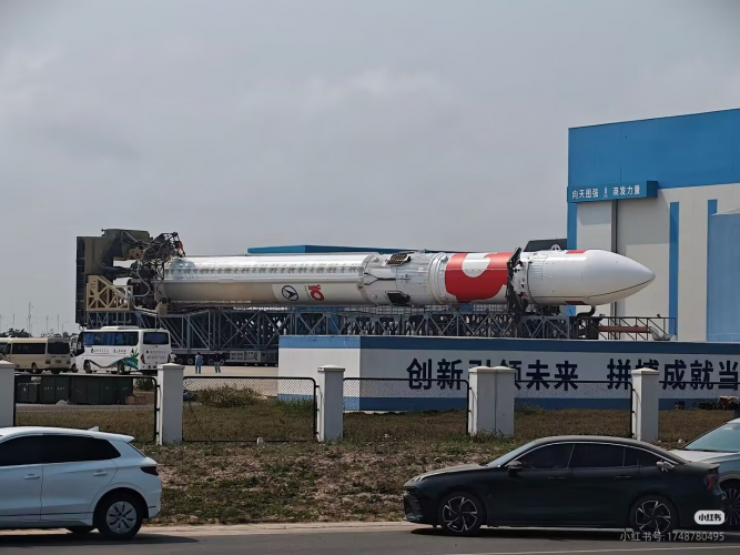

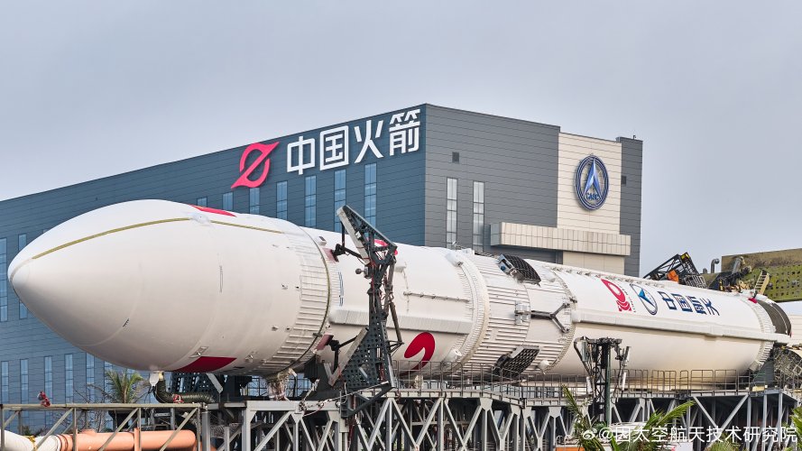

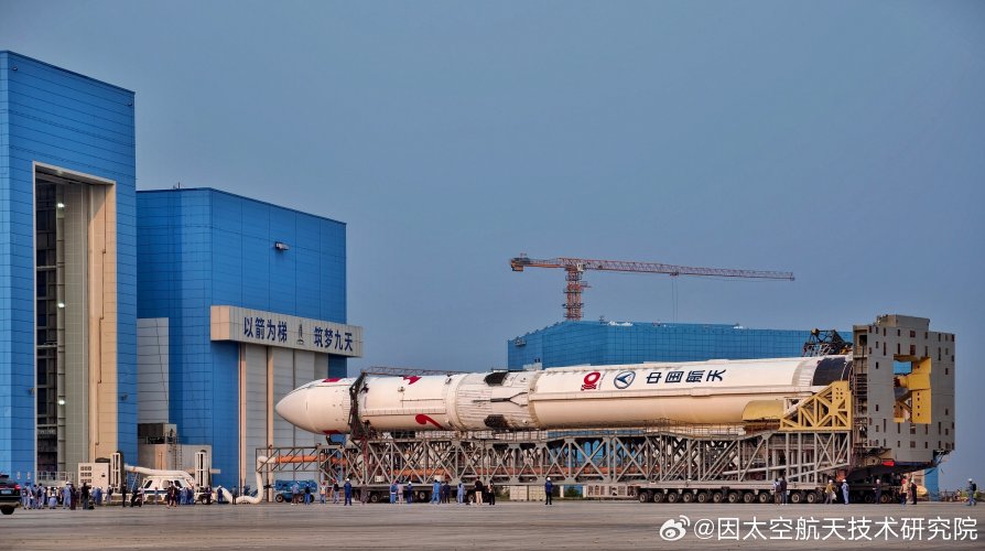

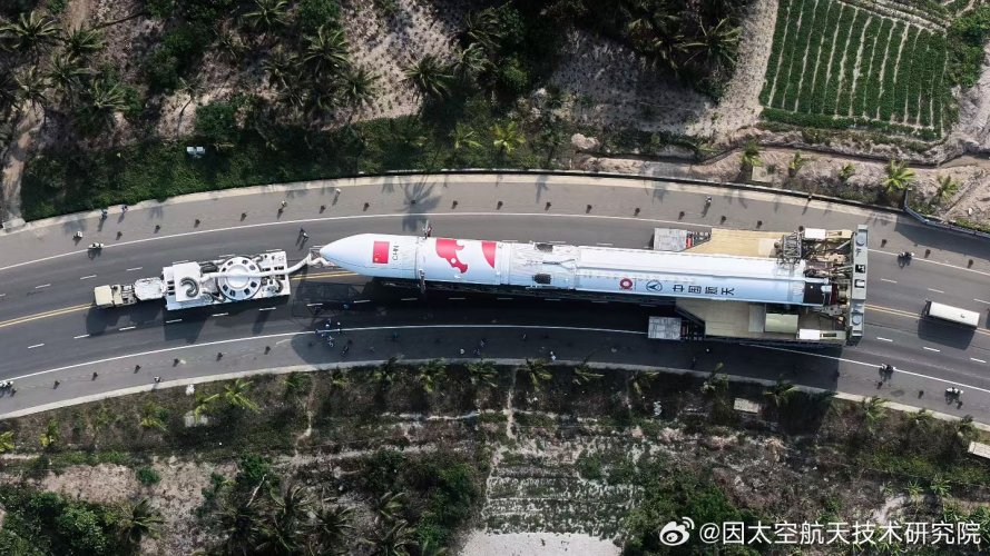

CZ-10B. If all goes well, it will launch by the end of this month.
From Weibo 因太空航天技术研究院 & 北斗_玉衡
?They belong to different developers
10B - China Academy of Launch Vehicle Technology
12A - Shanghai Academy of Spaceflight Technology
12B - China Aerospace Science and Technology Corporation Commercial Rocket Co
Okay. Weird that they wouldn't just change 12B to a different number.
Is it racist to say that all those rockets either look like one another or like SpaceX clones? If so, please, mods swoop in for old man cleanup...
If you're a latecomer developing a single-core, VTVL, first-stage reusable rocket, you'll more or less repeat what American developers have done. The Chinese do it, the Russians do it, and so do the Europeans.
They do differ from SpaceX’s rocket — assuming you mean the Falcon 9. Take the Long March 10B for example: its diameter is larger than the Falcon 9’s. The propulsion is also different. Both first stages are kerosene-powered, but the Long March 10B uses a closed-cycle(Staged combustion cycle) engine instead of the open-cycle with Falcon 9. Its second stage is methane-powered, unlike the Falcon 9’s kerosene. The recovery method is different too — it doesn’t have landing legs like the Falcon 9.
Europe's launch count is 47% of Russia's, 8.6% of China's, and 4% of the US's. And you're from Germany, right? China's launch count is 9,300% of Germany's. As for success rates...0(German)/90(China)=0%.
If you're going to be racist, snide, or sarcastic, you'd better have some kind of "superior" ground to stand on. In spaceflight, you Europeans are hardly a master race. Don't get all smug just because your skin is as white as the Americans'. That’s America’s achievement, not Europe’s.
Go ahead and clone the Falcon 9. Maybe you Europeans can trade some ADVANCED bottle cap technology for a bit of rocket technology from Musk?
Why? Rocket Lab's Neutron is different. Stoke Space's Nova is different. Blue Origin is different. Sure, Relativity Space's is pretty close but it's also, probably, going to be far more capable than Falcon 9. (Assuming they can finagle logistics and support as well as SpaceX.)
