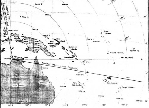

but there another alternative for near equator launch site under British controll
Darwin, Australia
it was under ELDO a short time proposal to build there a ELDO Space Center
but France had already had build it Guiana Space Centre in French Guiana
and so Australia quits ELDO
picture one show Darwin and Launch trajectories
Picture two show Woomera and its Launch trajectories
source
http://www.spaceuk.org

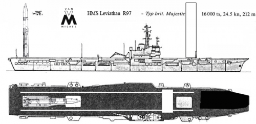

i look in Wikipedia and Found the perfect candidate for Blue Streak Sealaunch
HMS Leviathan , Aircraft carrier of Majestic Class.
she was never completed
http://en.wikipedia.org/wiki/HMS_Leviathan_(R97)
http://www.battleships-cruisers.co.uk/majestic_class.htm
http://www.fleetairarmarchive.net/ships/LEVIATHAN.html
easy to modified for Rocket launch
and as option to search&recover the Manned/spysat capsule after splashdown
spysat ?
its perfect reason to go on with British Spaceprogram including a Manned one
here in full glory HMS Leviathan with Blue Streak with Lox/lh2 stage (and french L-17 booster)
(in same scale)
instresting is that the Aircraftlift are 12 x 10 meter right size for the Upperstage
however the Blue Streak + booster has to stay on flight deck
but one problem is the service tower with high of 40 meter (the big rectangle right)
would it be better, if that one can lies down on flightdeck ?
(in same scale)
are you planning to use the forward arircraft lift to redirect the exhaust gases .. ?
if so - to where? straight down through the entire ship? or sideways out to both sides of the ship?
side ways, would look like this

America tried sea launching Jupiter missiles. Not a great success.
Several snags.
How do you assemble the vehicle?
Vessel pitching and rolling too much;
Where does rocket exhaust go?
What would happen with a pad explosion?
