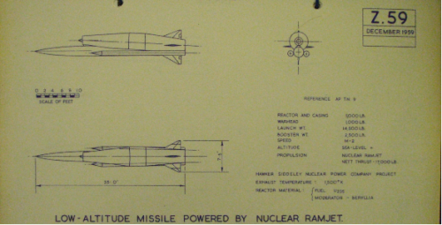

I have bought the new Avro Z-59 (or W-59) missile kit from S&M models in 1/72 scale;
I would like to know if more infos are available on this project as the only infos I have come from the excellent book "Vulcan's Hammer". I mean a small drawing and a picture showing the machine in flight.
Came across this the other day: the Brits looked at the nuclear ramjet idea as well, under the designation Avro Z-59. It's been mentioned once or twice on this site and in Chris Gibson's book Vulcan's Hammer: V-Force Projects and Weapons Since 1945, and a one-line mention in the June 2016 issue of Space Chronicle. Would have apparently mated the front end of a Blue Steel missile to a PLUTO-type ramjet. I'm not entirely clear on whether it would've used a single nuke or several with a SLAM dispenser system, but if it was based on Blue Steel I'd assume a single Green Bamboo/Red Snow megaton-class warhead (Red Snow being a variant of the W28 discussed further up re: the SLAM). This art is, I believe, from the book.
