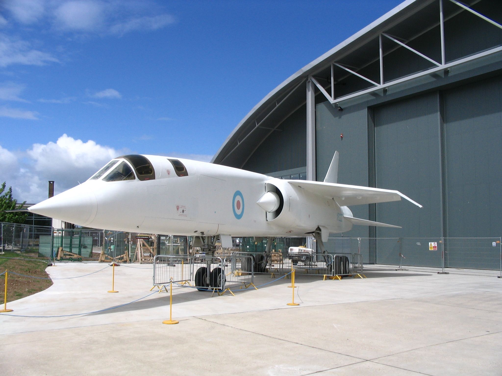

Duncan places the operational 730 in 1964. In the real world 1964, TSR.2 was flying around in 'low viz scheme' (antiflash markings, as Thorvic notes), as were Vulcans, Victors and Valiants. Duncan: nice!
<nice TSR.2 attachment>
This isn't the Duxford TSR.2 photo with the F-111 next to it, is it?
If you have a large version of that photo I'd love to have a copy
I didn't upload anything, just linked to a picture from wikimedia: http://upload.wikimedia.org/wikipedia/commons/f/f5/BAC_TSR-2_at_Duxford.jpg
Back in 1992 I visited Duxford and was astonished to see a TSR-2 sitting pretty on the tarmac. Hard to forget, so when Stéphane nudged me into contemplating antiflash markings, the TSR-2 leapt to mind. I think Duncan's choice for the 730's colour scheme is appropriate - and it looks good.
Because I have small children and must suffer through Disney's Cars (in which the planes are likewise somewhat anthropomorphised), the very idea of the TSR.2 and the F-111 standing next to each other creates images in my head of the TSR.2 being perpetually rather... annoyed at its stablemate. Every scene would start with the TSR.2 saying "If it weren't for you and your low price tag..."
