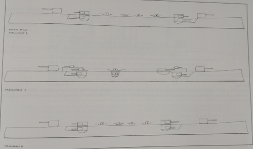

"Between 1908 and 1909* Argentina received from the British shipyards: 67 designs of battleships and 77 designs of destroyers". o_O
*We should interpret, also, that it is between the years 1907 and 1910.
Source: Destéfani, Laurio. “Historia Marítima Argentina. Tomo IX”. Page 133.
I will try to get you diagrams of them, but I doubt that these are preserved in Argentina.
On the other hand, between 1924 and 1925, Argentina received 27 cruiser offers, 27 destroyer offers and 24 submarine offers from shipyards in Spain, United States, France, Great Britain, Italy, Japan and Sweden.
Montenegro, G. "El Armamentismo Naval Argentino". Page 121.
I will also try to get you these diagrams.

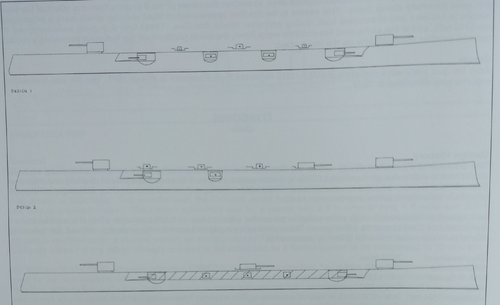

Mr. Tzoli,
I've got some drawings from the National Maritme Museum that are indicated as projected cruisers for south american customers at the end of the 1890s.
I'm not sure but one of them could be of the Design 35, offered for Argentina in 1900. The information available in the NMM is not clear about this.
The Design 35 is registred as a protected cruiser with 8600 tons, 350ft (lenght), 65ft (beam), 24ft (draught), four 9,2in (twins), twelve 7.5in (single), fourteen 14pdr QF, with Belleville boilers (13,500 SHP - 20 kts).
Friedman indicates this design as a Vickers' project.
This is all I have about this design.
Maybe Mr. Coldown could find more information about this project.
I hope these information could help.
