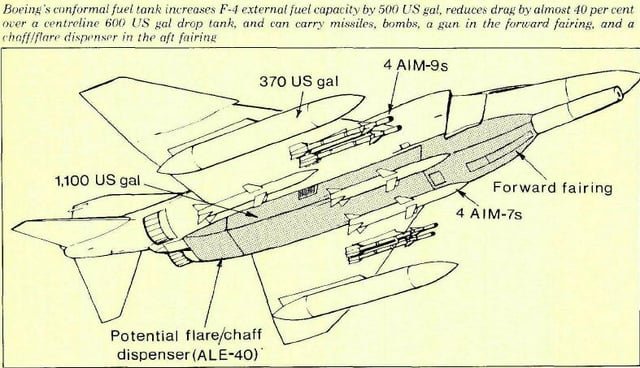

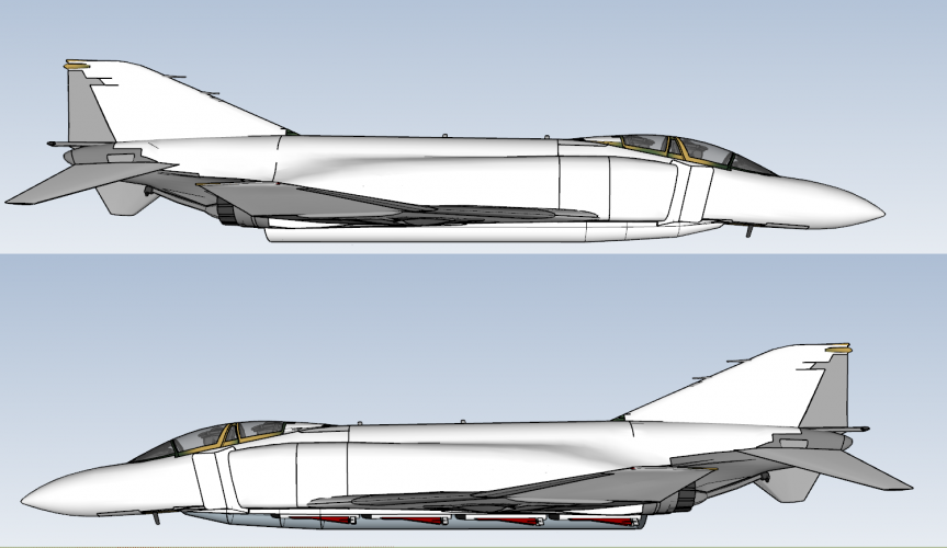

Still I think a belly weapon bay, shaped like proposed conformal fuel tanks for Super Phantom, would be possible:
After all, four Falcons in two pairs (one after another) require just about 5 meters of length and 0,5 meters of width/heigth to store.

It'd have to be scabbed on like that, there's no space in the belly of a Phantom for a weapons bay.

But if you showed them that the belly tray would make the plane faster than with having everything out in the breeze, I bet they'd buy a "belly tray bay plus FCS upgrade" over just an FCS upgrade.
Okay, so my idea that seemingly might to work: one long, semi-recessed conformal weapon bay installed between engines roughly at the place of centerline fuel tank.
Two sections, one after another. Each designed to accomodate either two AIM-4 missiles (one after another) or one AIM-26 missile on trapeze launchers.

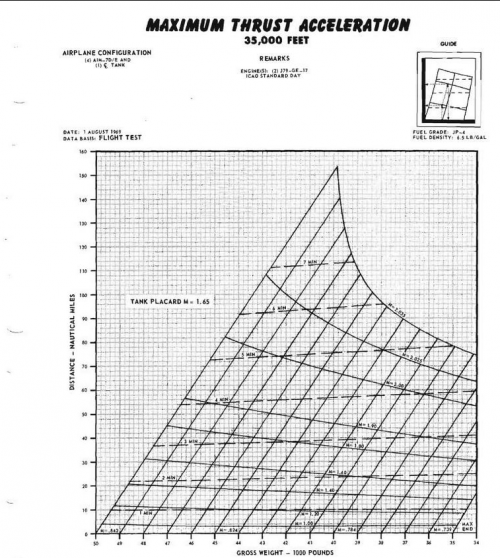

According to the charts I was able to find, the 600-gallon CL tank & four AIM-7 arrangemend allowed F-4E to reach Mach 2+ velocity (the tank could withstand only about 1.65 Mach, though). So as long as summary drag coefficient from ventral weapon bay would NOT exceed the summary drag of abovementioned payload, the F-4E would be fine.

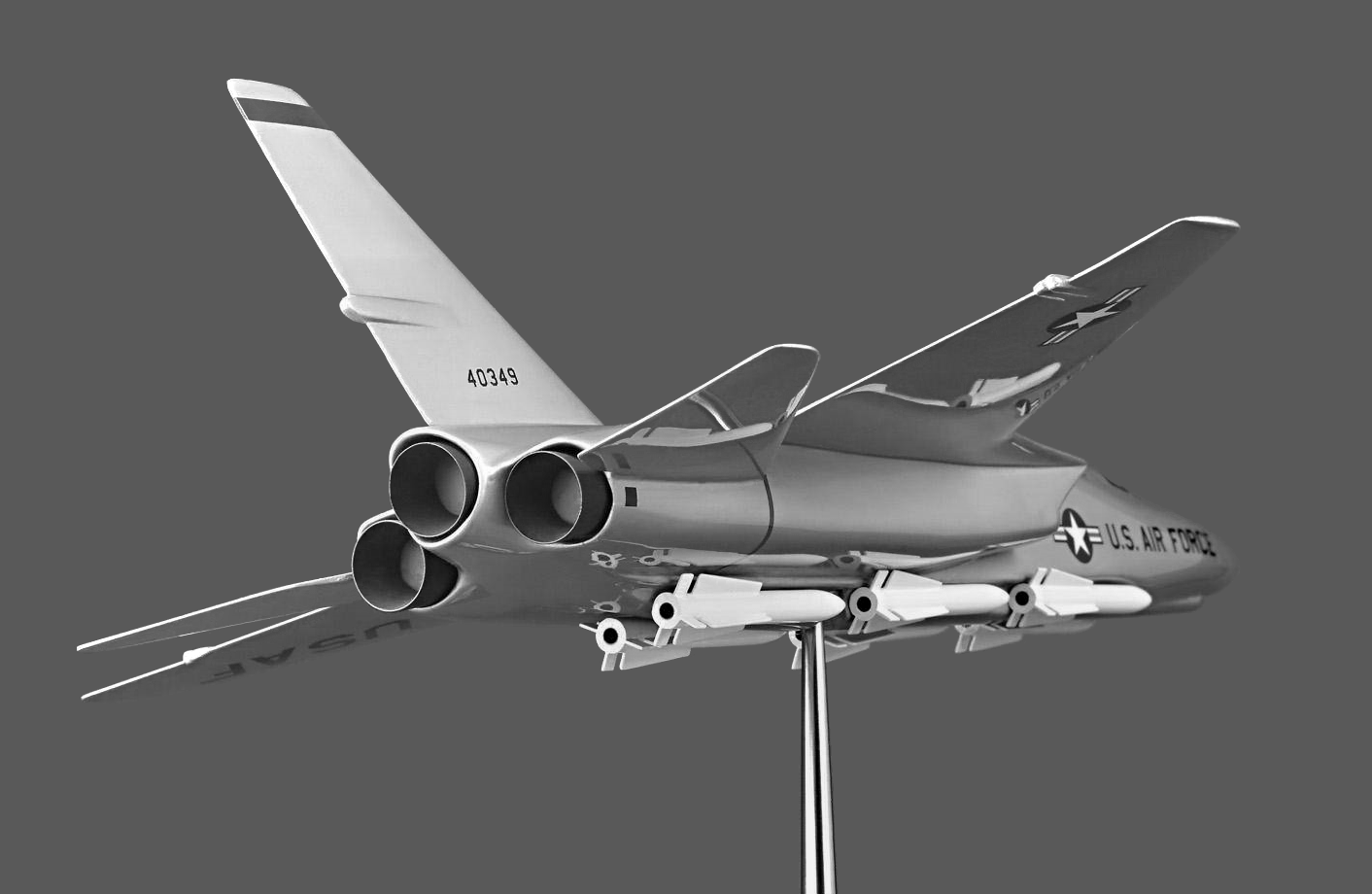

However this is what the NA A-5 interceptor looked like:

Too much drag. You're basically installing an under-fuselage pannier because the space immediately above the belly is taken up by other things. Unlike prop planes, there's very little empty space inside a modern jet. By the time you rearrange that space to fit a truly internal weapon bay, you might as well make a new airplane because it's going to make the F-4K look like a line-squadron hangar modification by comparison.
IIRC MDC proposed a belly conformal fuel tank that would do a decent job in 1981.
So it would work pretty well. Might not end up with full enclosures, but it would end up pretty well.
Well, I checked the graphs -
- and the drag from 600-gallon CL tank & four AIM-7 did not prevent F-4E from reaching Mach 2+. Arguably the belly weapon bay in semi-recessed blister would give less drag.
