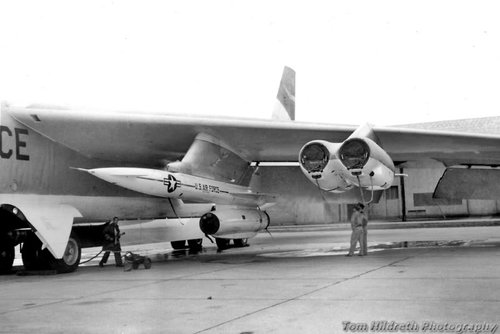

No way would an Arrow be able to carry a Hound Dog.
The V bombers were unable to carry Hound Dog since the ground clearance on the bombers was totally inadequate.
The B52 was a high wing aircraft.
That might be true of the Handley Page Victor but it was not true of the Vulcan. The Vulcan had a massive amount of ground clearance compared to the B-52.
Between the fuselage and the ground yes, but between the bottom of the wing and the ground? That's the critical part.
Is approximately 12 feet under the wing sufficient? It was approximately 8 feet under the fuselage
You have to take into consideration that AGM-28 was specific in that the pylon was part of the weapon system, a complex structure because it transferred the thrust loads to the B-52 wing and full of equipment and plumbing because the missile's tanks were connected with the aircraft's tanks. The pylon was not part of the B-52 structure. The missiles were removed from aircraft with the pylon attached and shipped the same for IRAN to Tinker AFB. Also the front part of the pylon had to be clear from any aircraft structure above it and to have a good field of vision upwards because it contained a Kollsman Instruments star-tracker (on top) to update the missile's NAA Autonetics N5G INS prior to launch.
Both are relatively minor problems which I don't doubt that the British aircraft industry could have surmounted. Yes, the pylons would have been different. Yes, they would have attached in a different location, neither however would have produced insurmountable problems. It the will is there, there is always a way.

Problem is ground clearance. Hound Dog is a very big missile, most of 10ft tall. Though as long as the wing is at least 10ft off the ground the missile only hangs about 7ft below the pylon.
It's also over 10,000lbs, so the Arrows and Mirage IVs will likely struggle to haul one just from weight.
TSR2s would also struggle to carry any. Not enough space under the belly, and now you're talking trying to carry 10,000lbs under the wings.
Remember, you're really talking about launching a supersonic A4 at someone.

When launched from a B-52 and then flying low altitude, it had a range of only 400 miles. It had only a 700 mile range for a high altitude mission. So launching from ground is not going to have much range.
Hound Dog could climb to high altitude.
Navajo was canceled in 1958, Hound Dog, even if ground launched, was the way forward.
If you want a ground launched Hound Dog, you're better off with the Navajo. Hound Dog is markedly inferior based on the same design evolution for a ground launch profile.

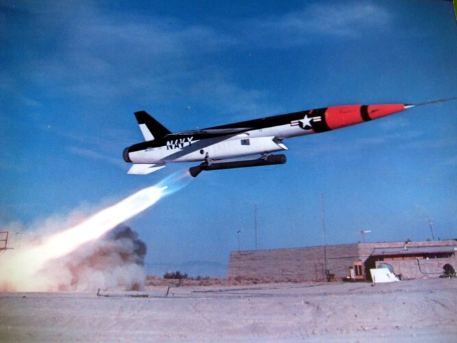

It's called "Regulus 2"
Hound Dog was created out of Navaho residual, cheap-and-dirty, by North American Aviation. It was essentially a scaled-down, turbojet-powered and B-52 launched, G-26 Navaho.
Navaho (not NavaJo !) had a big rocket booster to launch it to Mach 3 and fly intercontinental range.
By the way: always had a soft spot for Regulus II.
There are so many cruise missiles, by an large, between 1945 and 1960 it is easy to get lost.

Good point, that would be a far better ground launched cruise missile than trying to ground launch a Navaho.
The NavaHo (For Archie) was designed to be ground launched...
The reason Regulus II got the axe was the same reason as Navaho. A) costs, B) the existence of ICBMs/IRBMs/SLBMs either operational or in the pipleline to do the same job better over greater distances with next to no interception risk.
