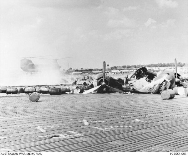

Even the RAAF has Airfield Construction units in the Cold War. 5th Airfield Construction Squadron was very busy in the Cold War, building the 13,000' runway and base at Darwin, 9,000' runway and base at Tindal (far enough inland to be immune from Cyclones) as well as RAAF facilities in Malaysia, Thailand and South Vietnam. RAAF aircraft were attacked destroyed on the ground in Vietnam, this is where even simple oil drums full of dirt are handy.
To bring this back to VTOL, the alternative was to build HAS at NATO airbases from 1968 and the USAF undertook a progamme to arrange companion airfields in Europe, to double those it could operate from.
