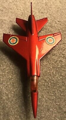

This old Matchbox toy Mirage F1 has the look of a 60s Hawker Supersonic about it..

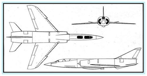

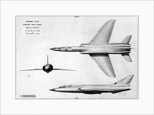

I agree with the above. Another possibile basis might have been the later 1129. Make it single engined and single seater.
