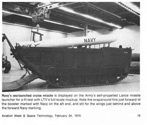

Huh, I was expecting a naval ABL on a trailer, not this version...
Could have sworn we had a thread that specifically talks about the GLCM TEL but I can't find it.
I thought the shape would be to clear road tunnels in Germany but the launch control center vehicles look to be somewhat higher profile that the TEL itself. Possibly a square 2x2 tube arrangement like ABL would end up being even taller and run into roadability issues? (Obviously the new Mk 70 is even bigger, but it may not require quite the same road/tunnel compatibility.)
Perhaps centre of gravity concerns? Or ease of camouflage?
