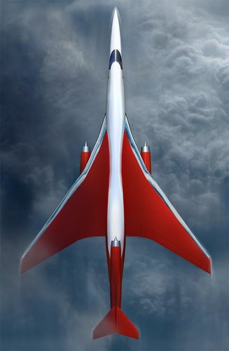

Just for look factor, its much nicer with that wing.
Funny in the article they call it a "delta wing" , when its a swept wing to me. Or look a bit like an arrow wing like there was many Boeing studies of, less swept though.

Well my. I have to admit, those are nice lines.
(Taken from their website)
Are the nacelles narrower now? For me it looks so.
According to the article, yes:
Unlike the previous design, in which the engines were shown enclosed behind relatively thick-lipped subsonic--type inlets, the AS2 now features axisymmetric spiked, external compression inlets. “I won’t say a lot about what we do with that inlet, but it meets all of the really tough requirements for inlet distortion for engines that try to be all things to all speed regimes,” says Vice. The spike, which shocks the flow down to subsonic speeds for inlet recovery, forms part of what Vice describes as a “quite sophisticated inlet.”

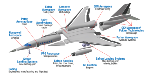

A few additional images from Av Week..... Mark
