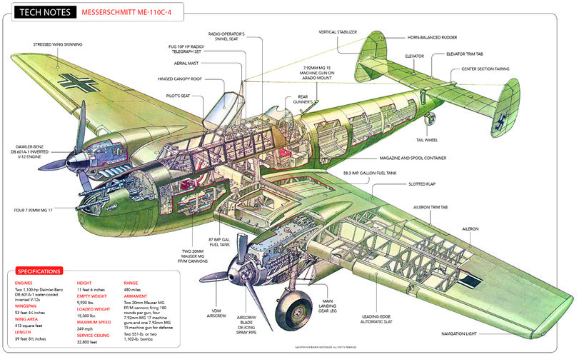

Please show me were exactly the BF 110 stored its fuel in the fuselage and why no charging system could have been integrated inside.

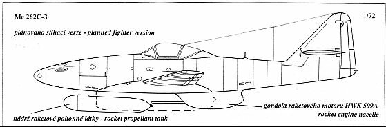

Technically the XP-58 Chain Lightning was a four-engined! fighter. Your best bet for a three engine fight could be a P-38 derivative with a third pusher engine behind the cockpit, or sticking another engine into the XP-54 Swoose Goose.

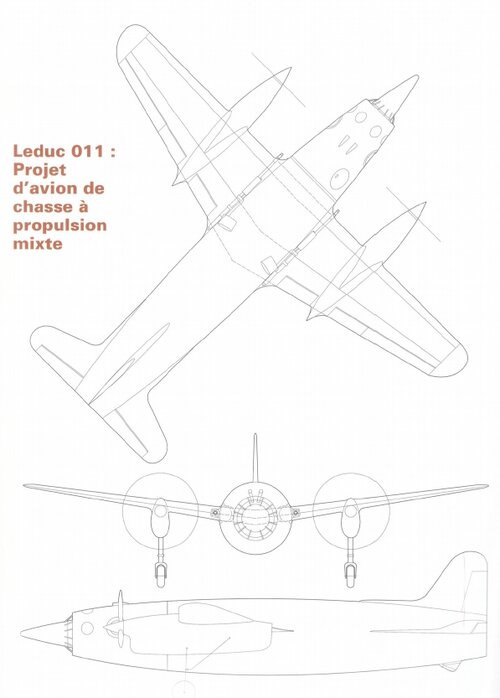

I know, it's just a trick, as are piston engined types with additional jet or rocket engines, or twin
engined fighters with the third engine driving the supercharger, but ... the Leduc 011, proposed in 1939.
Maybe comparable to a conventional twin engined type, with an additional engine, driving a pusher prop
for achieving low fuel consumption/longer range.
(from "Rene Leduc-Pionier De La Propulsion A Reaction", Jean Lacroze, Philippe Ricco)

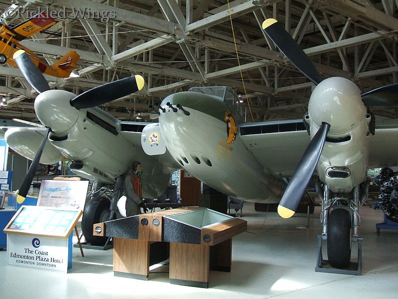

The Mosquito could have been a suitable candidate, here the superfluous bomb bay for fighter applications could have been used to install a third charging engine plus charging system, thus increasing the power output of the existing engines without increasing the mechanical and thermal loads. The high altitude capabilities could have been increased significantly. Despite that, there wasn’t really a need to do so, it already could intercept any propeller driven German bomber but even with a third engine, it wouldn’t have been able to intercept jet planes.
High-altitude Mosquito PR.32 and PR.34 had 1,690hp RR Merlin 113/114 engines, RR's mechanical superchargers were up to the job the Soviet ATsN was designed for. To RR, the ATsN was a solution looking for a problem.
The USSR developed the mechanically supercharged Mikulin AM-35 used by the high-altitude Pe-8 and MiG-3.
Taking the power load for the supercharging away from the main engines, would still have improved the performance significantly. The variable drive which is enabled by an extra charging engine makes it also more efficient.
If there would have been a demand for an ultra high flying and even faster Mosquito, this would have been a suitable approach with relative litte development effort.
The Sabre wasn't equiped with a charging system for high altitudes, a third engine for charging would have made a nice combination with it....
As I mentioned before:
"(...) but even with a third engine, it wouldn’t have been able to intercept jet planes"
