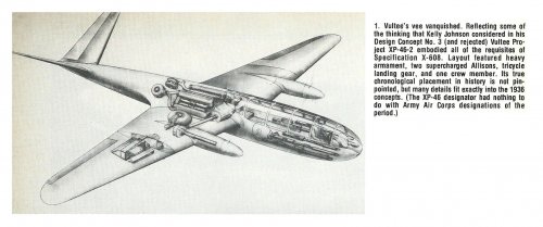

From an old issue of Airpower/Wings: Vultee's XP-46-2 (inside designation for eXperimental pursuit - Vultee Model 46 - second variant), a competitor of the Lockheed P-38 (let the mods move it to the X-608 thread if they see it fit).
